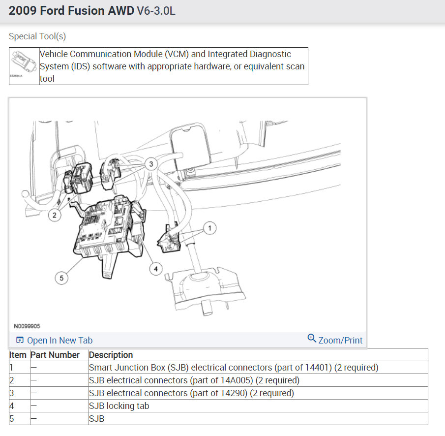

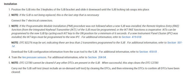

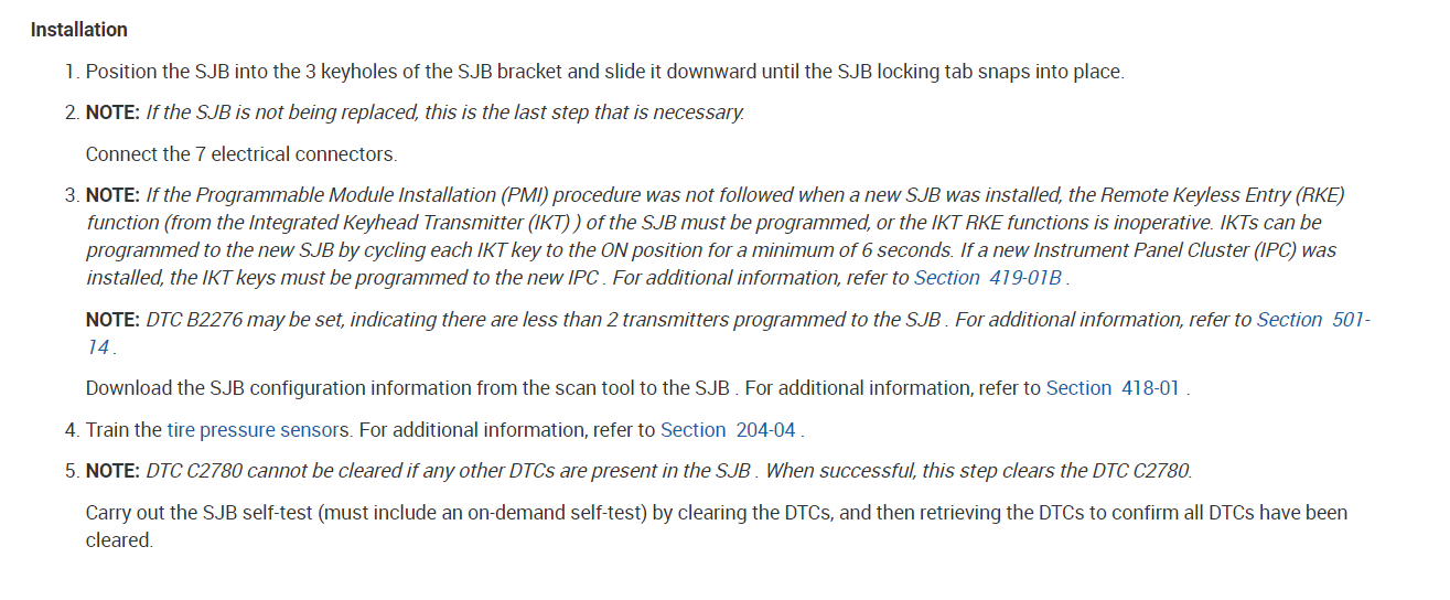

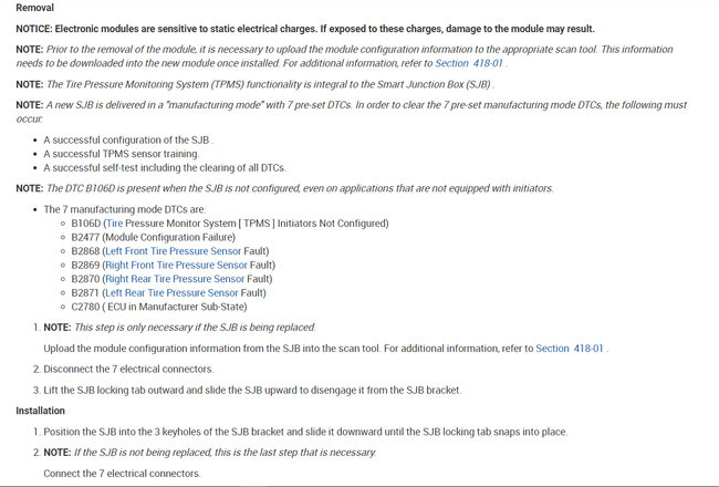

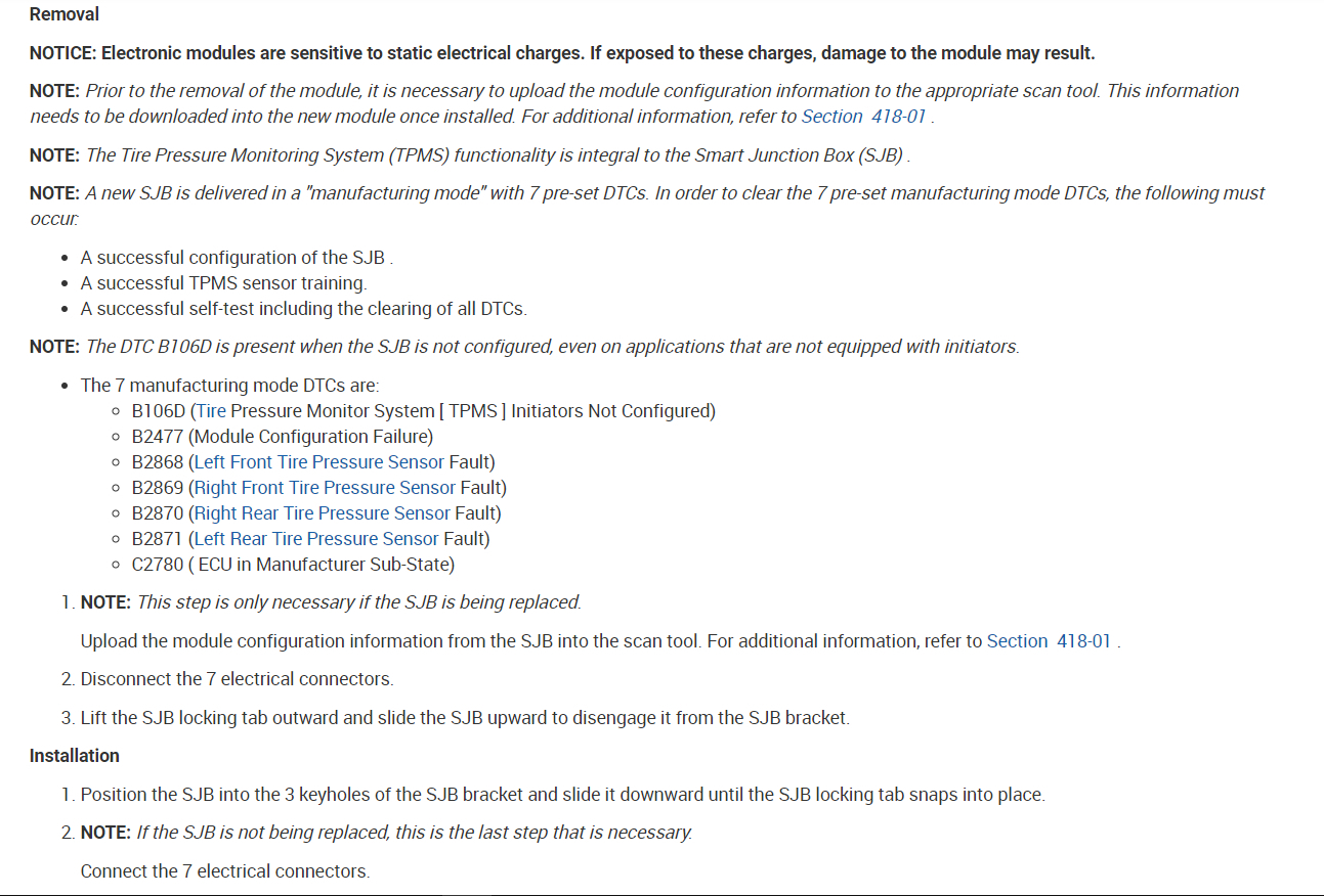

This is common when the smart junction box needs to be replaced. (SJB) here are instructions on how to do so in the diagrams below. Check out the diagrams (below). Let us know what happens and please upload pictures or videos of the problem.
