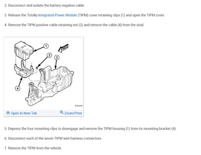

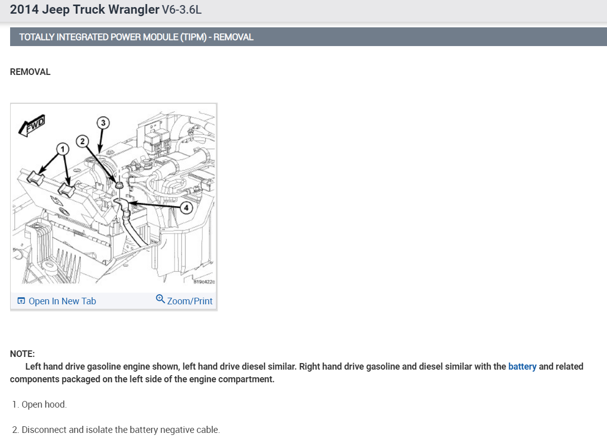

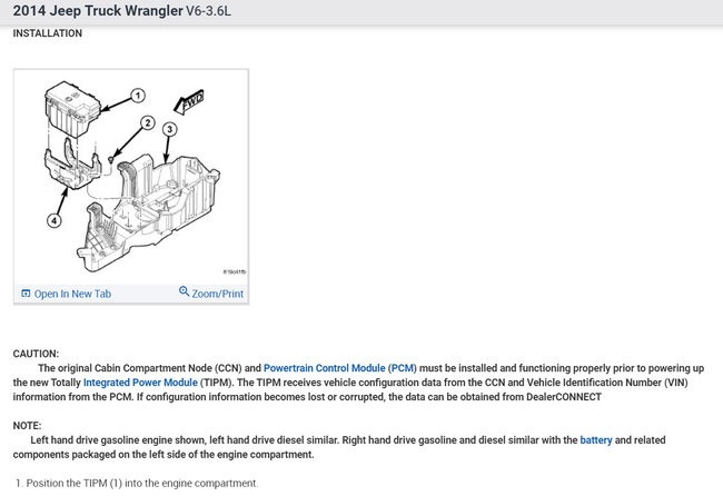

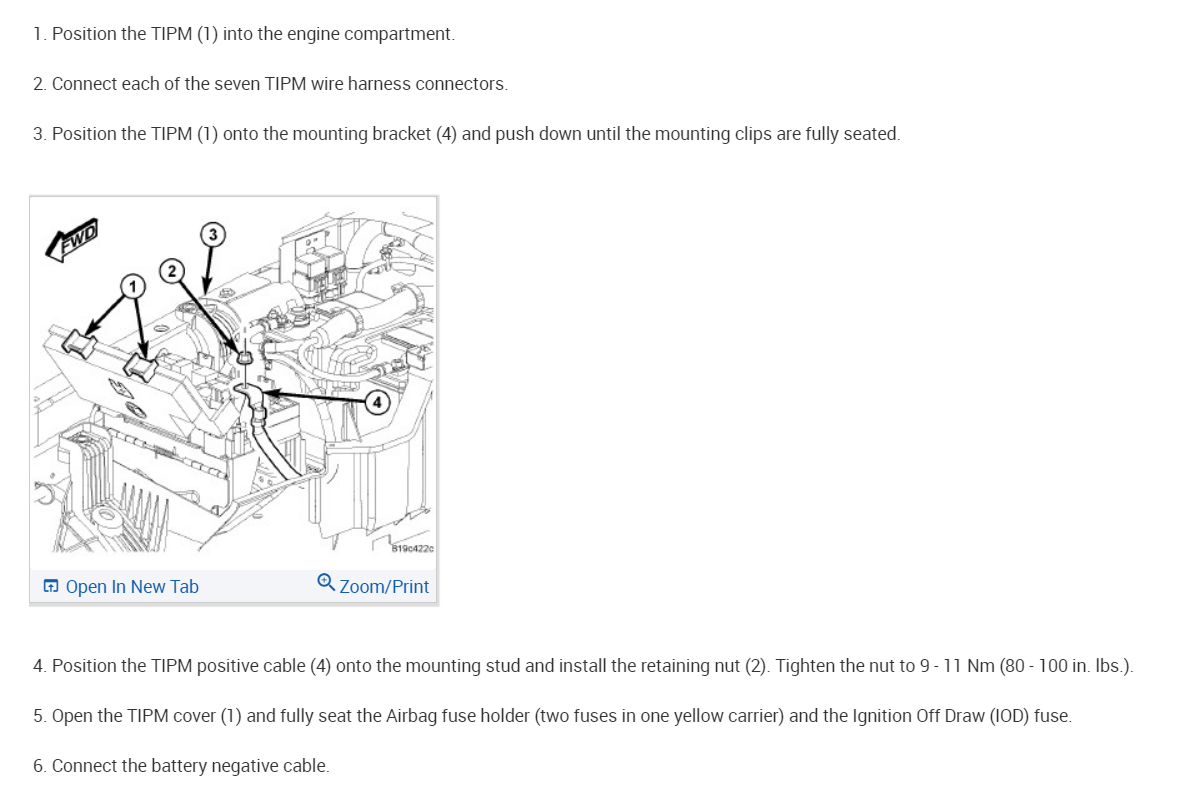

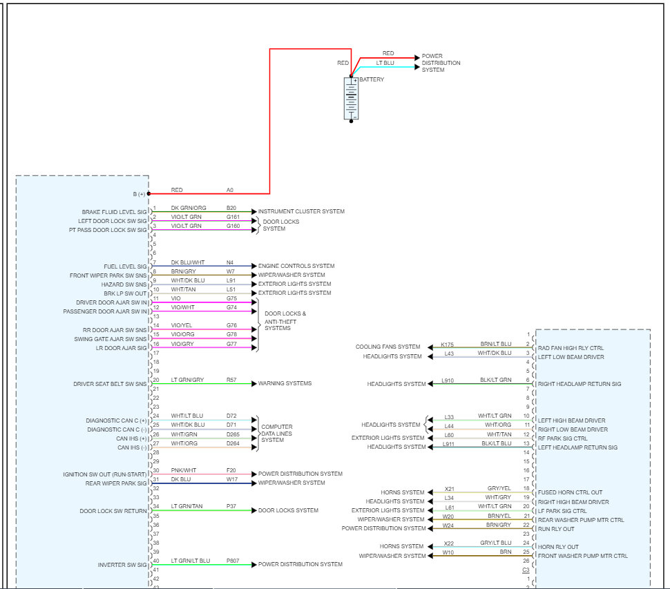

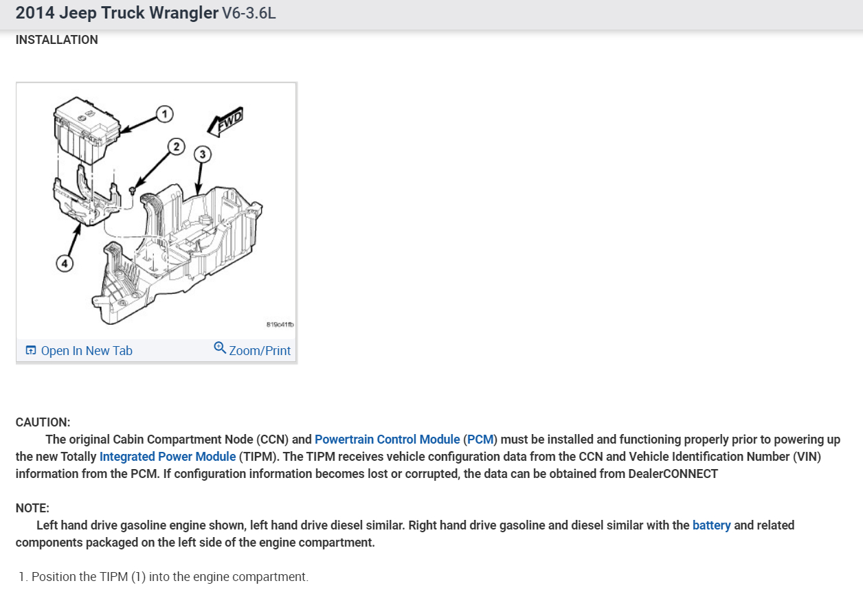

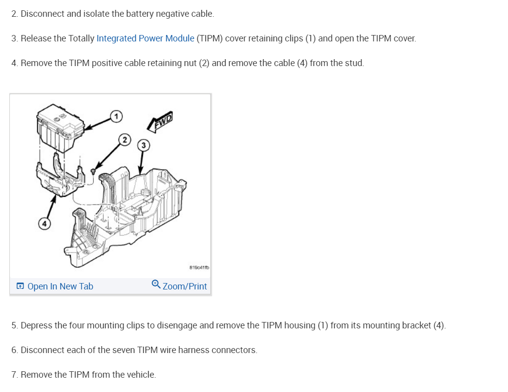

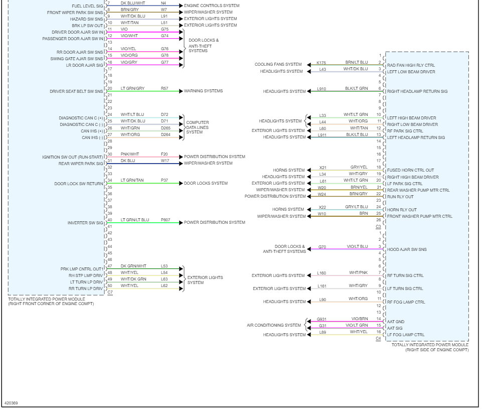

It sounds like the TIPM module is out which a CAN scan can confirm which is common on these cars. It is easy to replace because it-self learns, and no programming is required. Here is the location and how to change it out in case you need it. Check out the images (below). Please let us know if you need anything else to get the problem fixed.

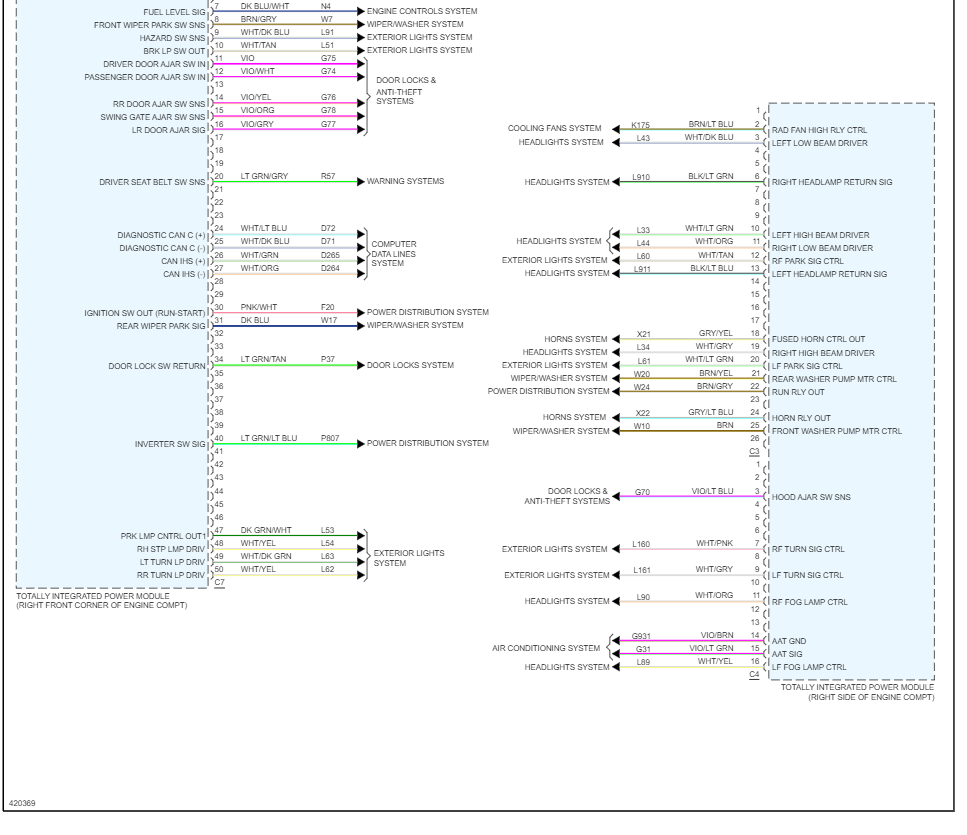

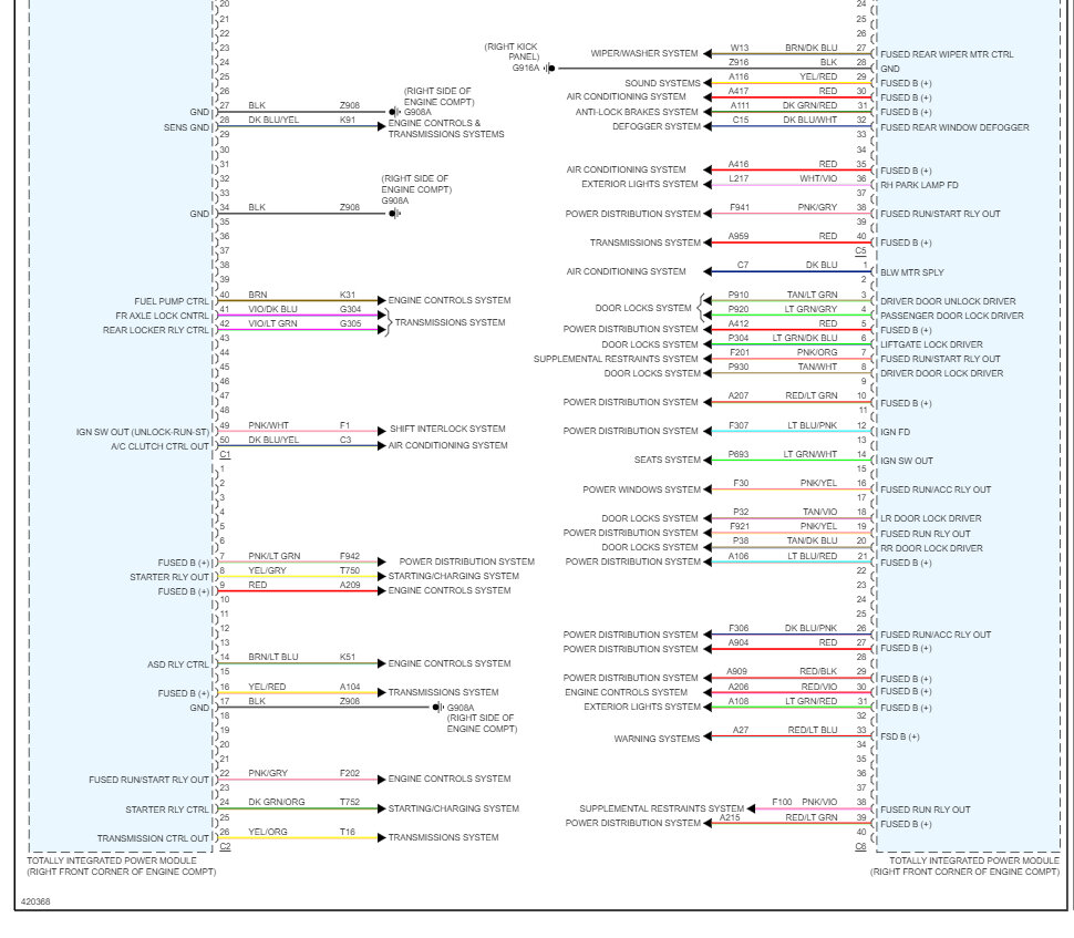

Yep, I like your style, I do believe the TIPM is out looking at the codes that are begin outputted. Unfortunately testing the TIPM is difficult especially when the problem is intermittent. I can tell you they had big problem with the TIPM, and they go out frequently.

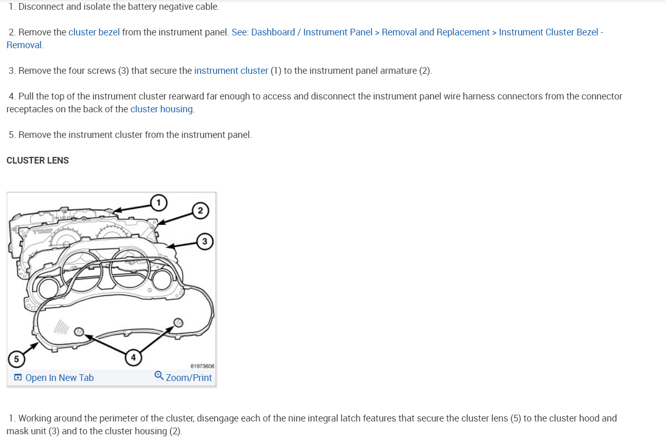

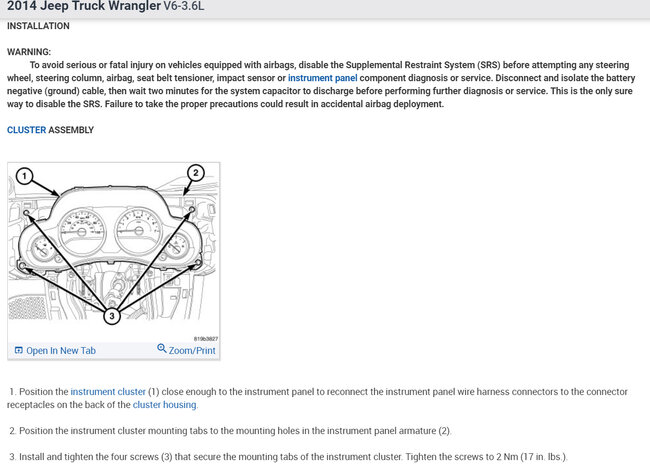

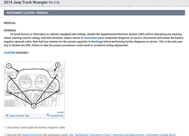

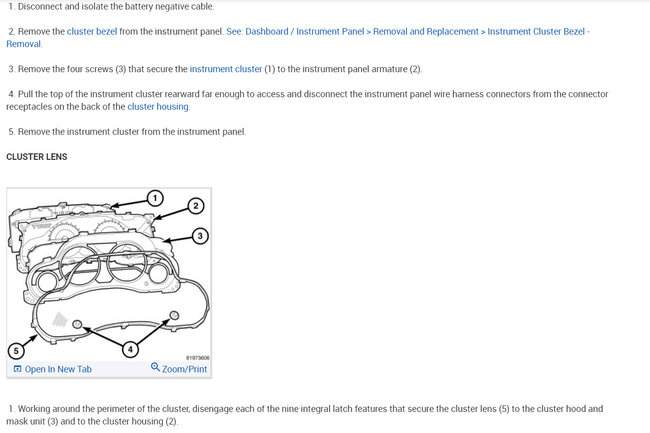

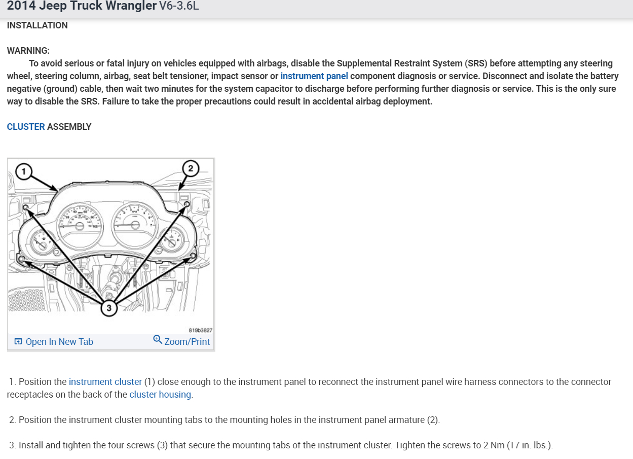

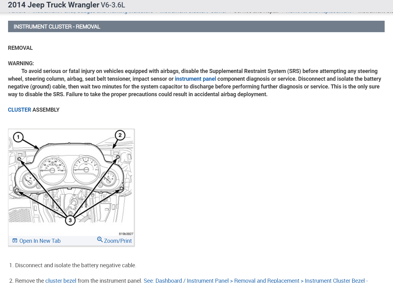

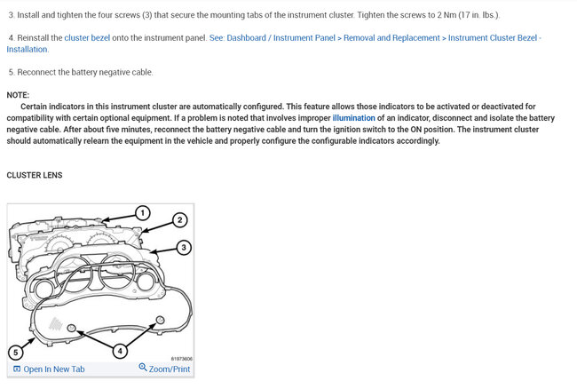

The next part I would have tested is the instrument cluster. Also have you tested all of the fuses with the system on? Here is how to remove the cluster. Check out the images (below). Please let us know what happens.

I ran the gauge cluster self test and did not get any error messages. What would I look for if I took it out entirely?

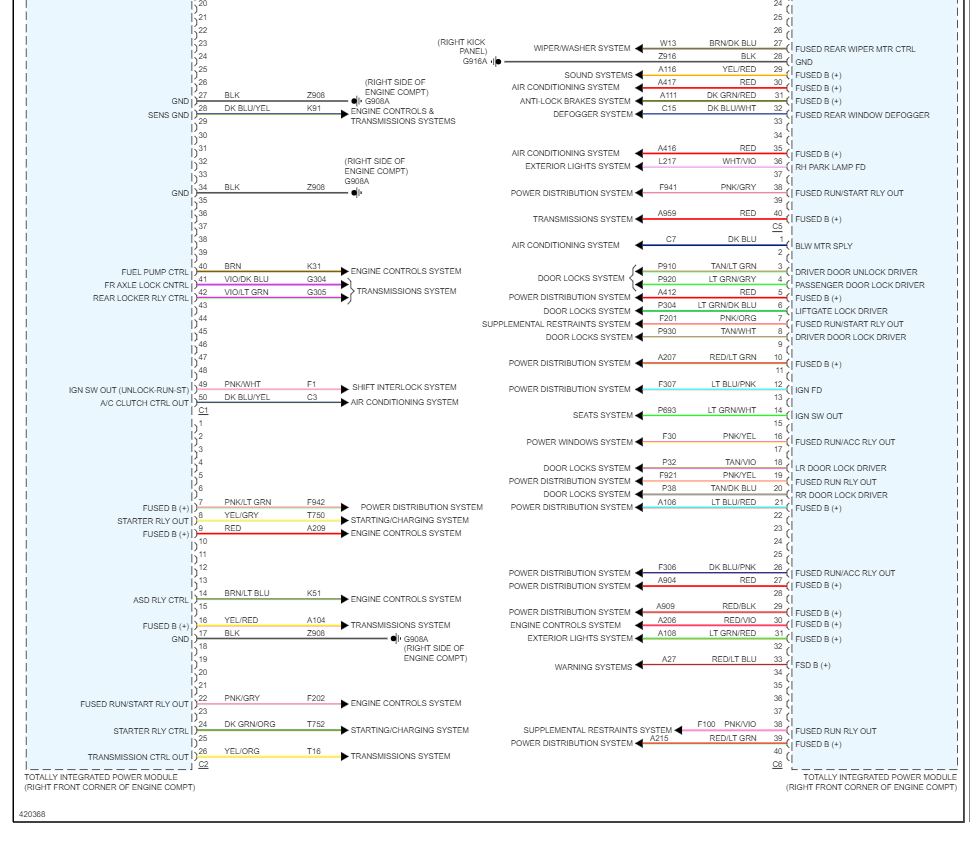

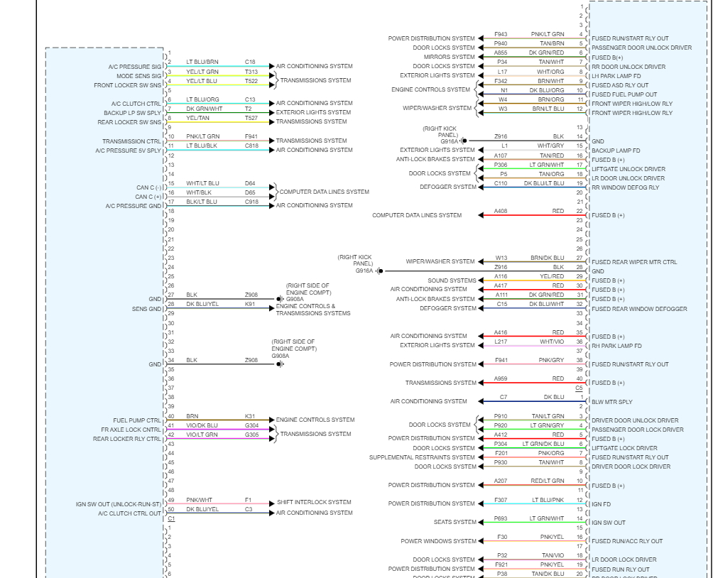

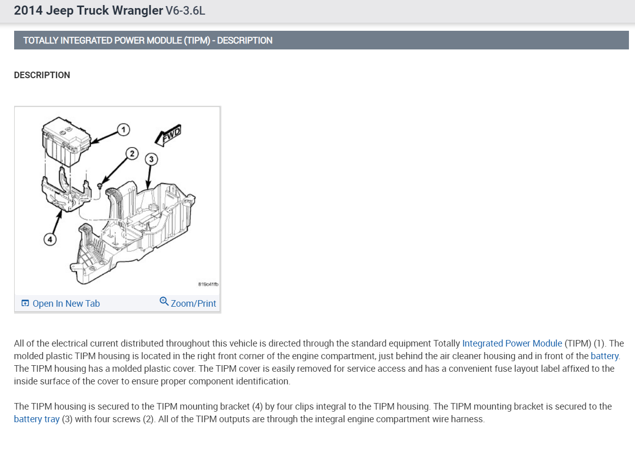

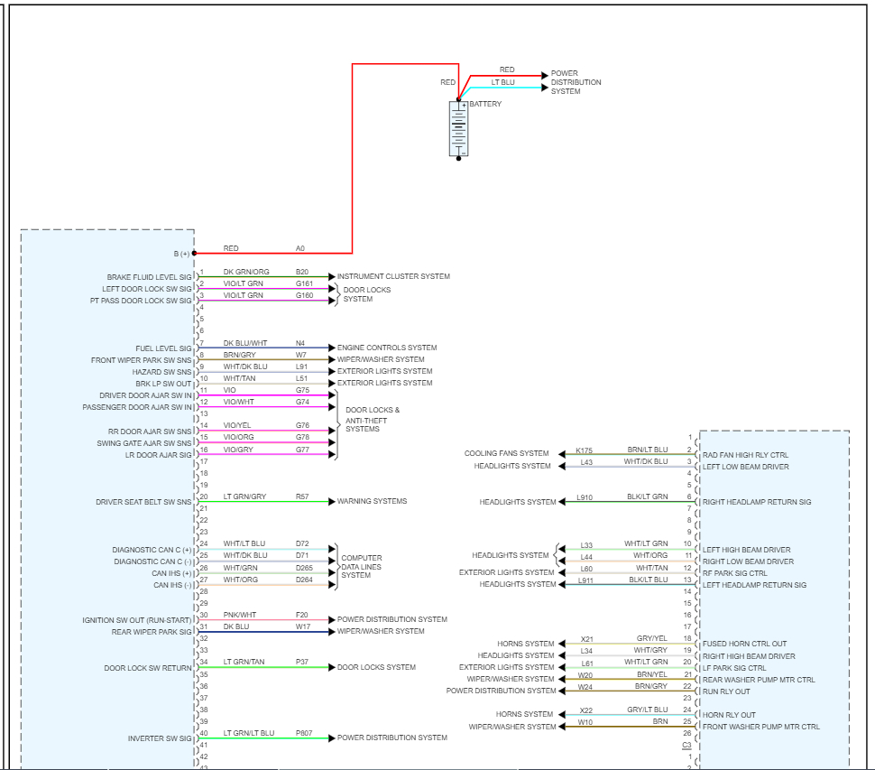

U0141 - Lost communication with IPM (FCM/TIPM) is the concerning code. How was the TIPM tested? It still sounds like it is bad. I would test the power and ground circuits to the TIPM. Here is a guide to help with the test and the TIPM wiring diagrams so you can see which wires are power or ground:
