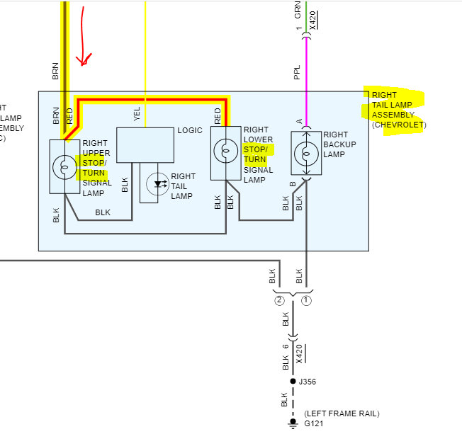

I purchased the SUV listed above and i live in Europe and here it is necessary to add amber turn signal lights, taillights.
Can someone help me out how to split brake and turn signal? I know that escalade has amber turn signal. My car has up to tail light socket six wires, after till to the taillight goes 4 wire. Can i get a wiring diagram or is there some easy way to change it?
I can use 2 to 3 wire converters, but i have no idea what it do when i hit hazard lights?

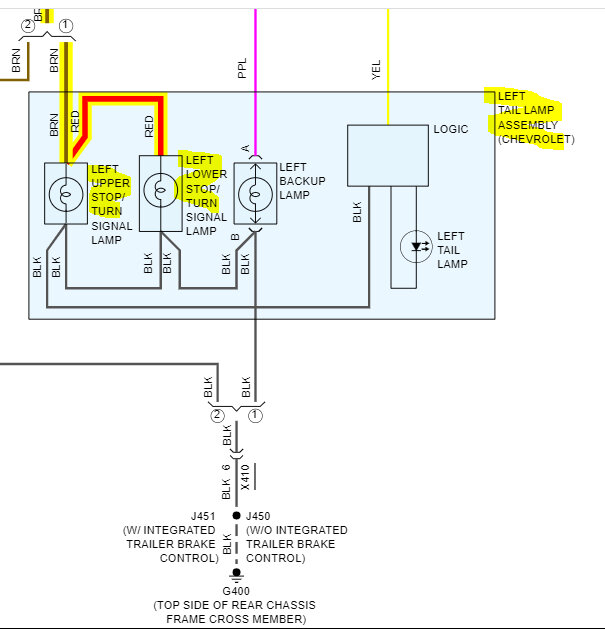

I'm not familiar with what you need to do. However, if you are adding an amber light for signals and brake light, you can splice into the wiring at the tail lamp.
I attached two pics below and highlighted the power supply for each side. The ground for the assembly is black and the power for the brake or signal bulbs is brown.
Take a look at the attached and let me know if they help. If you want to confirm the brown you see is correct, use a test light to confirm power with both functions, brake lamp and signal.
See pics below.
