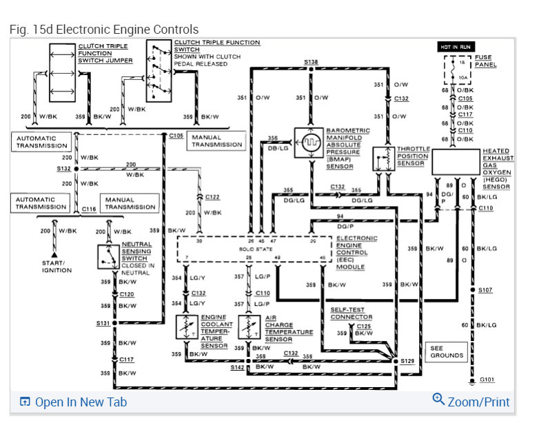

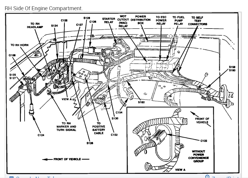

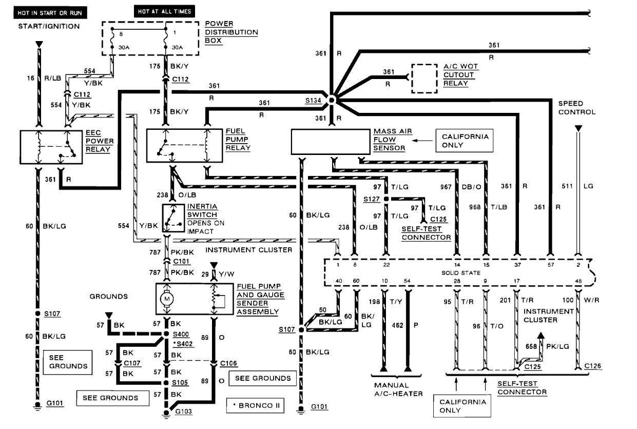

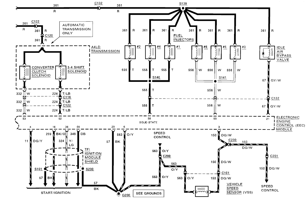

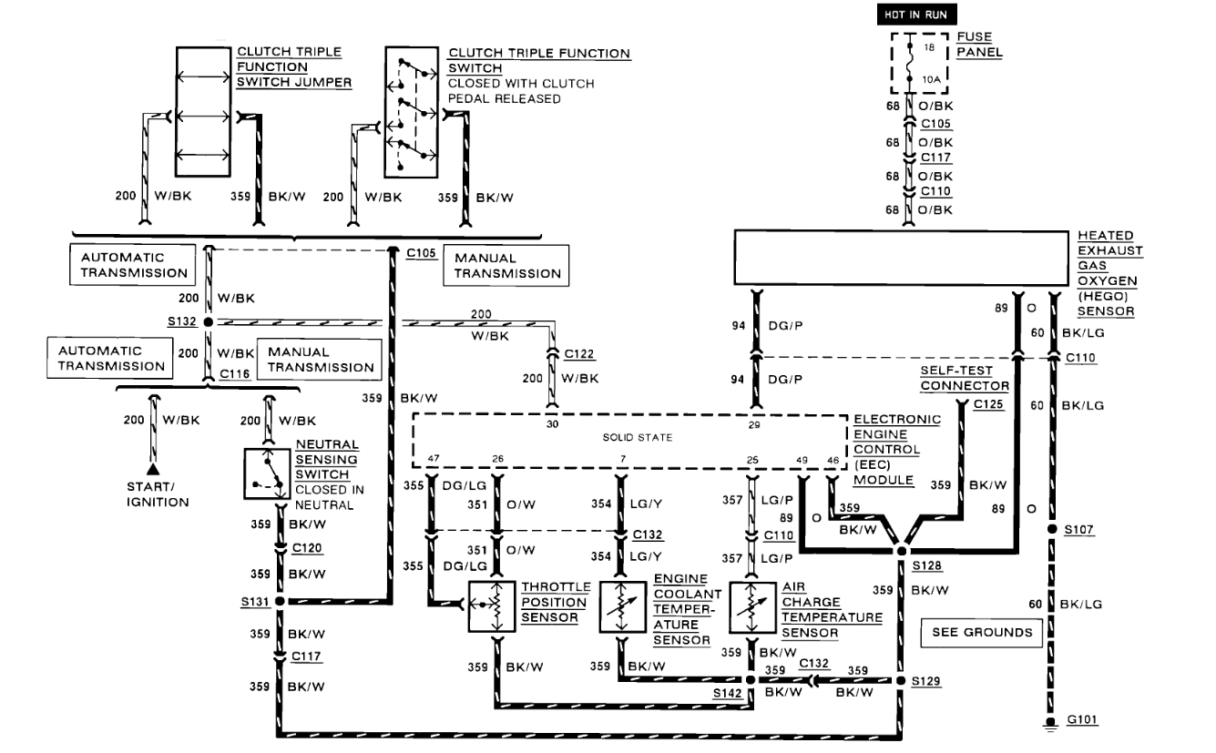

So, the EEC power relay is what supplies the power to the ECM (red wire) the relay is under the hood. Here are the engine control computer wiring diagrams so you can see how the system works and the location of the EEC relay with a guide on how to test it:
