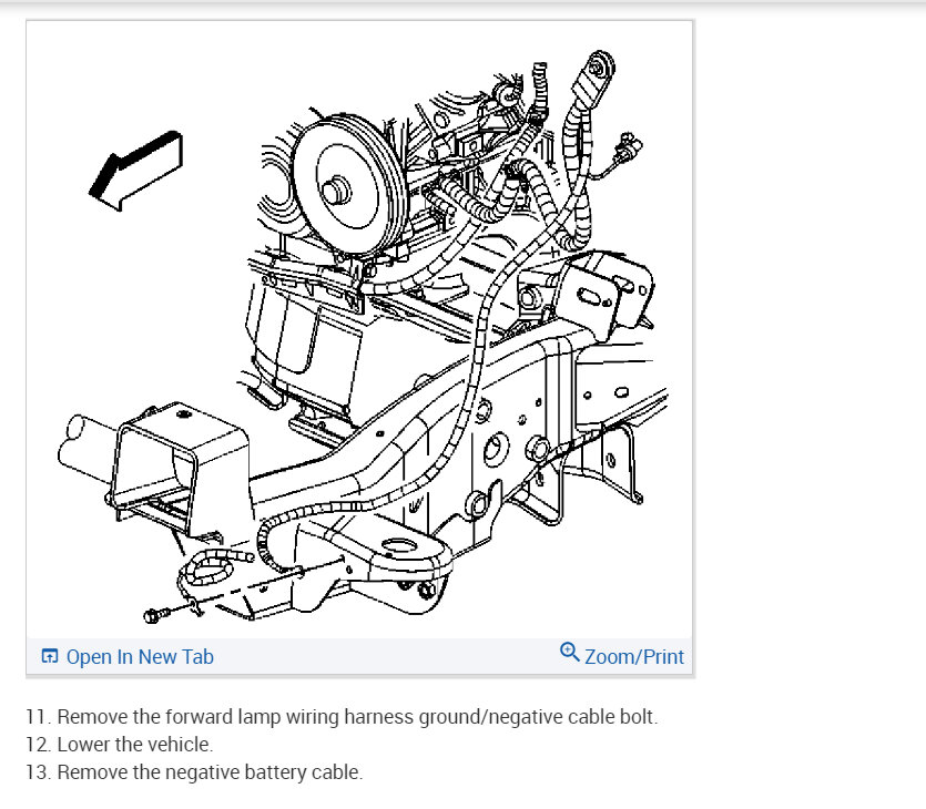

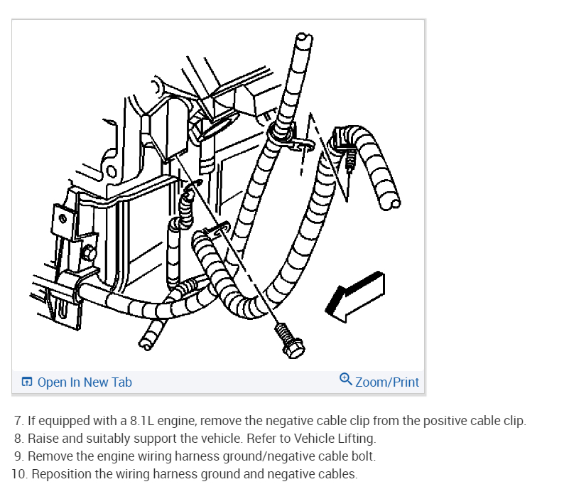

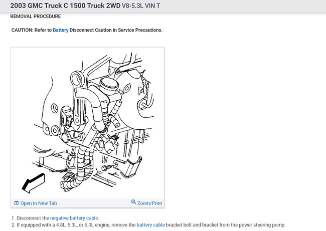

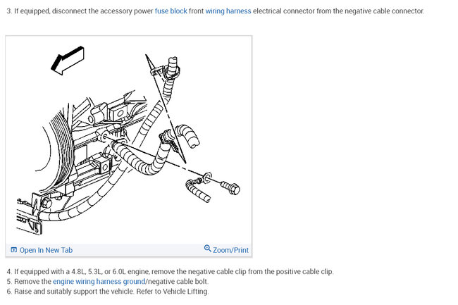

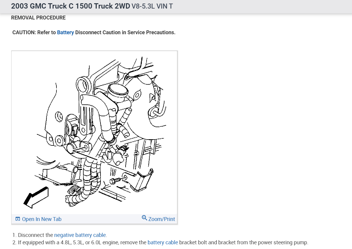

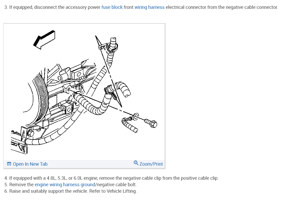

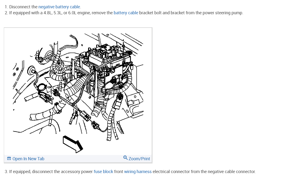

Please double check the main engine ground to the wiring harness, here is the location so you can see what I am talking about. Check out the images (below). Let us know what happens and please upload pictures or videos of the problem so we can see what's going on.
