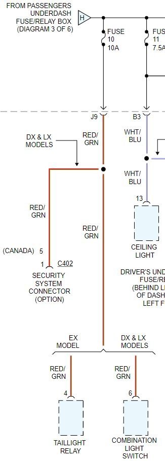

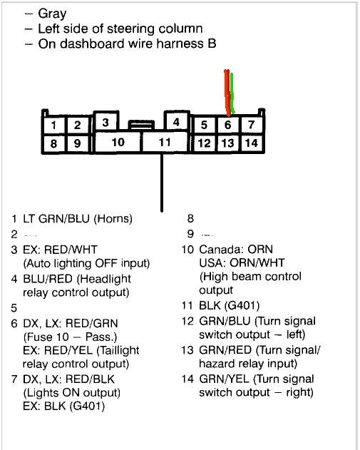

Not 100 percent sure what you are asking for but the multifunction switch only has one wire that runs to a fuse box and that is the red and green wire on terminal 6 which runs through the dash harness to the passenger side box and fuse 10. What is the issue you are having? perhaps we can help you track it down.
