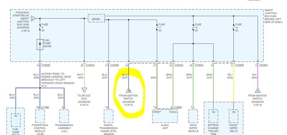

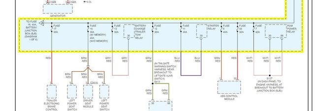

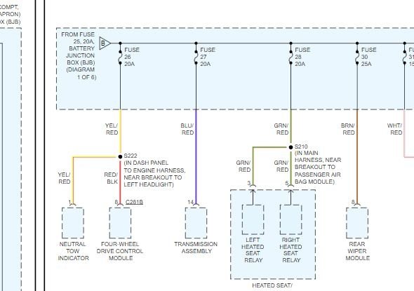

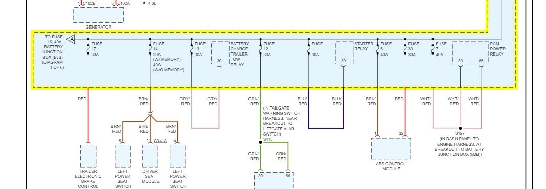

I attached the fuses and power sources. All these fuses are fed from the ignition switch.
