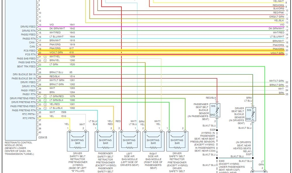

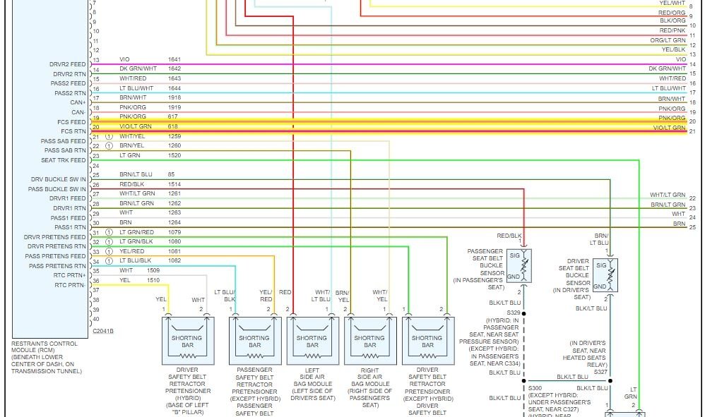

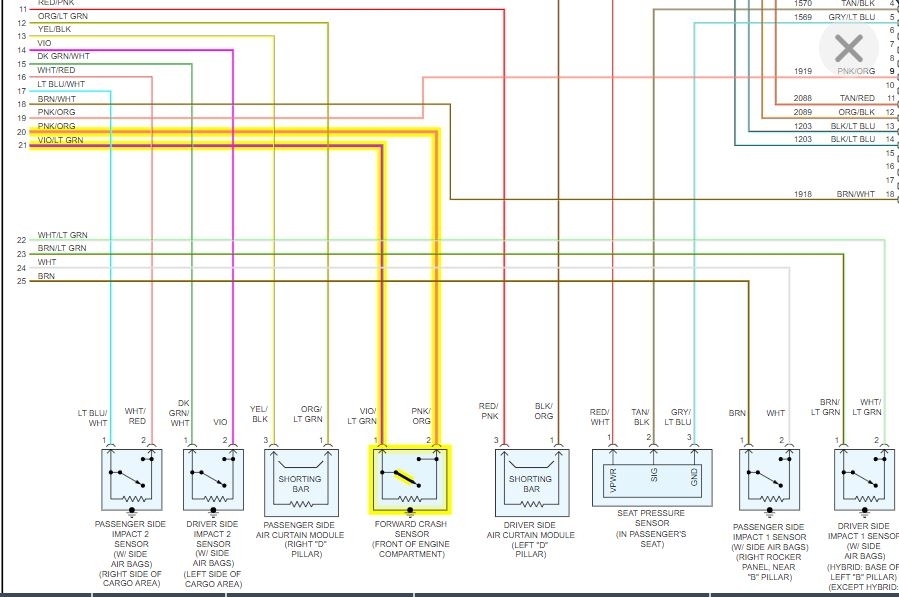

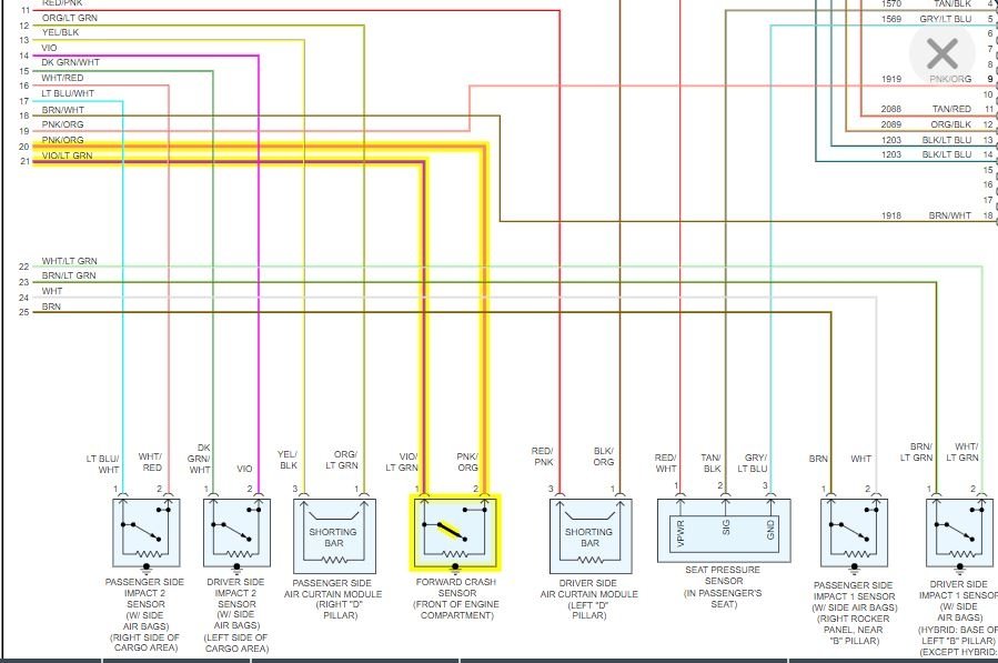

I figured out. it's the front crash sensor for the airbags. Which wire connects to it?
Feb 2, 2020 at 5:02 AM
I attached the wiring diagram for you to view.
There are 2 wires that go to the sensor from the airbag module.
