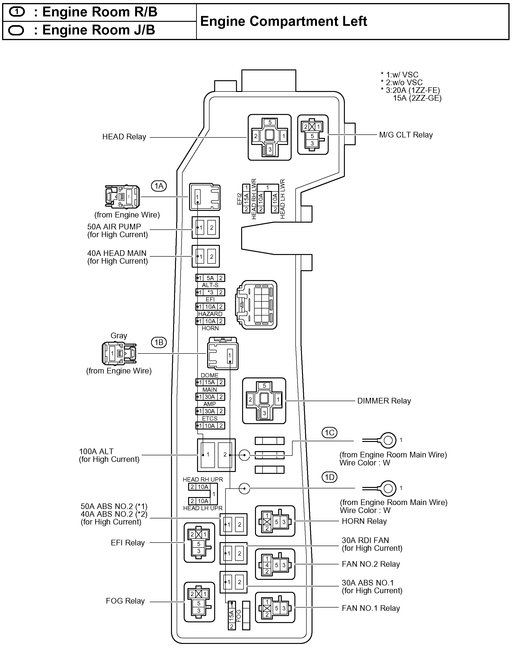

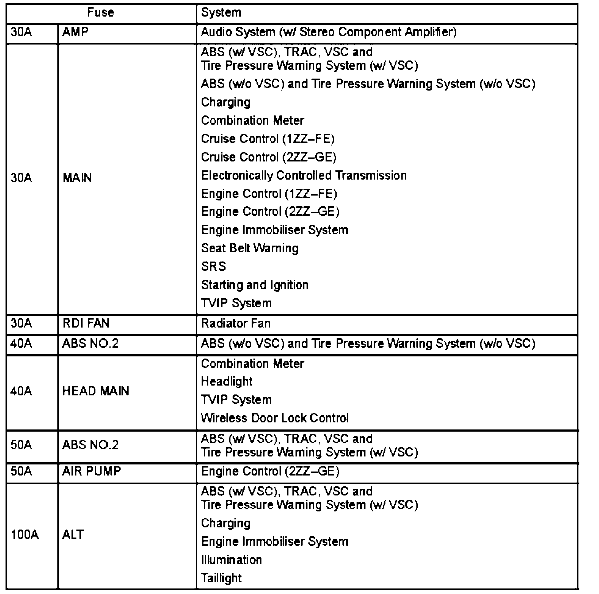

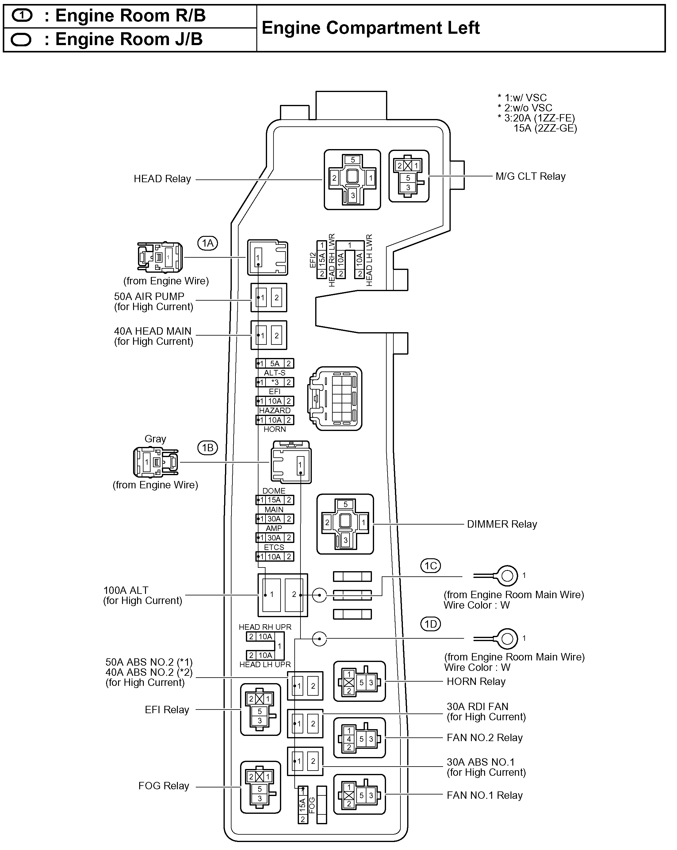

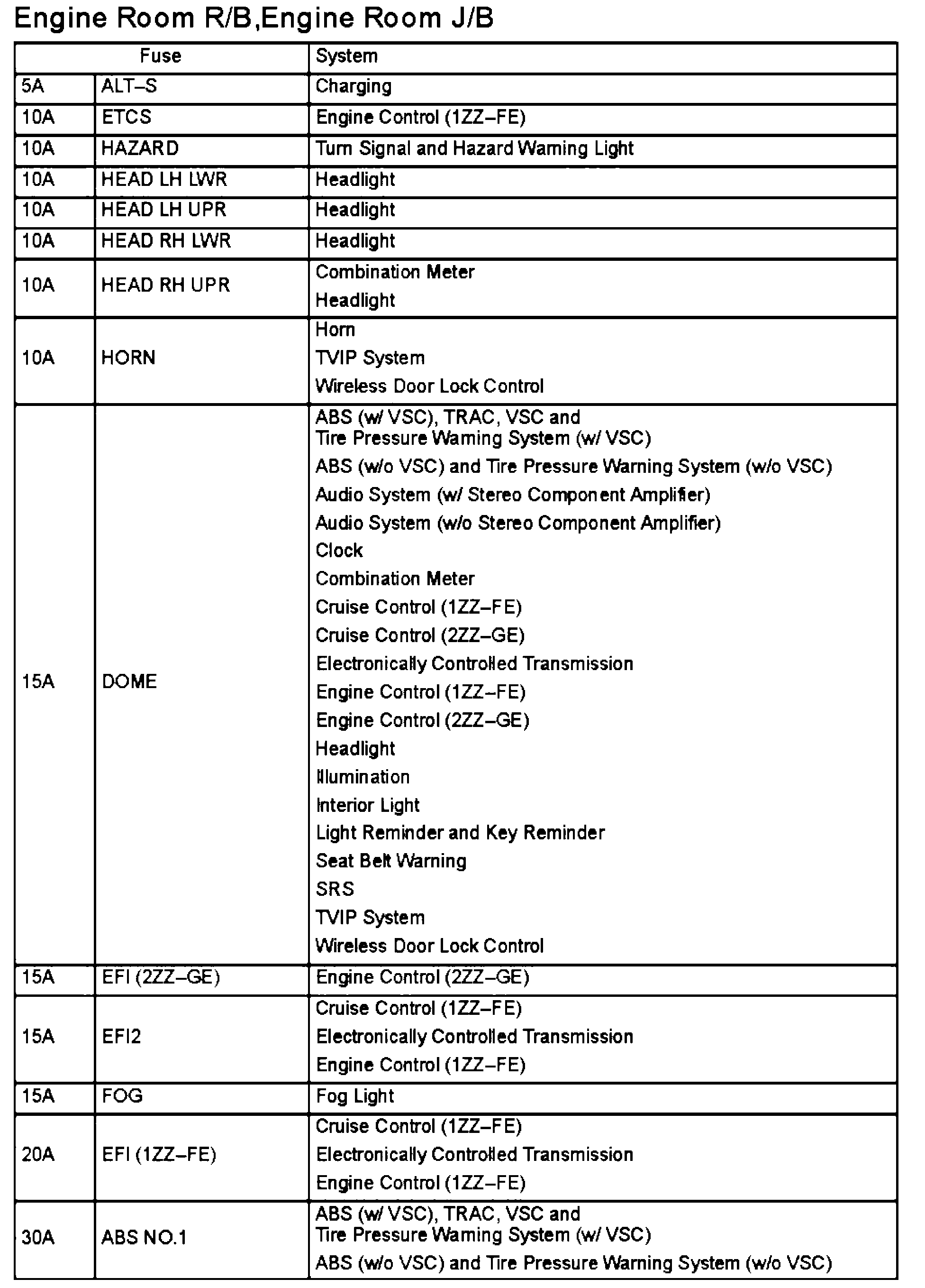

Next, I need you to check the main fuses under the hood in the power distribution box (fuse box). I attached two pictures which indicate the fuses found there. The third picture is of the fuse box under the hood. It is on the driver's side inner fender. Make sure the main ones are all good.
https://www.2carpros.com/articles/how-a-car-fuse-works
Check those things to start and report back to me with what you find.
