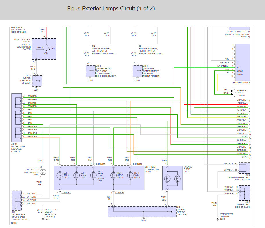

Had wrong battery put on from Walmart. Blew main fuses and replaced fuses plus put back correct battery. Runs great now but right parking lights don't work. No fuse is out and light bulbs were good but have not checked a second time. Left turn signal is on when lights are turned on in manual and radio blinks when right side turn signal is used when lights are off auto mode. Right side parking lights and rear do not work. I am thinking of trying another relay switch and checking the front light bulb which is inoperable the back parking light is again not working either. Your thoughts?

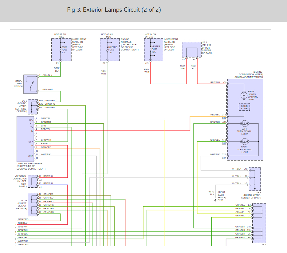

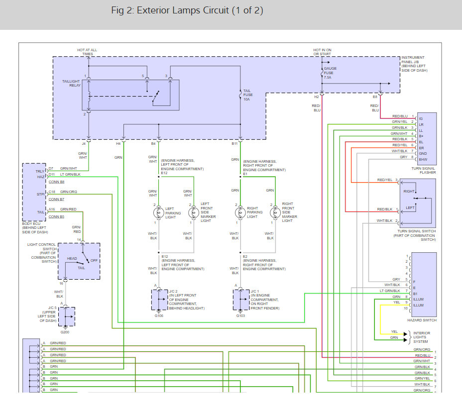

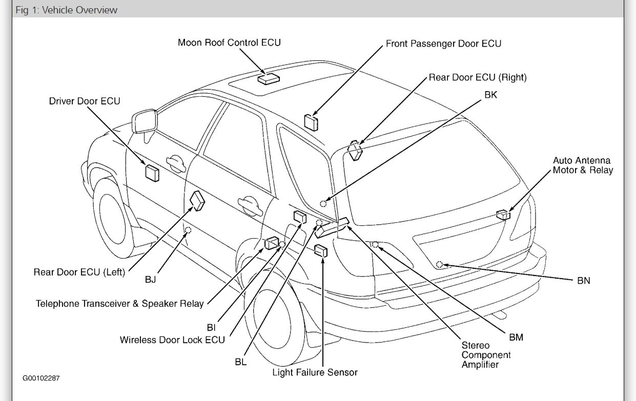

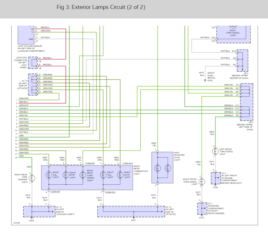

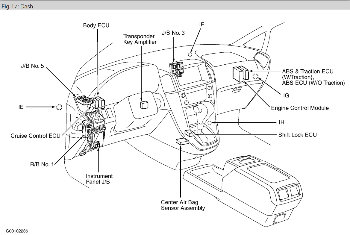

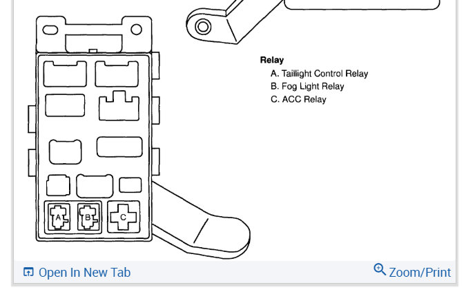

There is a taillight relay we need to check and the light fail sensor they had problems with. Here is a guide to help you check the relay with the sensor and relay locations with the wiring diagrams so you can see how the system works:
May 23, 2019 at 12:19 PM
MRMOJORISIN549
  • 6 POSTS
Thanks. i think i will try the checking the light bulbs again then try a different relay and see if that incorrect battery took it out. Let you know how it goes.

It wasnt the turn signal relay but there is a brake failure relay under panels in the left rear trunk area and a couple points on the circuit board were dark. I will be looking for another one. I may try different turn signal lever i found on another wrecked one.
May 26, 2019 at 9:12 PM
I have seen the tail light sensors go out in these cars. I would replace it to see what happens or use the guides and wiring diagrams about to confirm the power failure. Please let me know.

This sounds like a bad ground. lets use a test light and follow this guide:
https://www.2carpros.com/articles/no-tail-lights-exterior-running-lights-tail-lights-out
Jun 4, 2019 at 10:05 AM

Bought two more brake light modules from salvage yard. Checked all fuses to make sure the had power with test light and they did. First brake light module box had no rear parking lights lights working. Second one has everything working but right side parking lights front and back but at least have night time rear lights and left rear turn signal blinks left and right rear light slightly. So i am back to original problem. Got to be wiring somewhere.
Jun 19, 2019 at 10:16 PM
It does. check out this guide and the wiring diagrams above to check the connections:
Please let me know.
