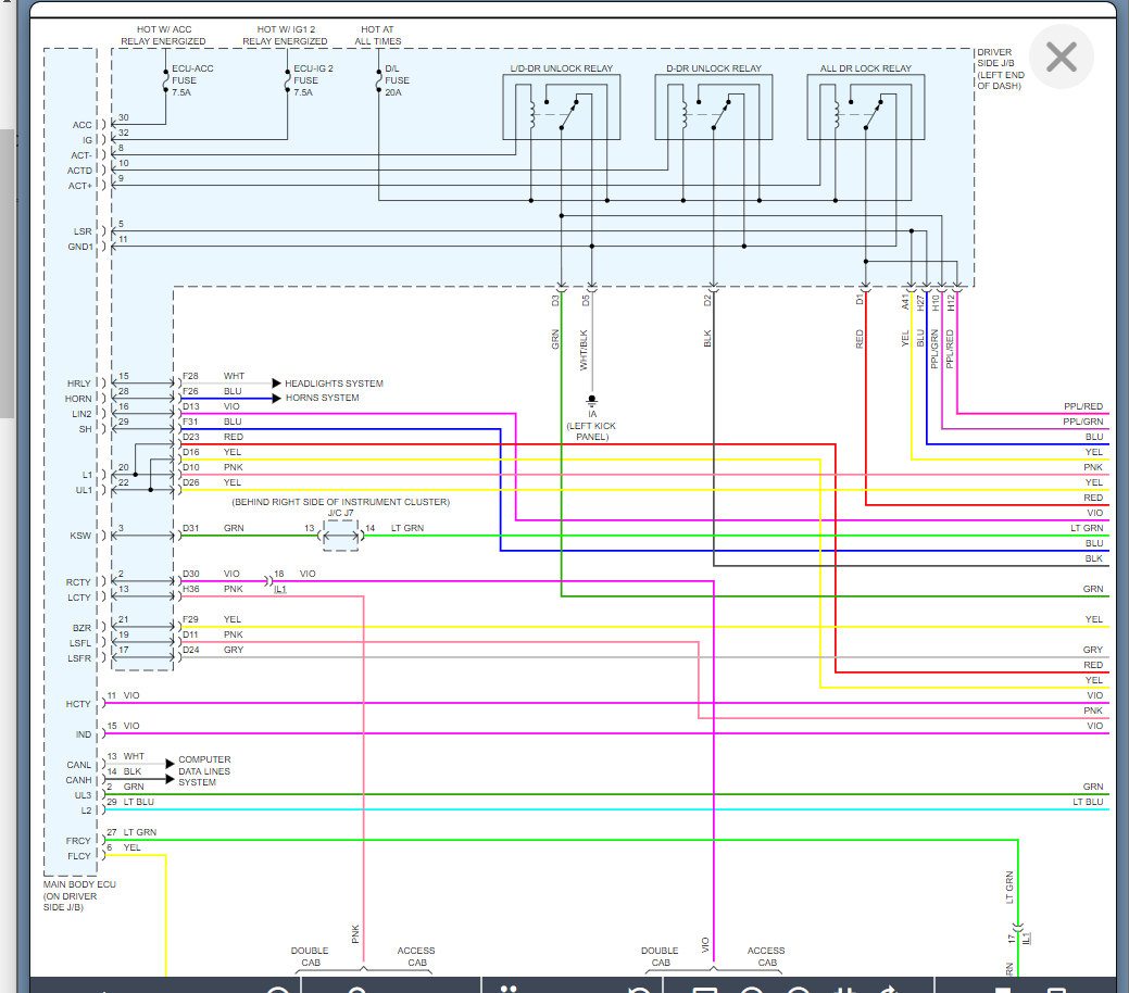

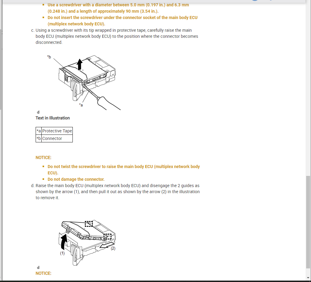

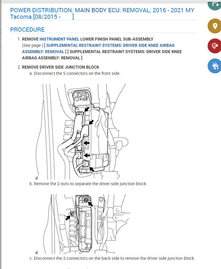

Okay, the key fob quit locking/unlocking doors, interior lights quit coming on when door was opened, and the trip mileage and average miles per gallon reset to 0 every time you turn the ignition off and restart vehicular. Interior lights will come on when ignition is on accessory and door is opened. Also the temperature, fuel, tachometer, and speedometer stay in the position they were in when you shut vehicle off. Battery voltage off is 12.54, running is 13.9. Tested all fuses and none were bad, but after that there was no headlights, A/C, windows won’t go down, turn signals work, hazard signals work and truck starts and runs just fine. Note: it does not have a keyed ignition switch it’s push button, and the navigation screen works but all of the stored information got deleted, previous destinations, calls, preset radio and Sirius stations, and the Bluetooth to the phone for music cuts in and out. Last time it was in the shop for service was in April before we went on a trip all fluids filters were changed and we had no problem whatsoever on our trip, just started this last week.
