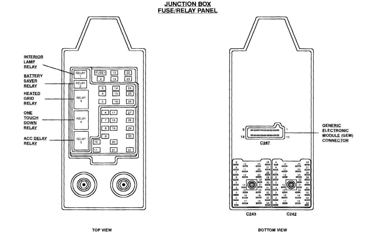

this sounds like the battery saver relay is stuck on. To be sure let's use this guide with the relay location in the diagrams below:
Battery Saver Relay Behind left side of dash, on junction box fuse/relay panel. Check out the diagrams (below). Let us know what happens and please upload pictures or videos of the problem.
