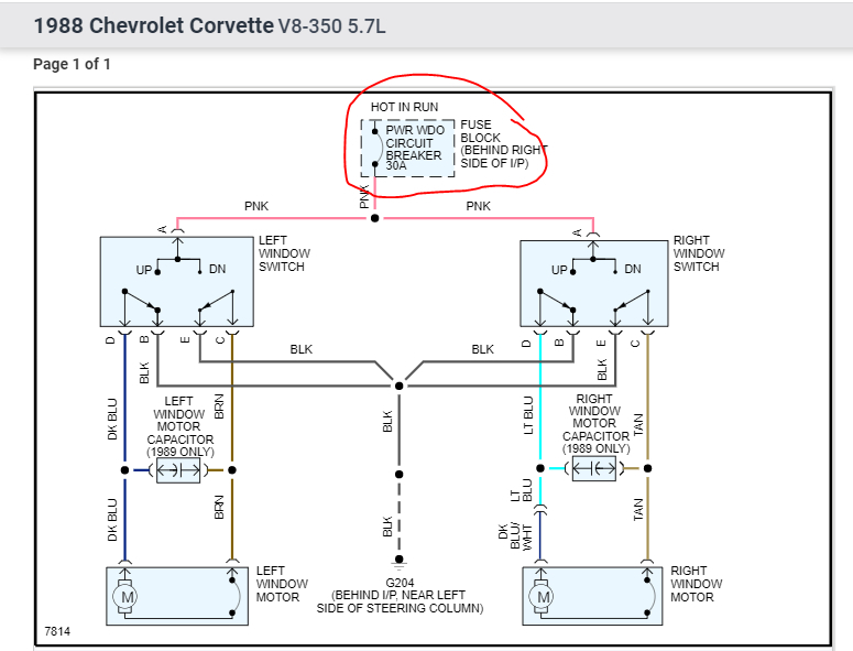

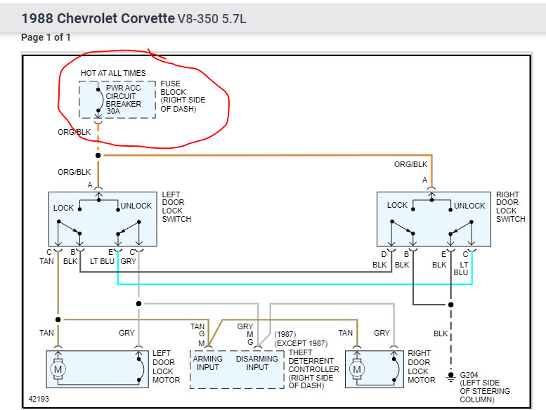

I was pulling the interior door panel to replace a trim piece. I used a screwdriver to pry off a flat plug off the door panel. Goes to windows, locks, etc. I caused an arc. Now the electrical is 100% dead. No starter, no windows, no dash. I have pulled each fuse in the fuse block and all are okay. I have considered a fusible link. I pulled the battery and saw seven different links, but none were visibly damaged.
