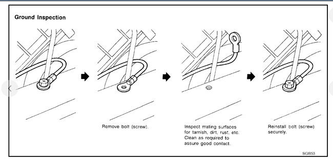

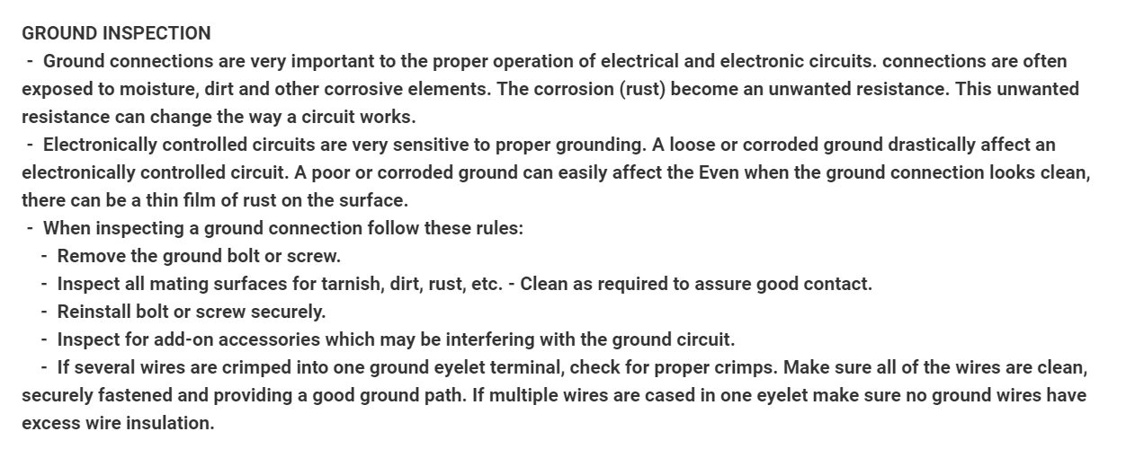

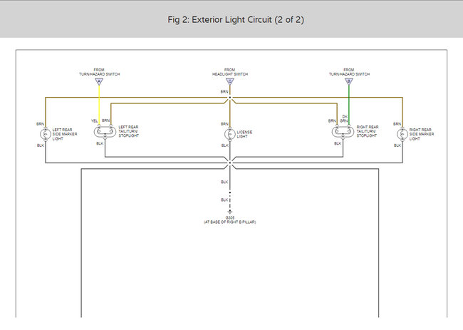

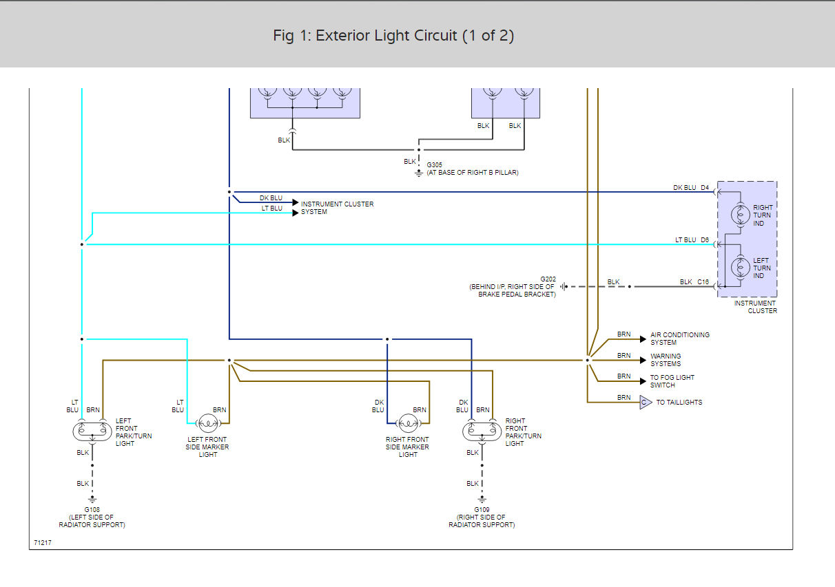

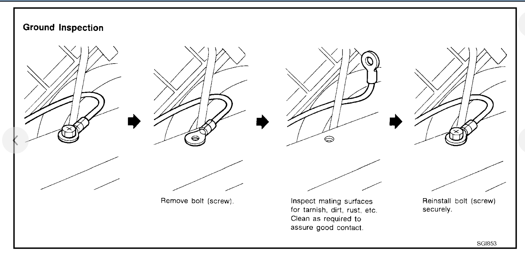

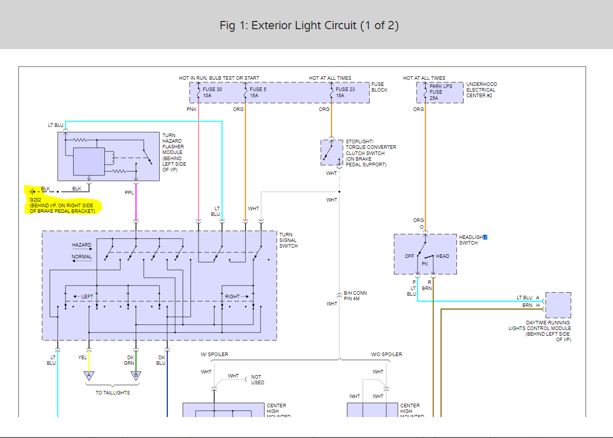

This could be a problem with Ground G202, underneath the instrument panel on the left side of the brake pedal bracket. I have included an exterior lighting wiring diagram with the ground highlighted for you in the diagrams down below as well as a guide on the proper way to check a ground. Please go through these guides and get back to us with what you find out.
Thanks,
Alex
