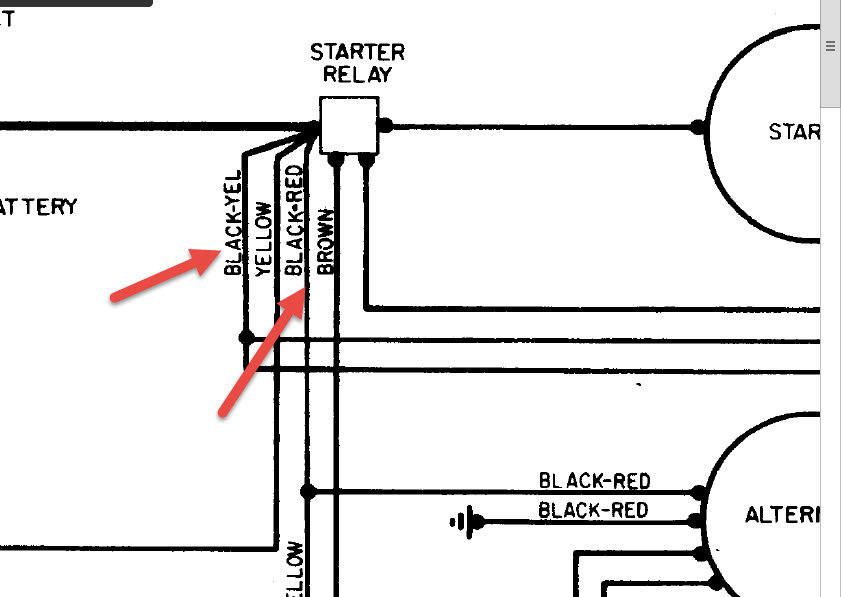

put in charged battery checked ground to motor terminals hooked up no power to anything lights horn etc. never have seen this before

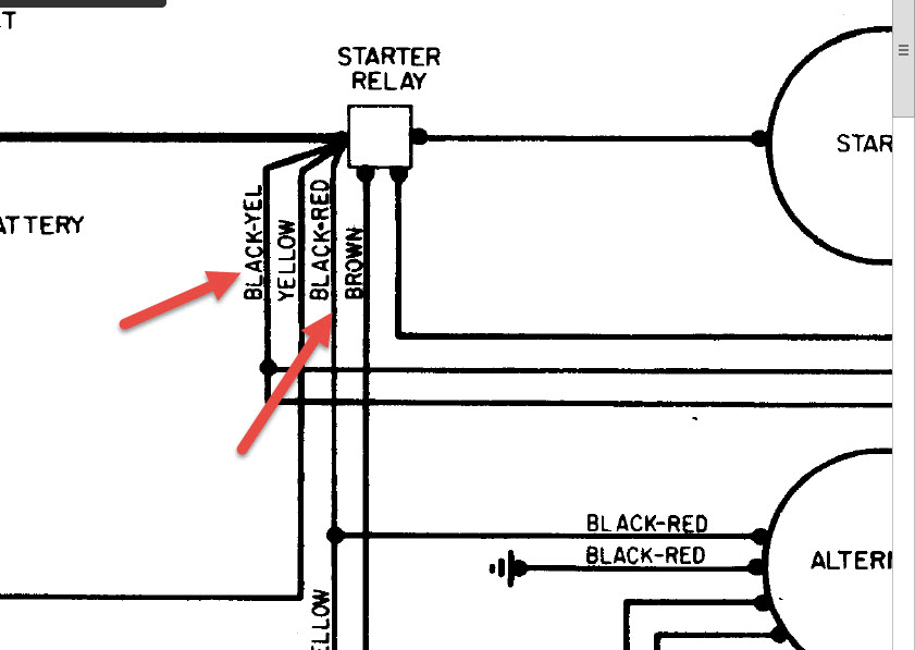

check to see if your fusible links are burnt up or even hooked up one goes to alternator other one powers truck see pic
