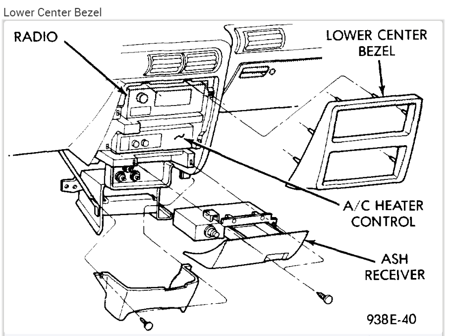

This is a very common issue on these cars from 1994-97 and it's due to poor solder joints in the climate control head. You can pick up re-manufactured units on eBay for around $100.00 to $150.00. I'll post information below on replacing it
REMOVAL
1. Remove the ash receiver assembly, if necessary
2. Remove the lower center bezel and remove the mounting screws from sides of control.
3. Remove the control and disconnect the two electrical connectors.
INSTALLATION
- For installation, reverse the above procedures.
