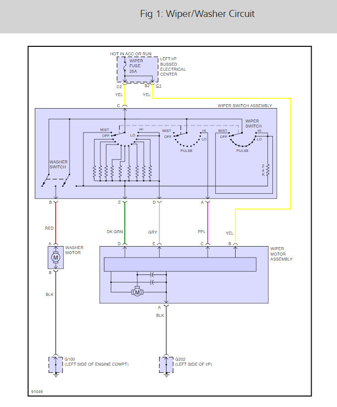

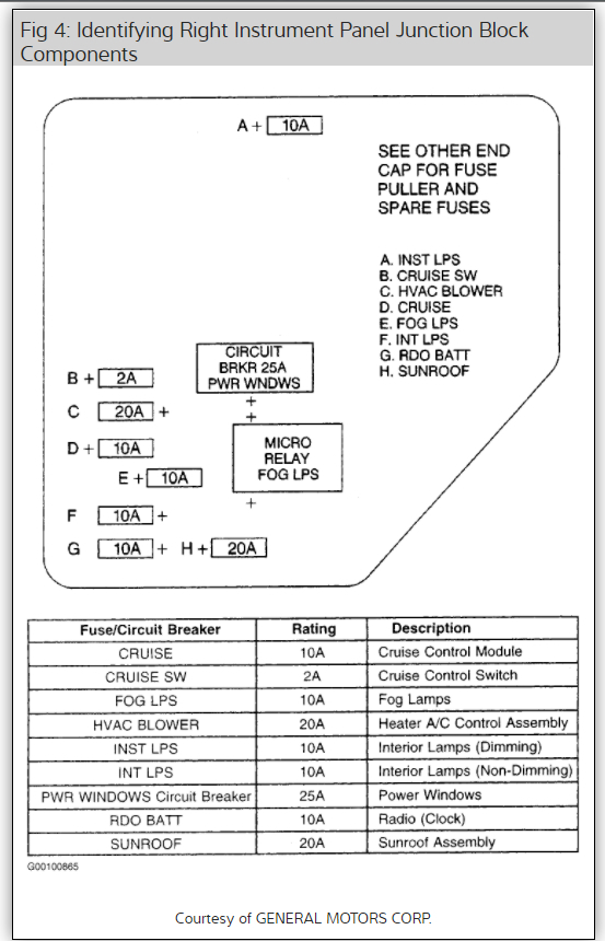

Lets start by checking for power at the wiper fuse. here is a guide and the wiper wiring diagrams so you can see how the system works:

Fuses new, power to fuse good. if washer motor is bad could that cause problems? if so can i unhook it or is it used to complete another circuit?
Mar 4, 2019 at 4:52 PM
Yes, you can disconnect the motor and use this guide to check for power and ground of the circuit.
Please run down this guide and report back after you checked the power and grounds.

What happens with the washer motor?

Washer pump no good, if i leave it unplugged will that stop anything else from working?

You can leave it unplugged no problems. You are welcome for the shirt. Use 2CarPros anytime, we are here to help. Please tell a friend.
