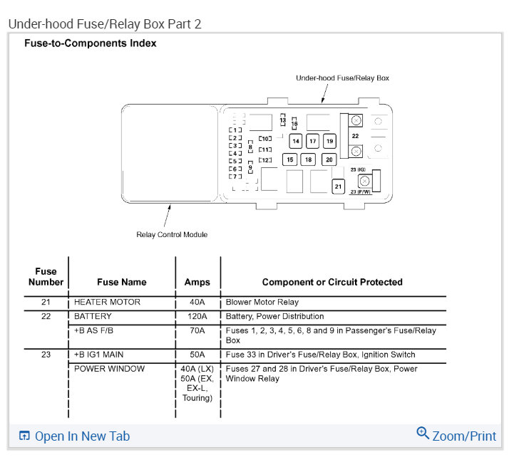

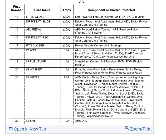

My turn signals will not work, my rear wiper does not work, my outside temperature is blank line, my front wipers will not work on intermittent, and my headlight indicator does not display but headlights do work.
