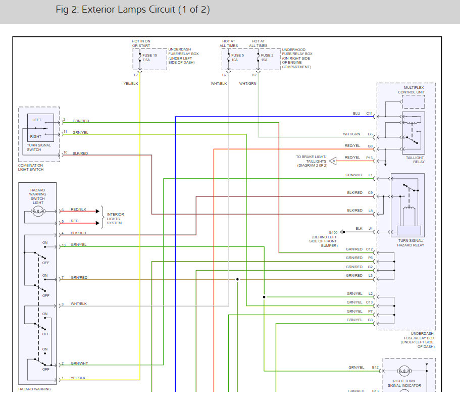

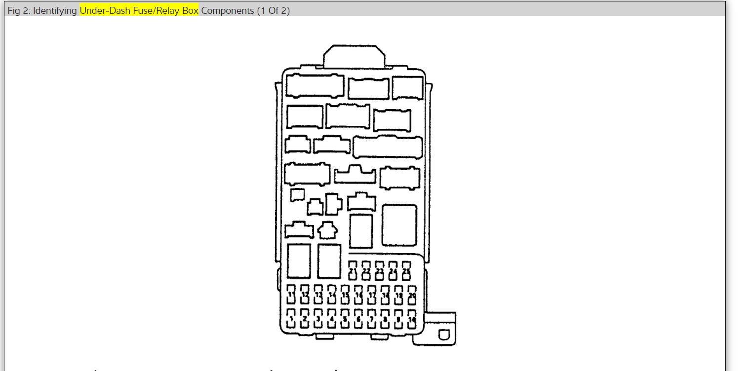

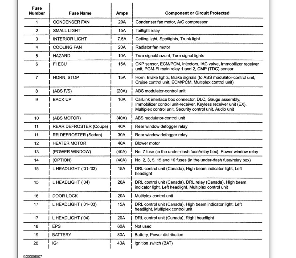

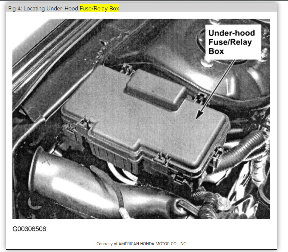

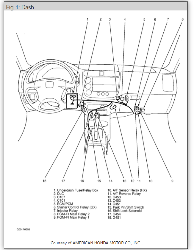

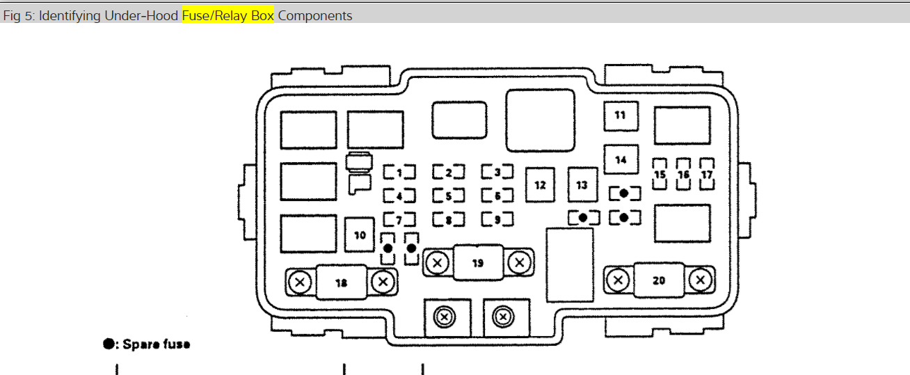

There is a tail light relay that needs to be checked. here is guide to help and the location of the relay:

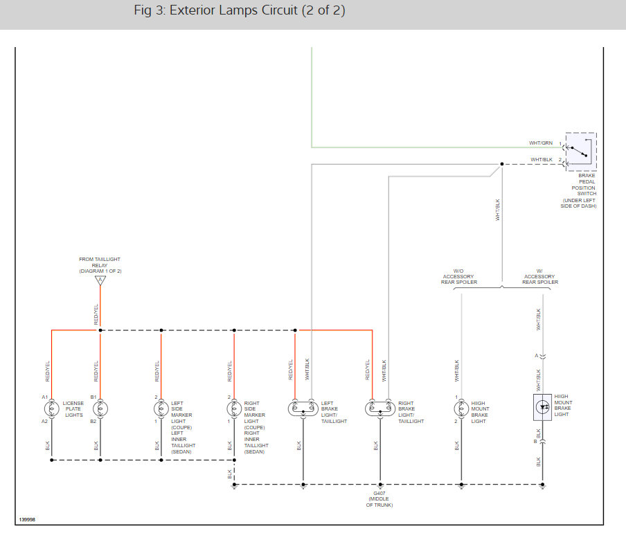

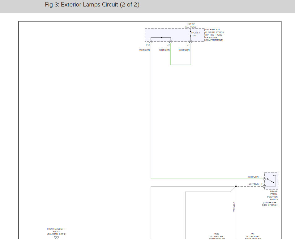

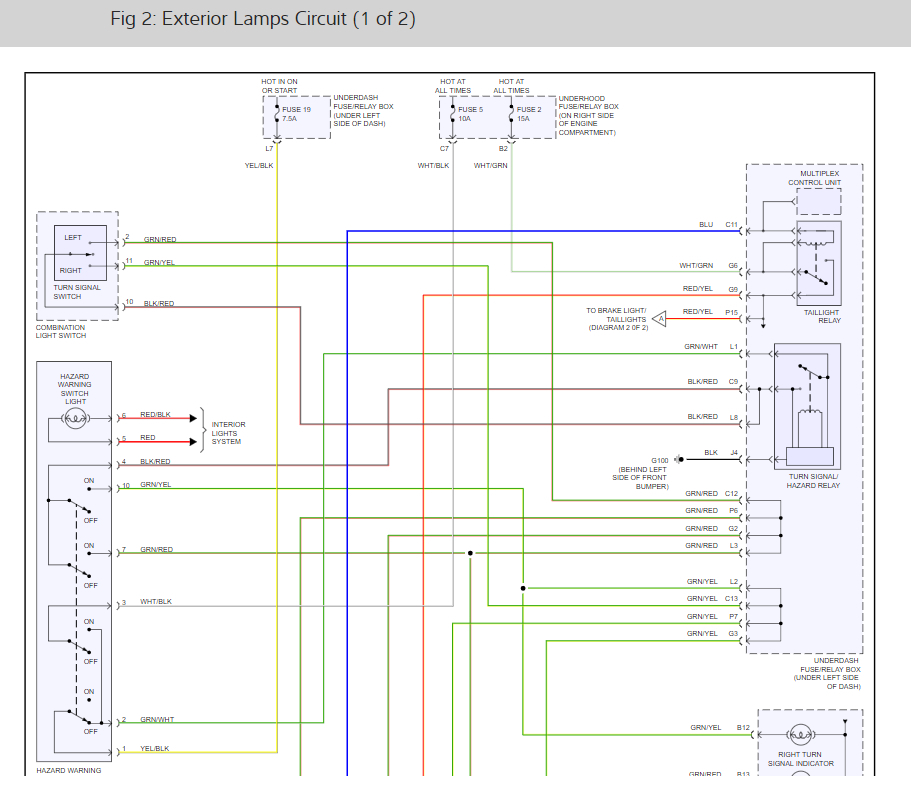

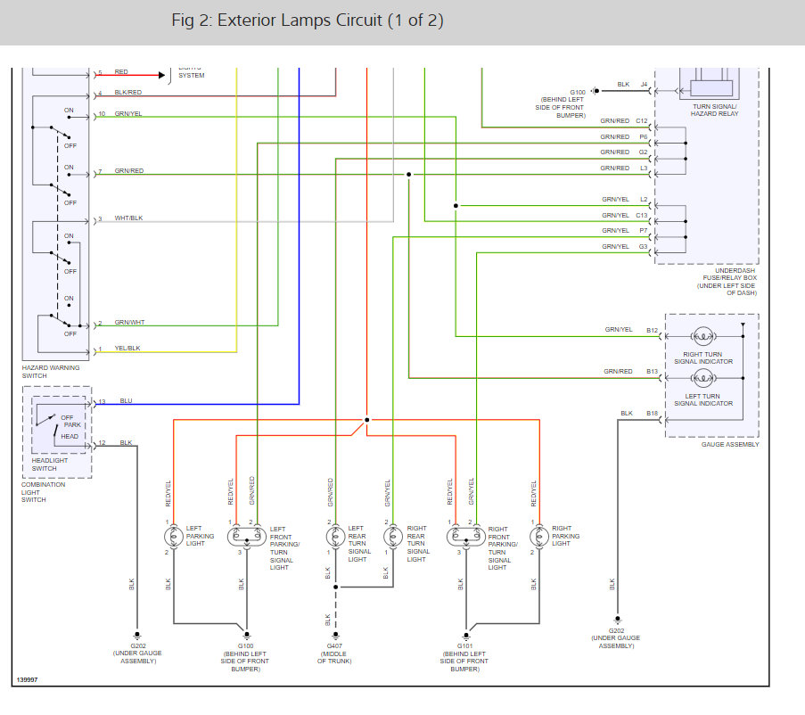

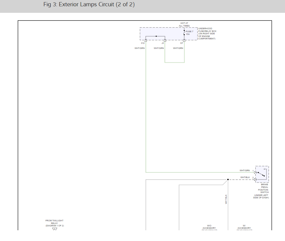

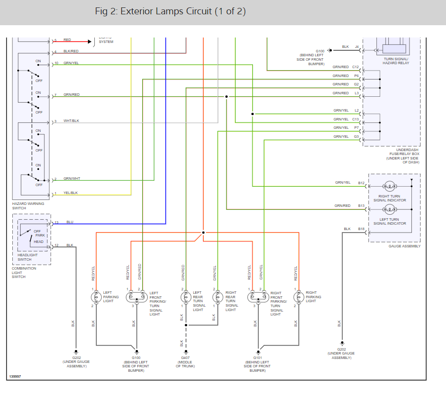

Here are the blinker wiring diagrams so you can see how the system works and where to check for power.
