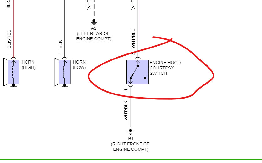

This hood switch is an example of what needs to be latched so the vehicle thinks everything is closed and locked. Then it will power down the modules and go to sleep. Communications on the CANbus networks will stop, this is a tough test, you'll need a wiring diagram of whatever fuse you find that has voltage on it. The fuses should all read 0 volts when the car is off. and locked up, powered down. Any questions just ask. Be patient with this though. Give the car 30 minutes after locking up and the security system is activated.
