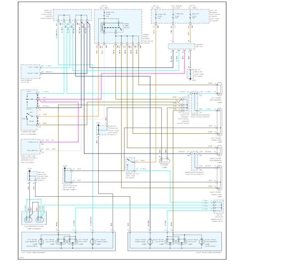

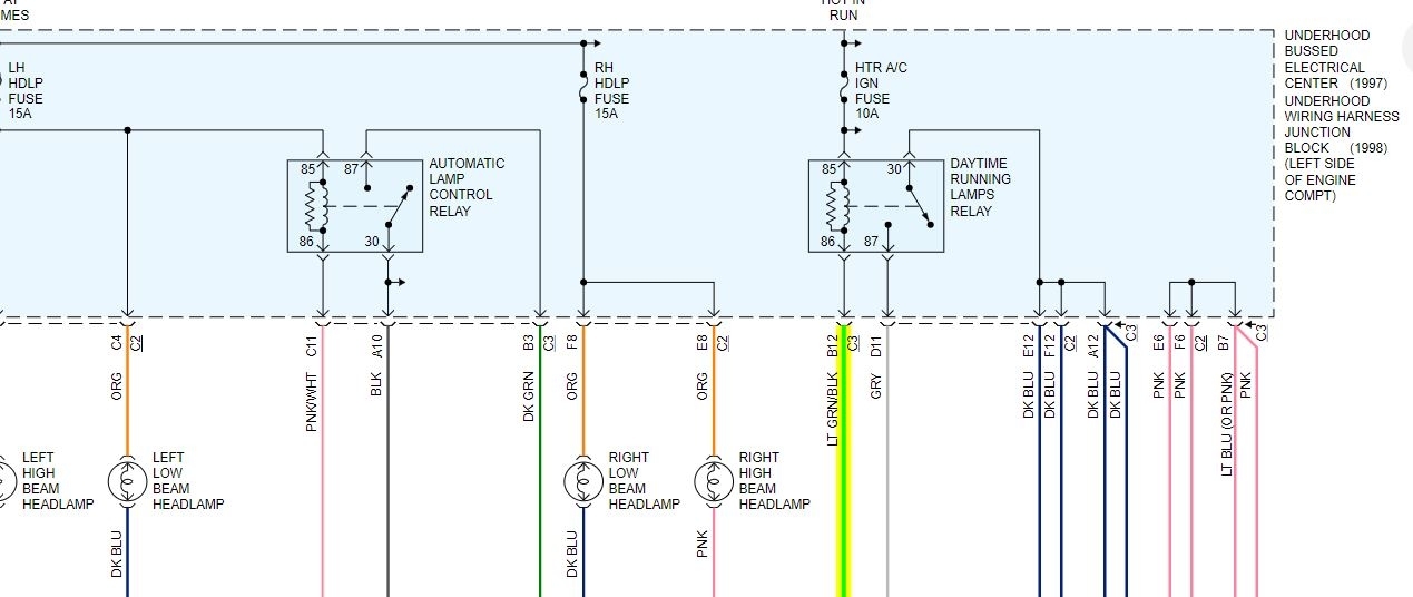

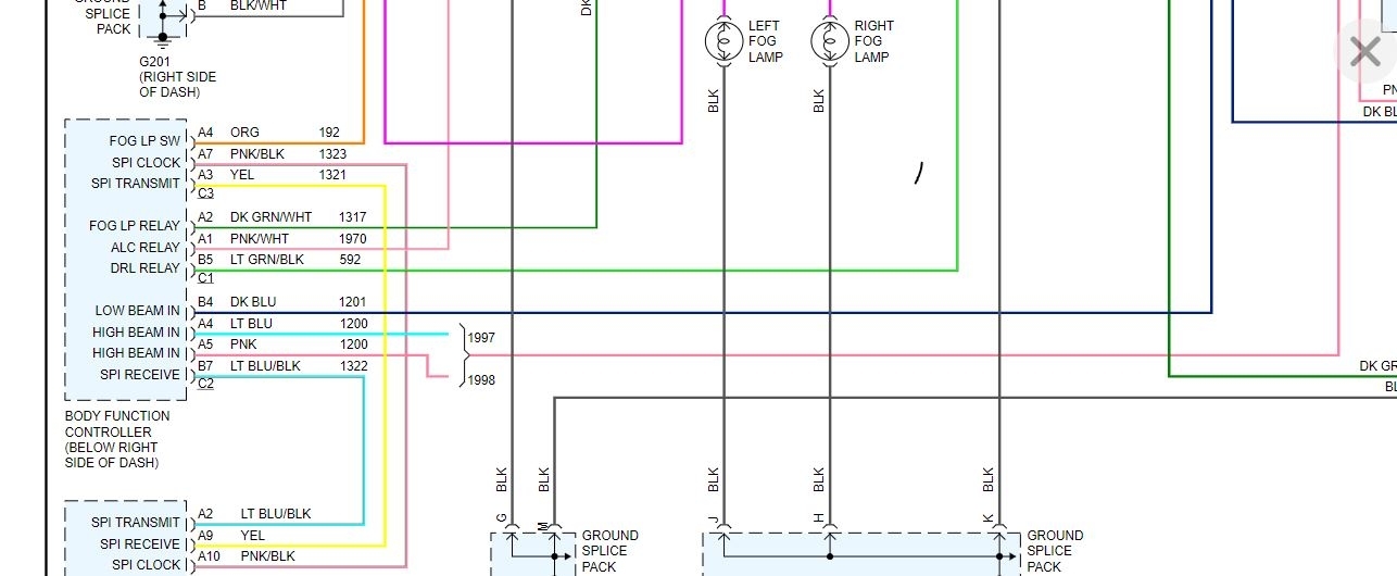

i cleaned grounds, replaced front bulbs headlights wont come on at start of engine not until put in gear. then no high beams unless i use manual light knob, cover daylight sensor lights come on at start up high beams work but radio light dims. i am still looking for mouse chewed wire causing electrical issues. will it hurt to put tape over daylight censor? Thanks.
