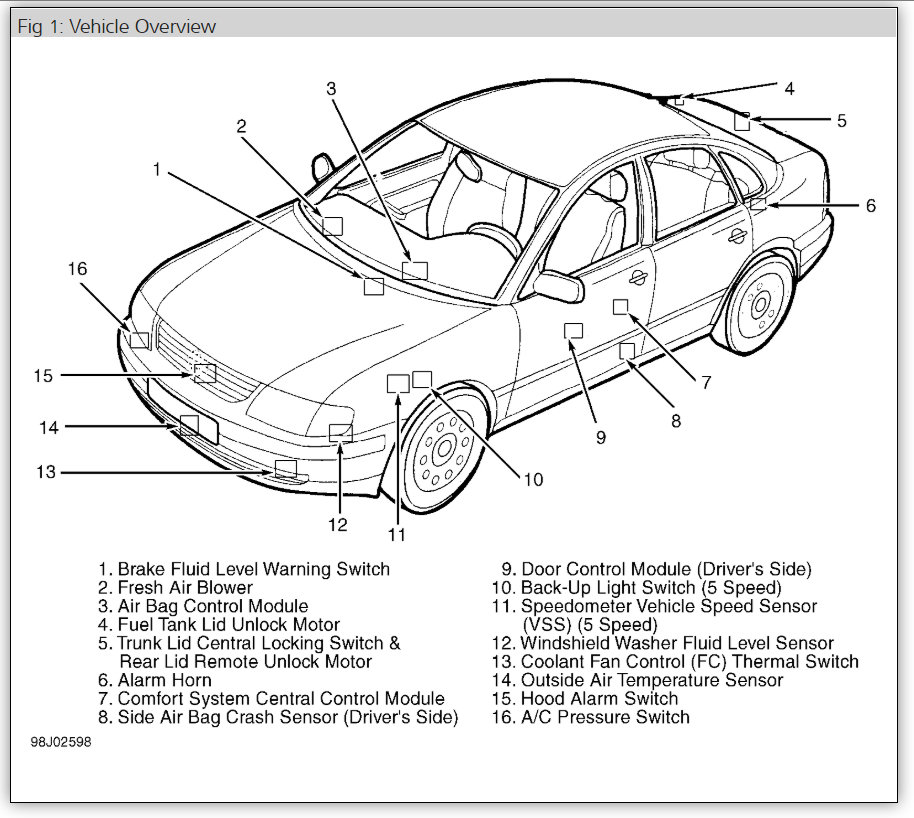

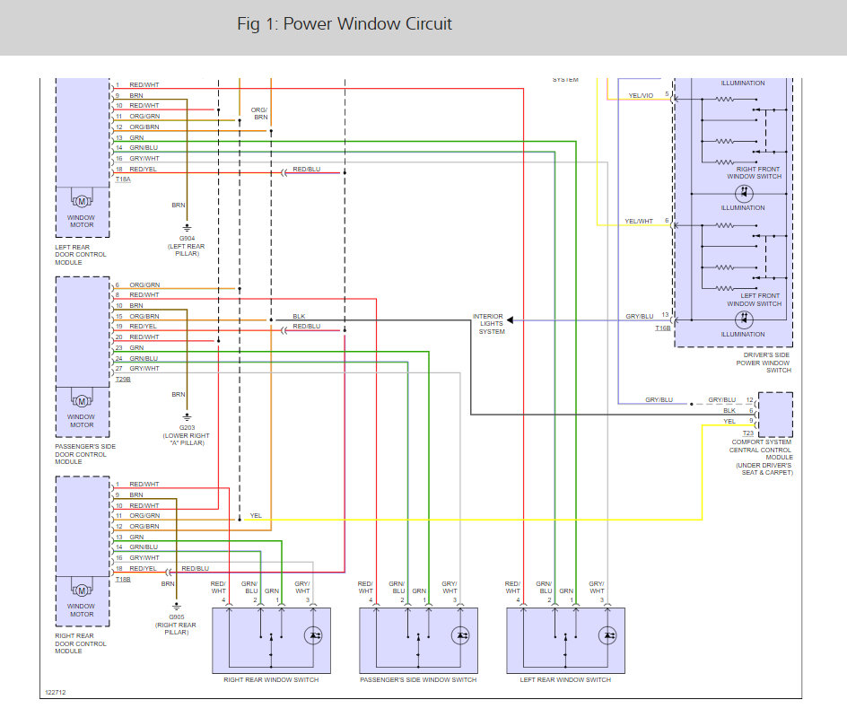

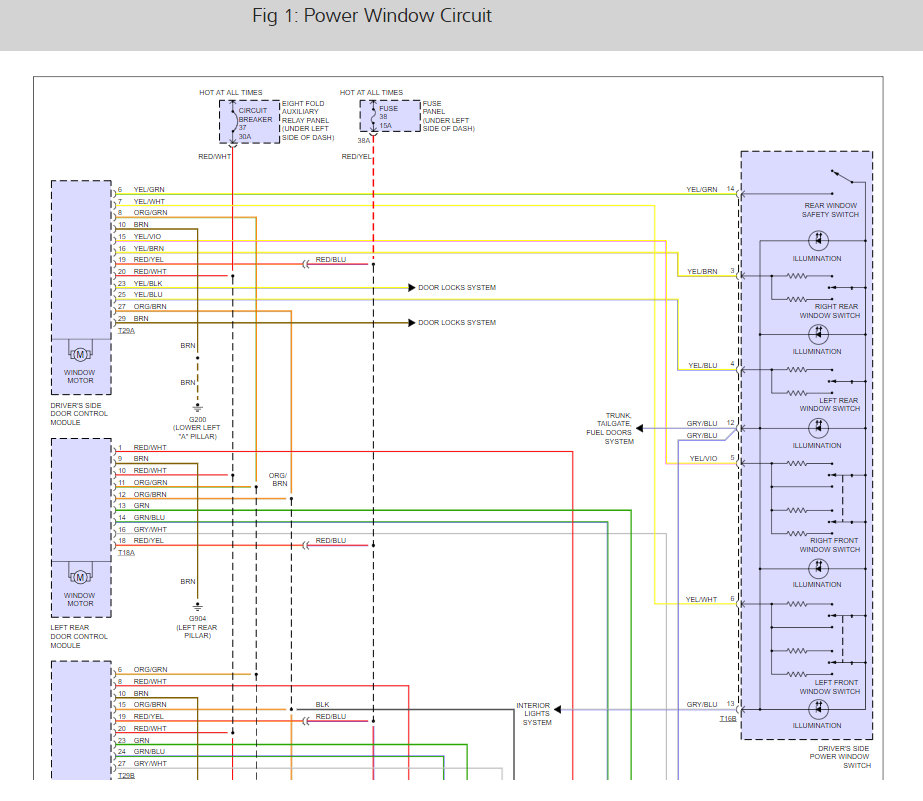

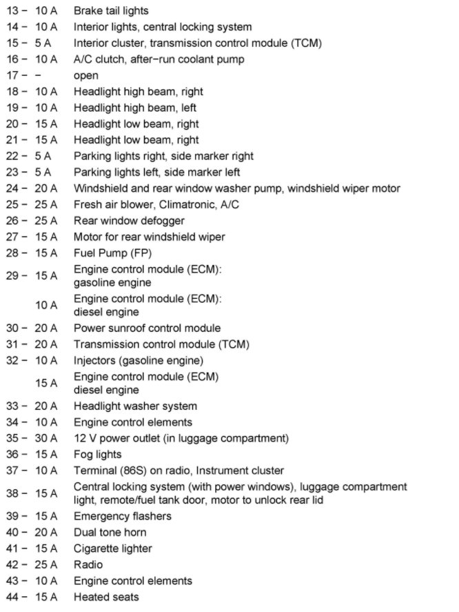

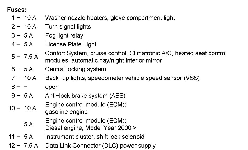

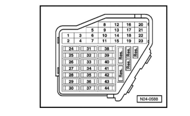

I would check the fuse first and if okay it sounds like the drivers door module has gone out which you might need to get programmed which will cost about $130.00 at a shop. Here is the window wiring diagrams and the door module location so you can change it out. I would try a used unit it might plug and play.
Here is a guide to help check the fuse and the wiring diagrams so you can see how the system works:
