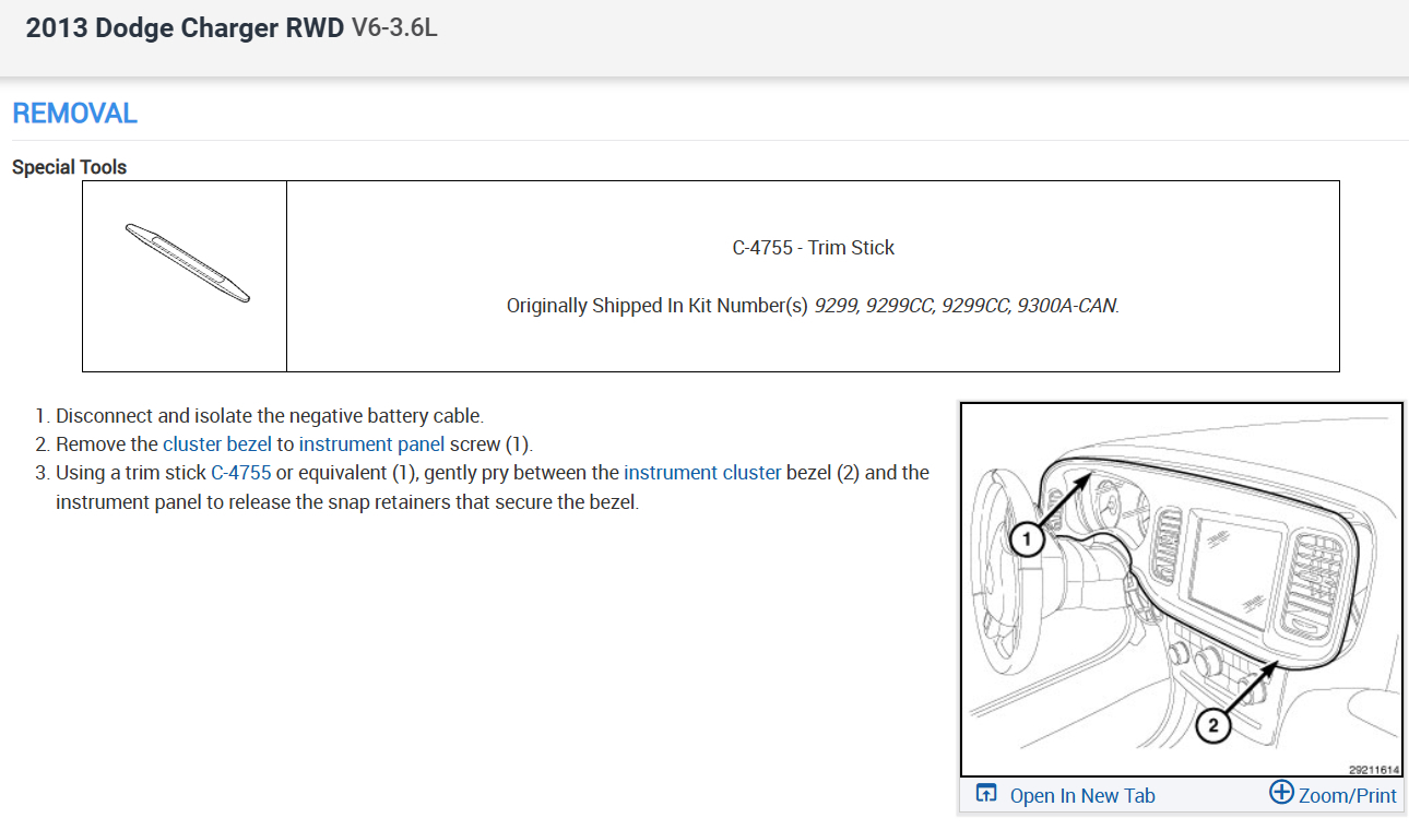

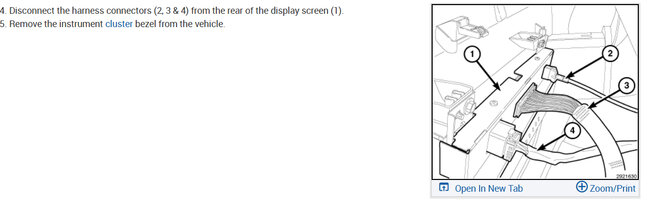

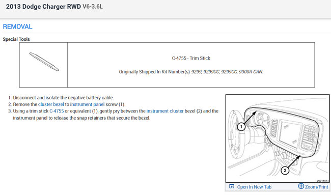

Yep, the cold weather can cause all kinds of strange things to happen to the electronics. I would just run it to see if these get better in the warmer weather though it could be the dash panel LCD is going out. If this is the case, you will need to get a rebuilt unit by searching Google or Ebay. Here is how to change the cluster out in case you want to go that way. Check out the images (below). Please let us know what happens.
Jan 23, 2025 at 11:51 AM

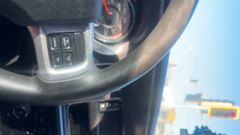

I finally got a video of what it’s doing this should better help explain my situation.
Jan 23, 2025 at 12:19 PM

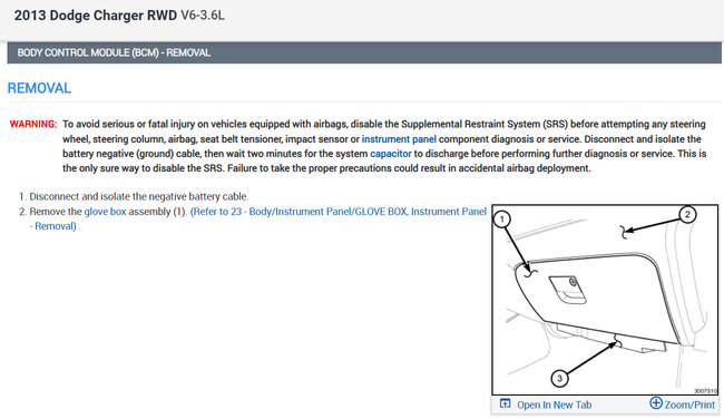

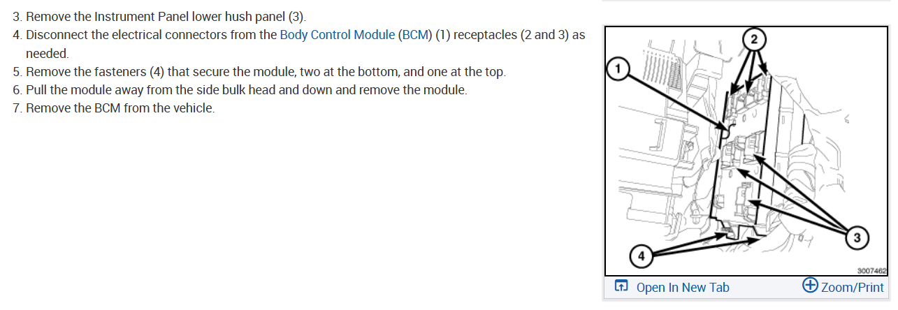

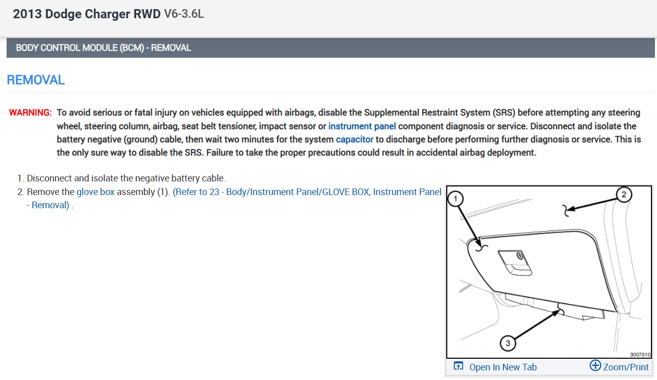

Wow, yep that is not the cluster, thanks for the video, this is either the BCM or the center stack module. I am thinking BCM but we should run a CAN scan to see what codes are stored, this video will help us. You can get a CAN scanner (Controller Area Network) which will work on most cars from Amazon.
Here is a video to show you how:
https://youtu.be/u-4syLc-ifQ
Here is how to change the BCM out in case codes are stored for it. You can get a preprogrammed unit by searching Google or Ebay. Check out the images (below). Please let us know what happens. Thanks for the video, it helped.
Jan 24, 2025 at 9:07 AM
