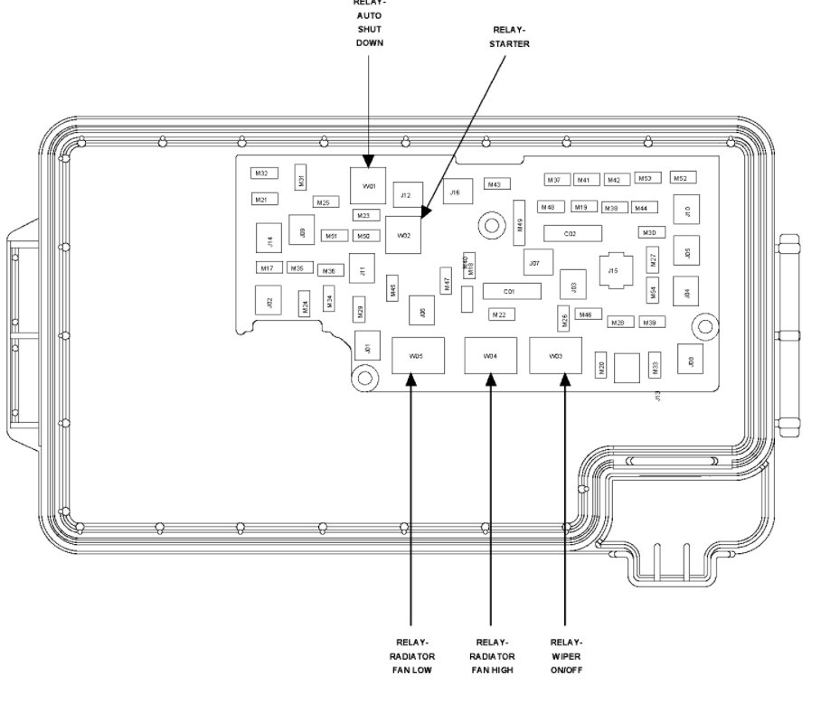

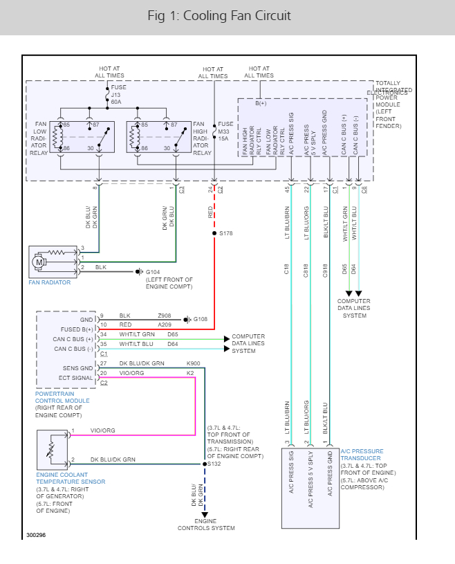

it could be the motor fuse (J13) or relay these guides will help us test the motor for power and ground and to check the fuse and relays, here is the cooling fan wiring diagrams so you can see how the system works. I have also included the fuse and relay location as well.
and
and
https://www.2carpros.com/articles/replace-electric-fan-motor
Check out the diagrams (Below). Let us know what happens and please upload pictures or videos of the problem.
