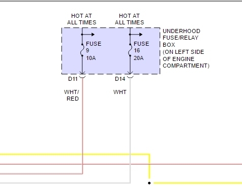

Shop had my car to recharge the AC system two weeks ago. Now the electric locks do not work. The shop had a key but not the fob. Usually the fob signal is not recognized. If it is, wont lock/unlock the doors. The switch on the drivers side does not control any of the locks now. This was all working fine before the place had my car.

It looks like the fuse could have gone out, please follow this wiring diagram to check the fuse.
Please let us know what you find so it will help others.

Where should I send the check:-) The idiot at the shop needed one and removed it! Thank you.
