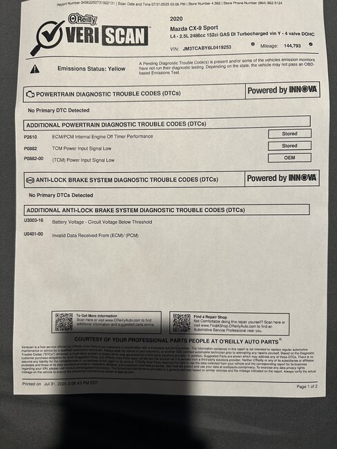

MATTIE154
Thanks for getting back to me. I actually did take my car to o’Reilly auto parts and they did a test. I have attached below what the test showed. Thanks so much for being willing to help me because I have no idea. lol
Aug 2, 2025 at 10:29 AM

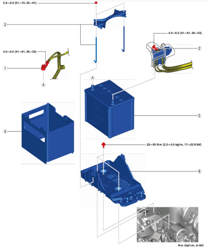

Okay, the big code that stands out is the battery below threshold. So I would remove the battery and take it to the auto parts store for testing. Then I would clear the codes to see what happens. This guide will show you how with instructions below to help with your car.
https://www.2carpros.com/articles/how-to-replace-a-car-battery
