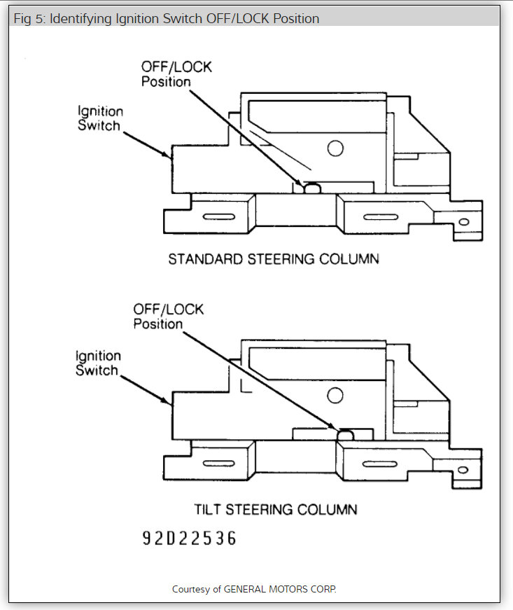

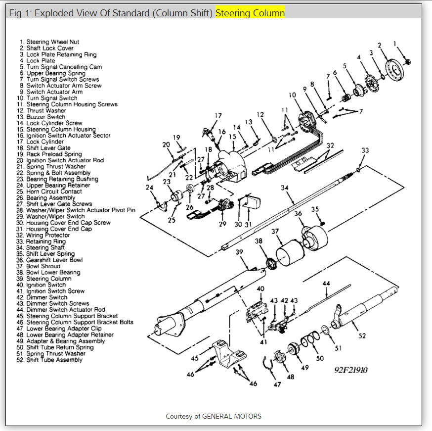

Yep, if you can move wires around under the steering column it sounds like the switch is bad, I would replace it and check the wiring connections at the switch. Check out the diagrams (below). Please let us know what you find.
