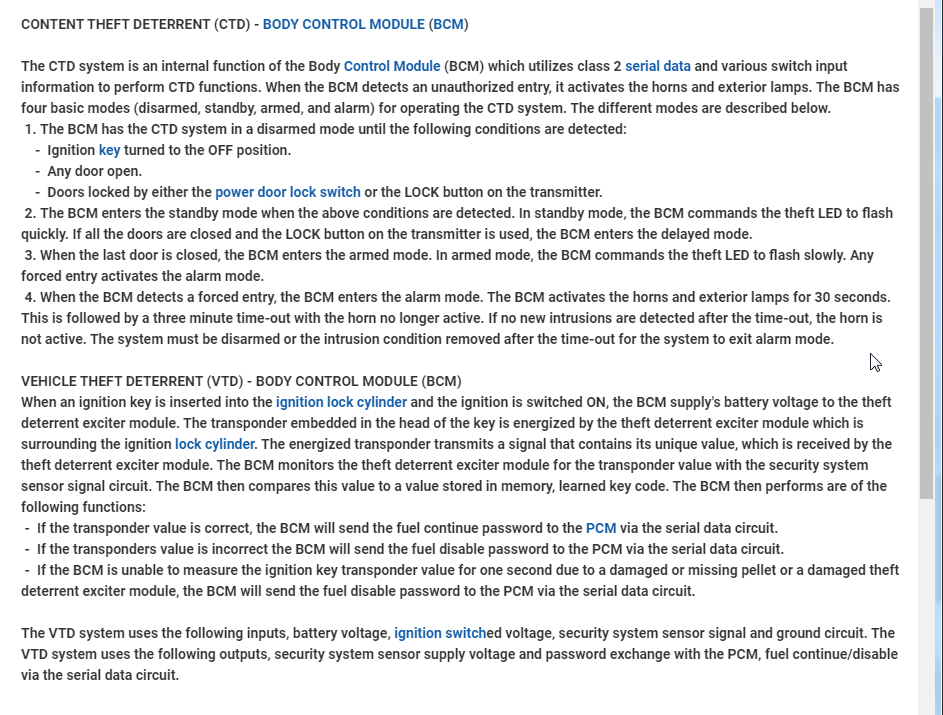

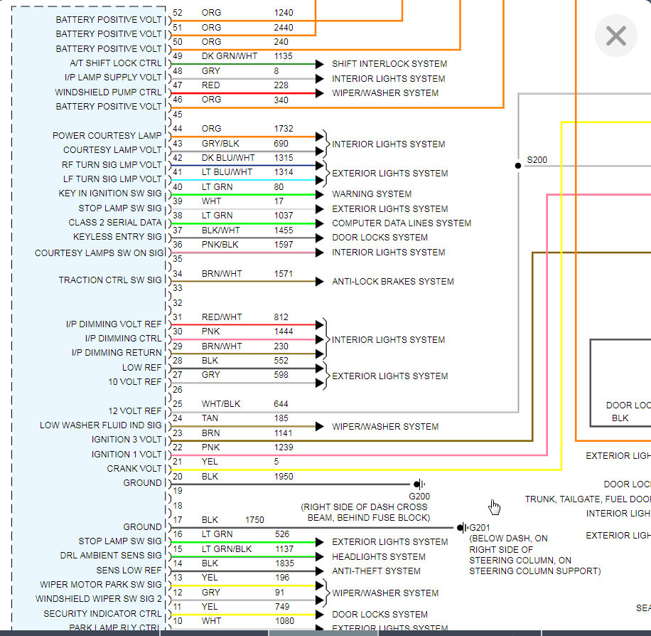

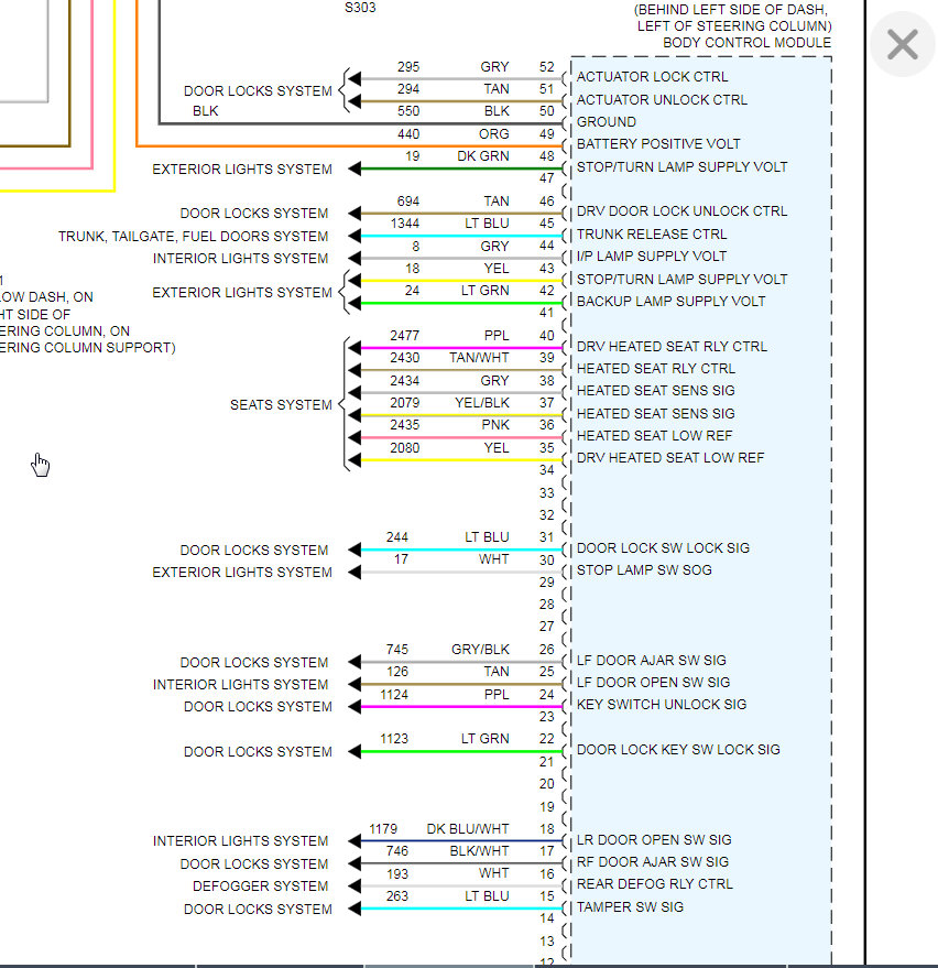

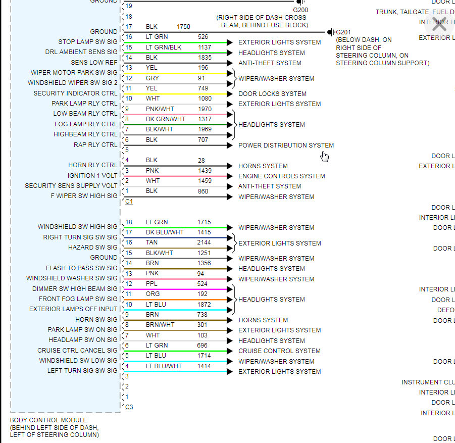

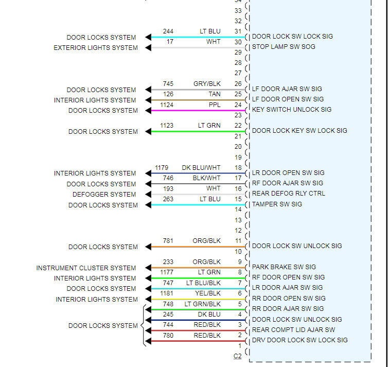

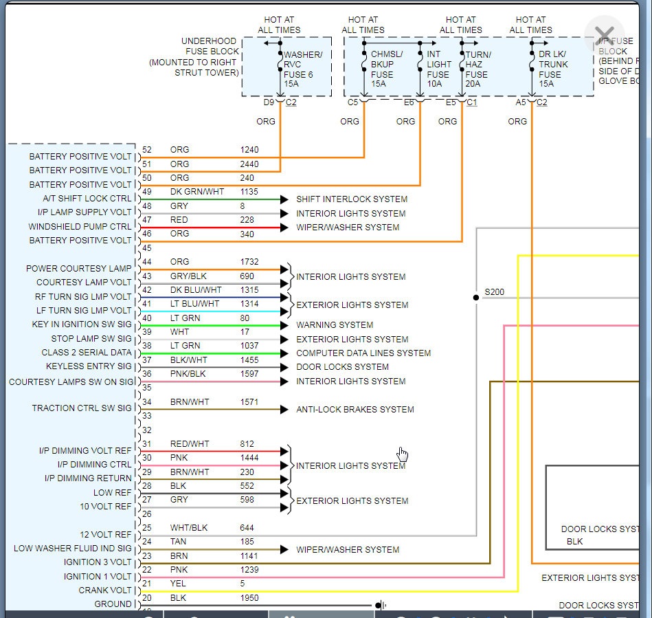

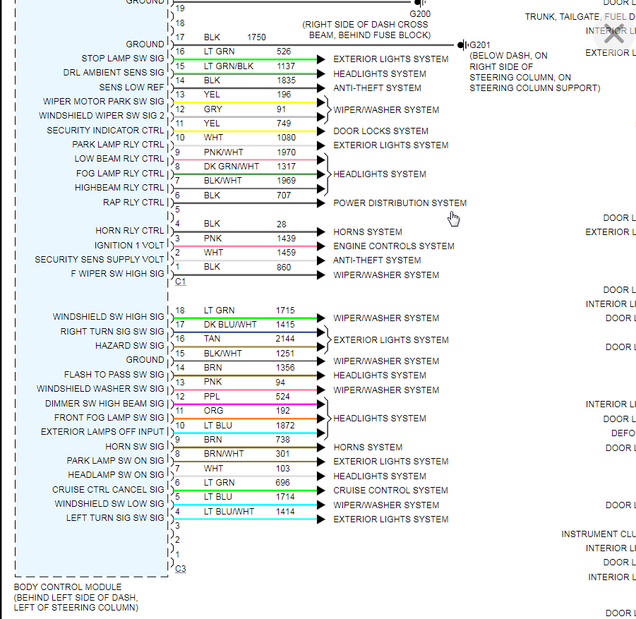

Did all of these items stop working at the same time? I am not convinced this is all one cause but if it were, it would be the BCM. I attached the info about the BCM. As you can see with the wiring diagram that the systems are run through the BCM. Clearly we will need to check fuses to the BCM but this would be the common denominator with all these items.
Let's check for codes and then go from there. Thanks
