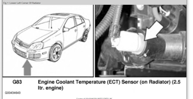

The fans not turning. I disconnected the temperature sensor and both fans start tuning on high speed. Do I have to replace the sensor?
Jun 22, 2019 at 9:22 PM

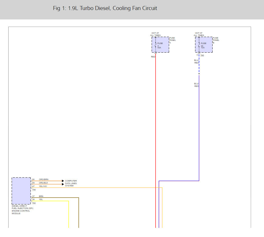

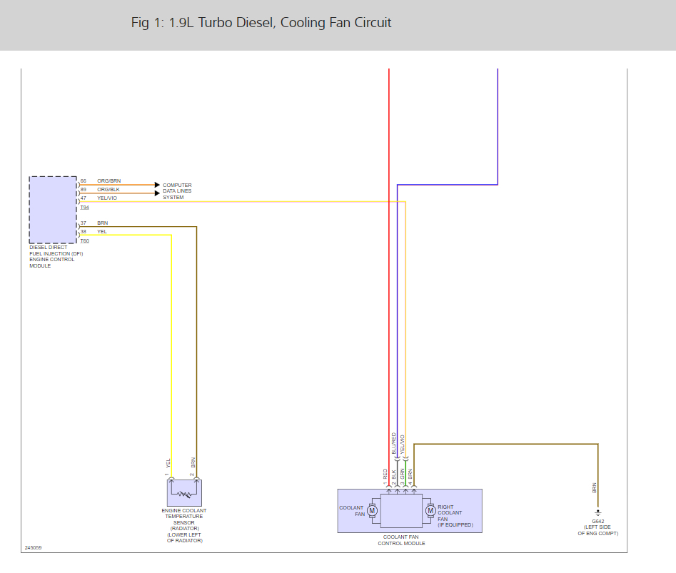

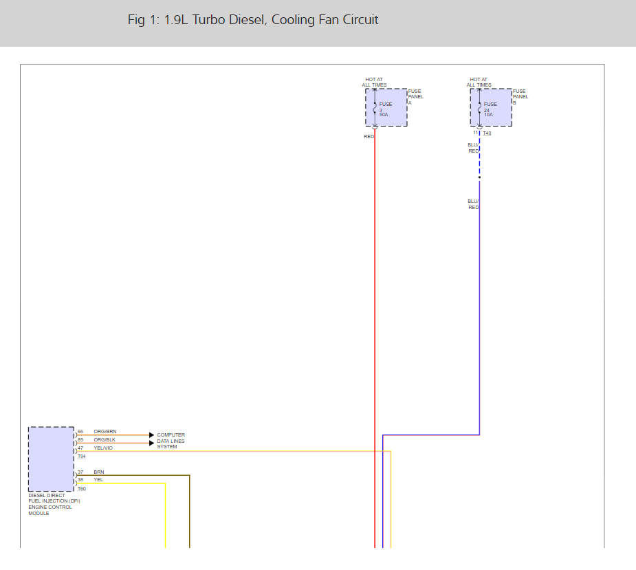

There is a sensor in the lower corner of the radiator that sounds like it has gone bad. here is the cooling fan wiring diagrams so you can see how the system works. Check out the diagrams (below). Please let us know what you find. We are interested to see what it is.
