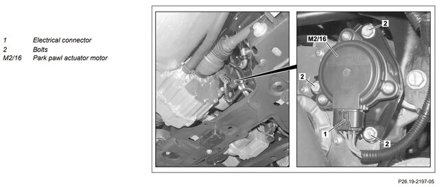

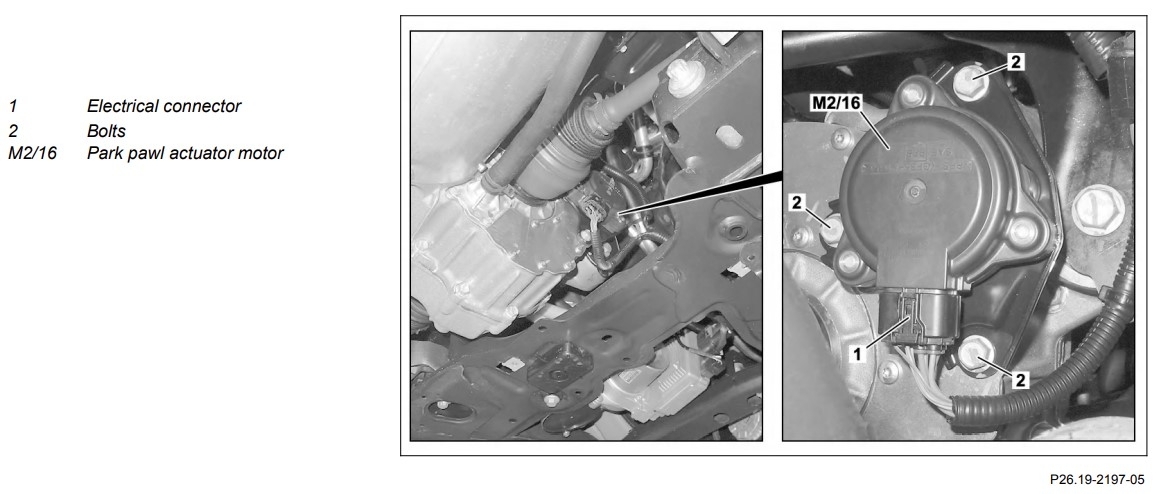

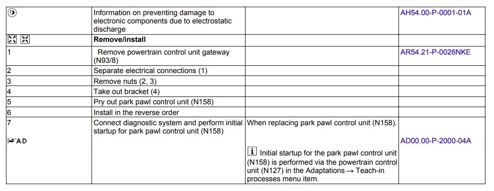

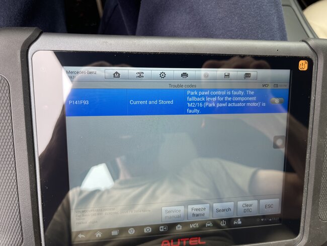

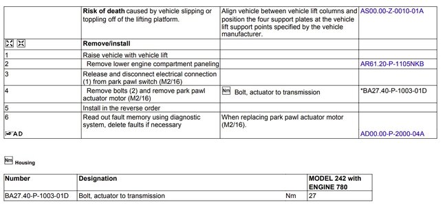

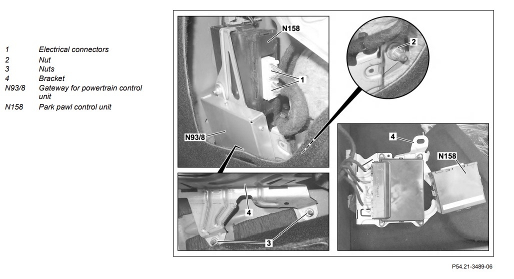

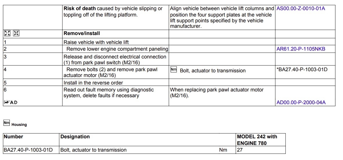

This is a 14 b-class electric drive, no start, 12v battery was close to sead so installed a new ine and all lights on dash okay. The only code i can pull is p141f93, am sure very few people have these cars or worked on them but worth a shot.
