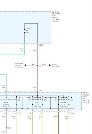

The first thing I want you to check is fuse 18 in the interior under dash fuse panel. It provides power to the windows and radio. I attached a section of the wiring schematic so you can see how it ties in with the two things I mentioned. Although a fuse can look good, it can actually be bad. Here are a couple links that discuss checking the fuse, checking for power to the circuit, how to use a test light, checking wiring.
