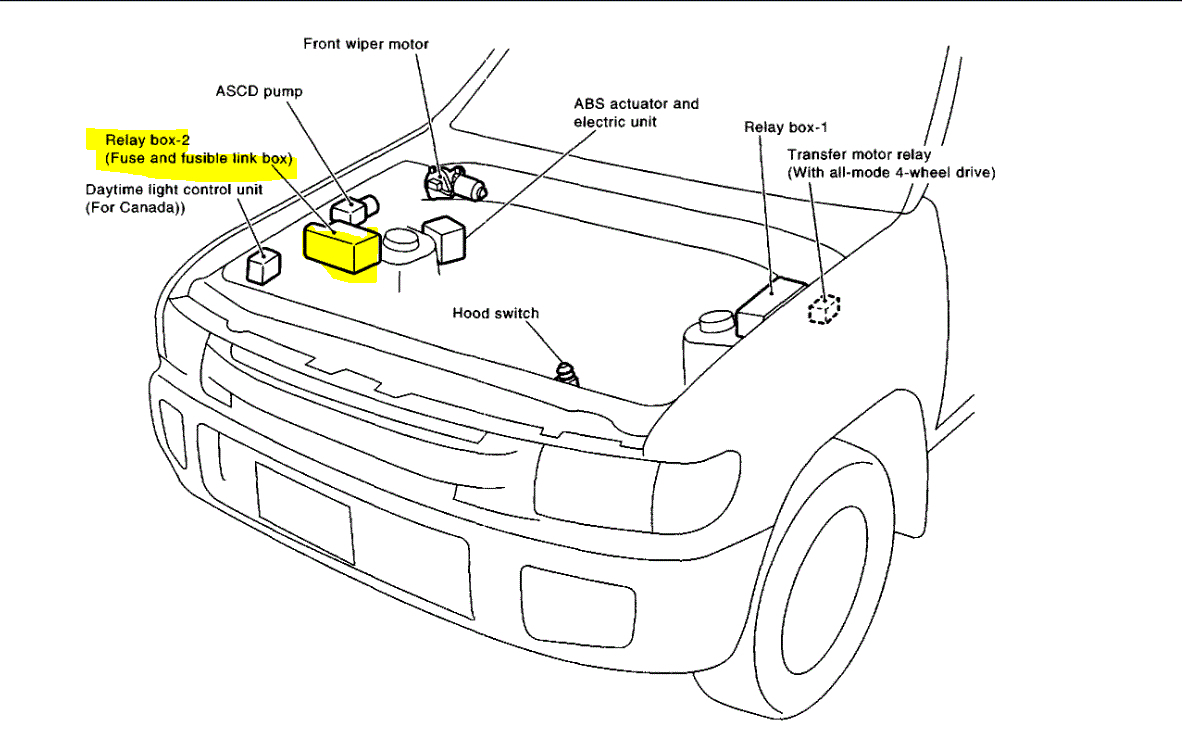

If nothing is working, I need you to locate the fuse/fusible link box under the hood. See pic 1 below for the location.

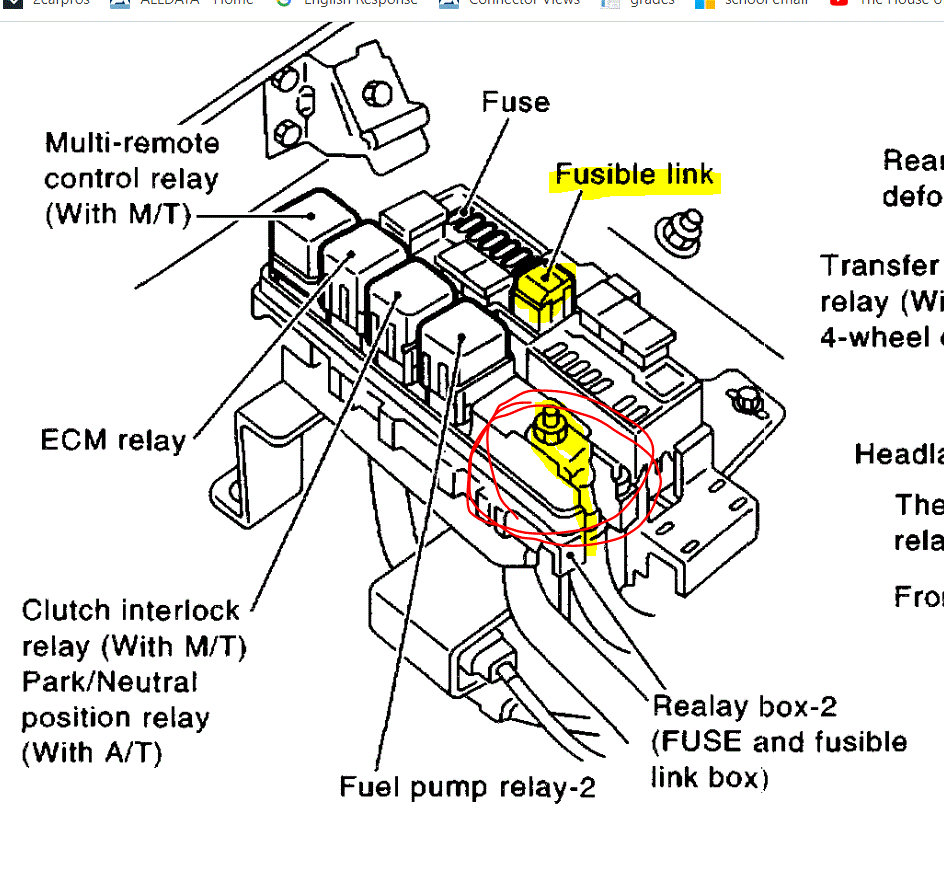

Next, in pic 2, I highlighted a fusible link that I need to be checked. A fusible link is basically a fuse but is designed differently to do the same thing. Confirm it is good. Also, confirm there is power to and from it.
Also in pic 2, I highlighted and circled the power supply wire to the box. Simply confirm there is 12v present on that wire/bolt. You can use a test light, multimeter, or voltmeter.

I've found the fuse box and the fuse was bad. But I also found corrosion everything from the battery post to the starter.
Jun 30, 2021 at 10:14 AM
Make sure the battery is disconnected and then do your best to clean everything. Once you get the corrosion off the connections, use dielectric grease where the connection is made. That will help produce a good connection and prevent corrosion.
Interestingly, the corrosion may have been the cause of the fuse issue. When there isn't a good connection, there is more heat and energy draw. As crazy as it sounds, that may have done it.
