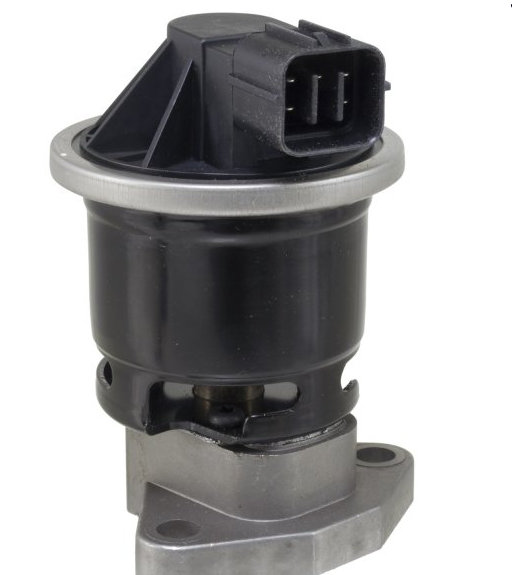

Can you get pictures of each of these items? I am thinking we are mistaking the EGR for something else because there should only be an electrical connector going to the valve. I attached a picture of the part just to confirm we are talking about the same thing.

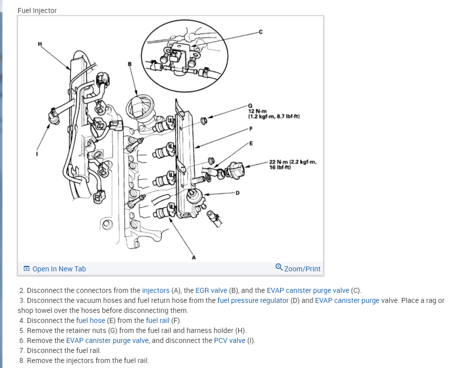

As for the fuel rail, you may have the return line or vacuum line still unhooked. I attached the detail about the rail and injectors. Let me know if you still can't find it and pictures would be great to help with this. Thanks

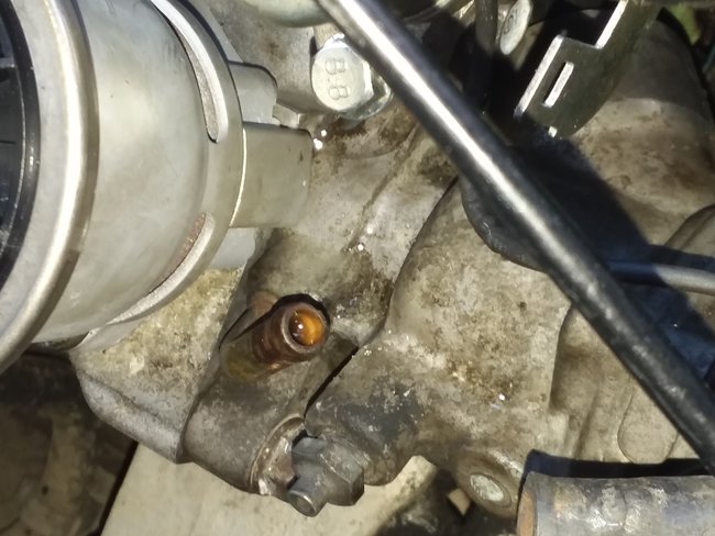

It's where EGR sits there is a small one and also one on fuel rail (don't have that pic).
Sep 5, 2020 at 9:11 AM
Okay, thanks. Can you get a picture from a little further away? Is that in the manifold or the cylinder head? It is just a little tough to orient where that is.
Sep 5, 2020 at 7:16 PM
STACY ZIMMERMAN
  • 26 POSTS
Okay, figured it out. Went to salvage yard. The hose by the EGR valve goes to just under the throttle body part. It takes water to there looks like. It's the bottom hose that is also connected to another same size hose an it goes into the plastic intake tube.
The fuel rail one goes behind the intake an has a metal tube connecting (a splice like tube for heat resistance).
