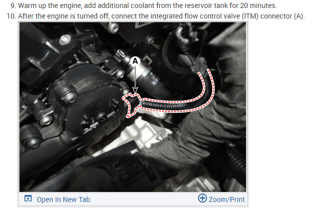

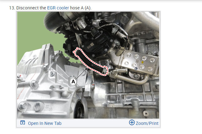

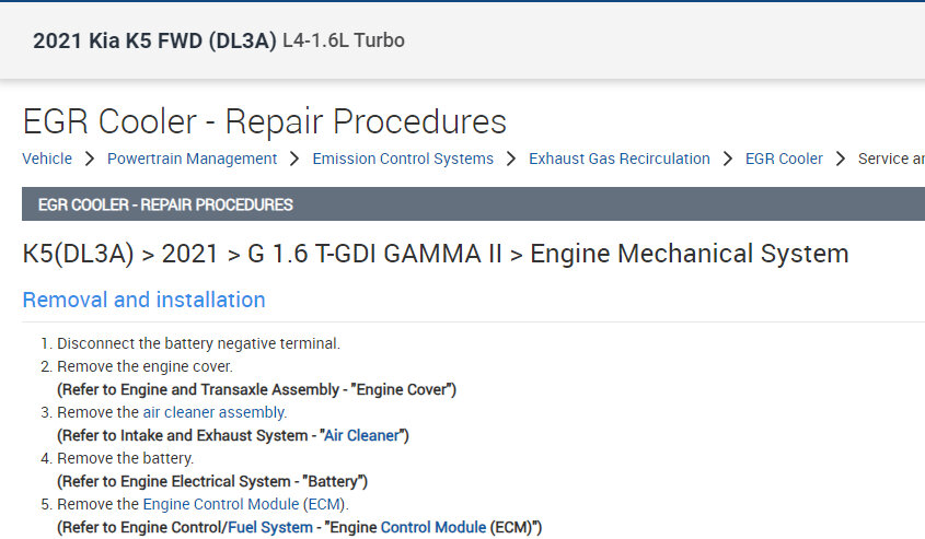

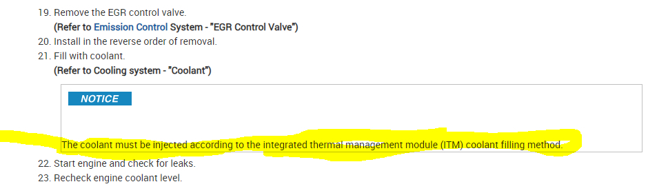

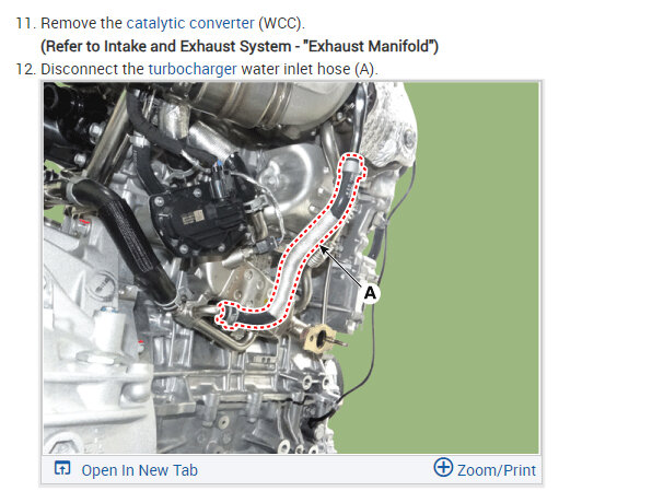

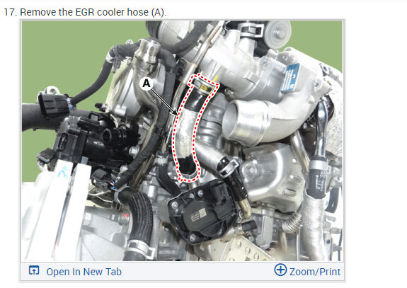

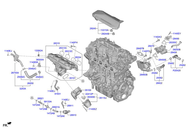

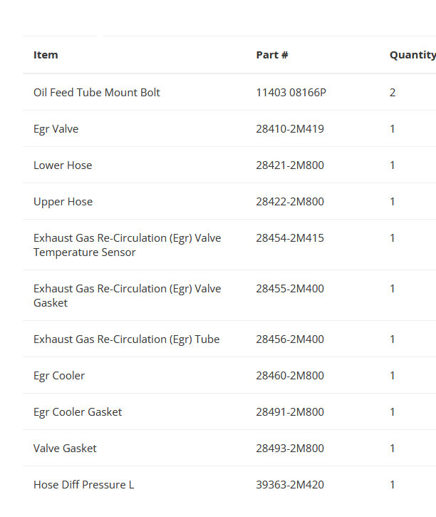

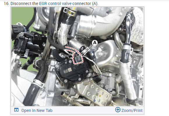

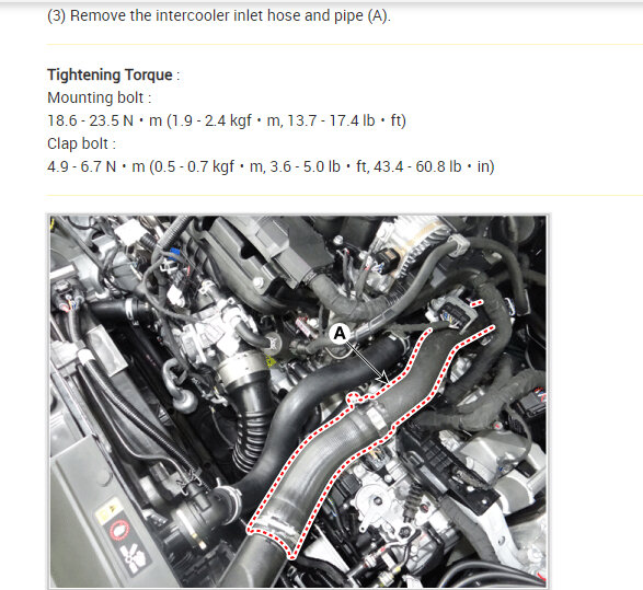

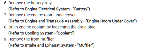

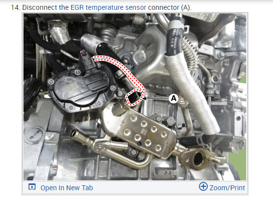

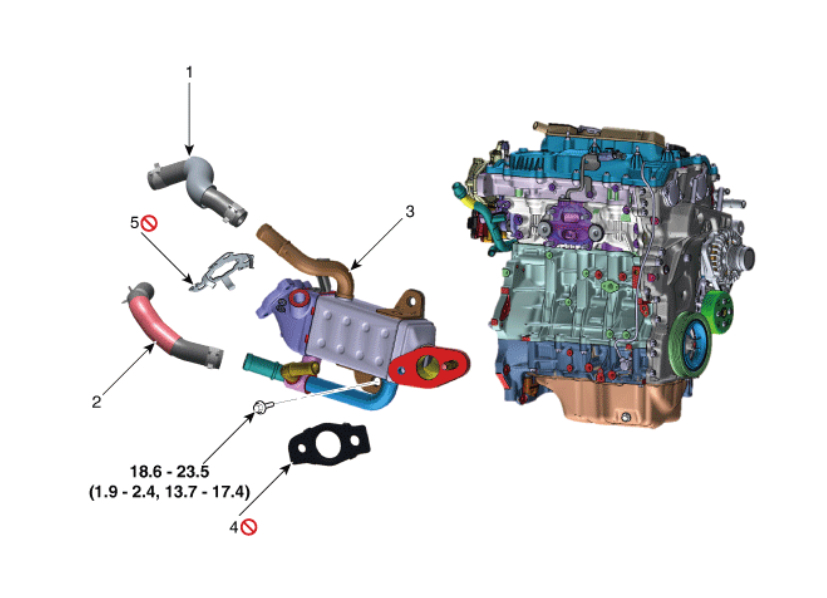

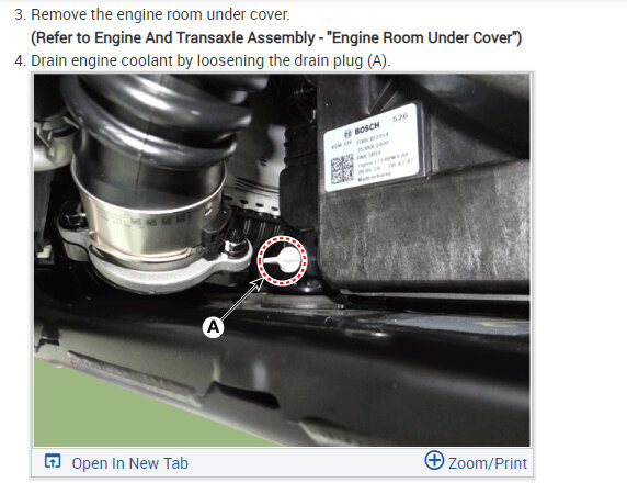

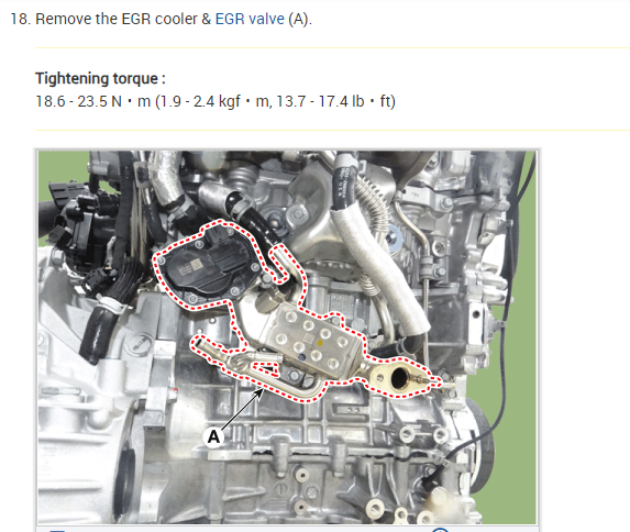

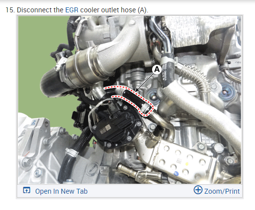

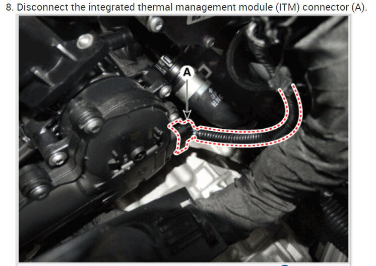

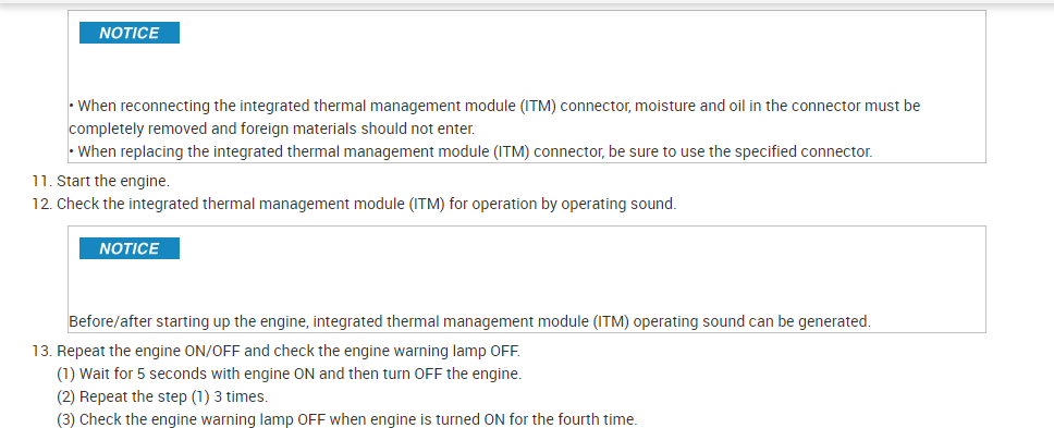

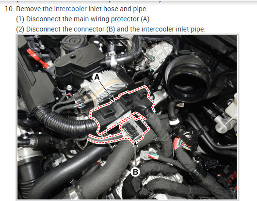

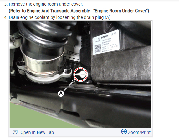

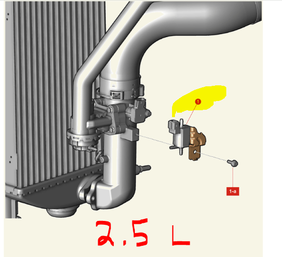

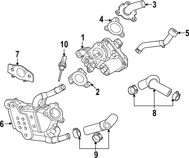

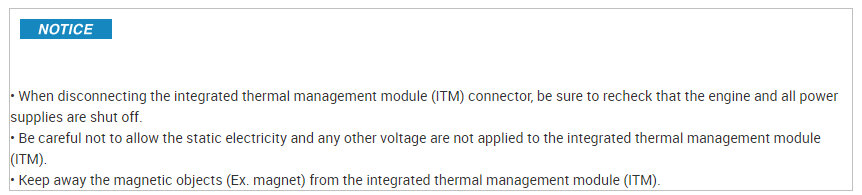

I attached directions for replacing the EGR cooler which includes the EGR valve. Based on the list you provided as ordered parts, it looks like you are doing it all.

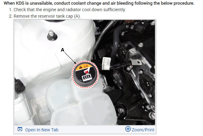

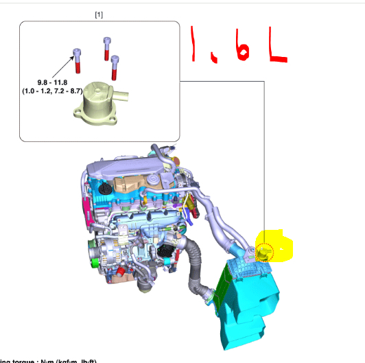

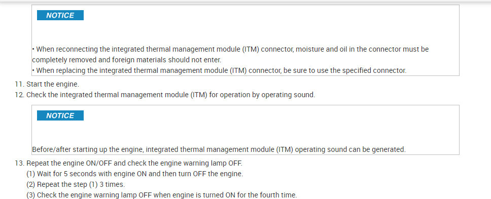

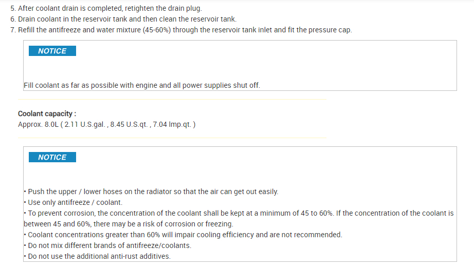

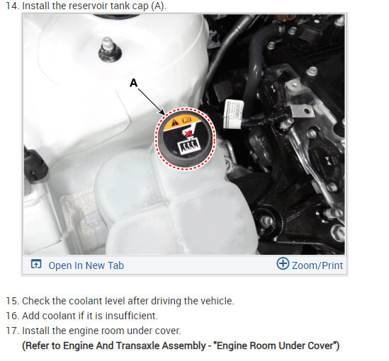

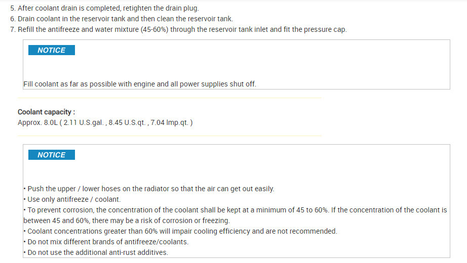

Take a look and let me know if this helps. Also, bleeding air from the cooling system seems to be somewhat of a nightmare. They have directions using Kia's specific scan tool and without that tool. I did attach the bleed procedure without the tool for you.
Take care and I hope you are sitting down when you read this. LOL
See pics below.
