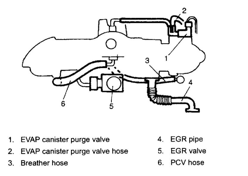

Where do I find the EGR valve on my car listed above?
Mar 4, 2018 at 3:29 PM
Good morning.
I attached a picture of the EGR valve location for you to view.

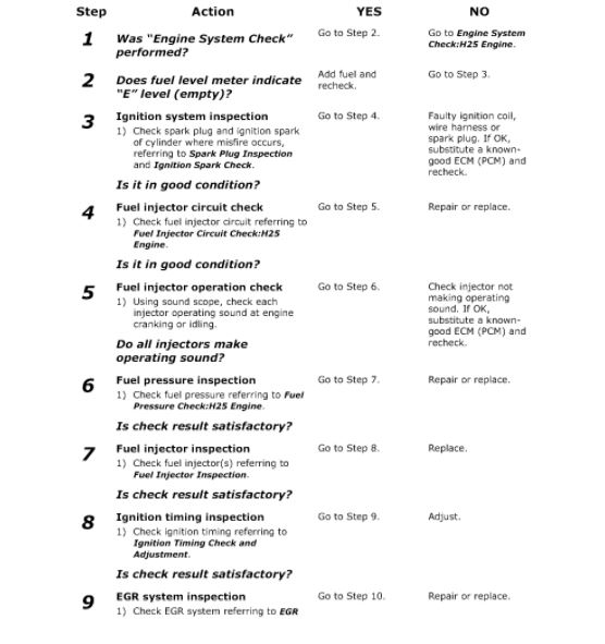

vehicle has a P0300 code, random misfire, vehicle stalled out at a traffic light.
Mar 5, 2018 at 6:33 AM

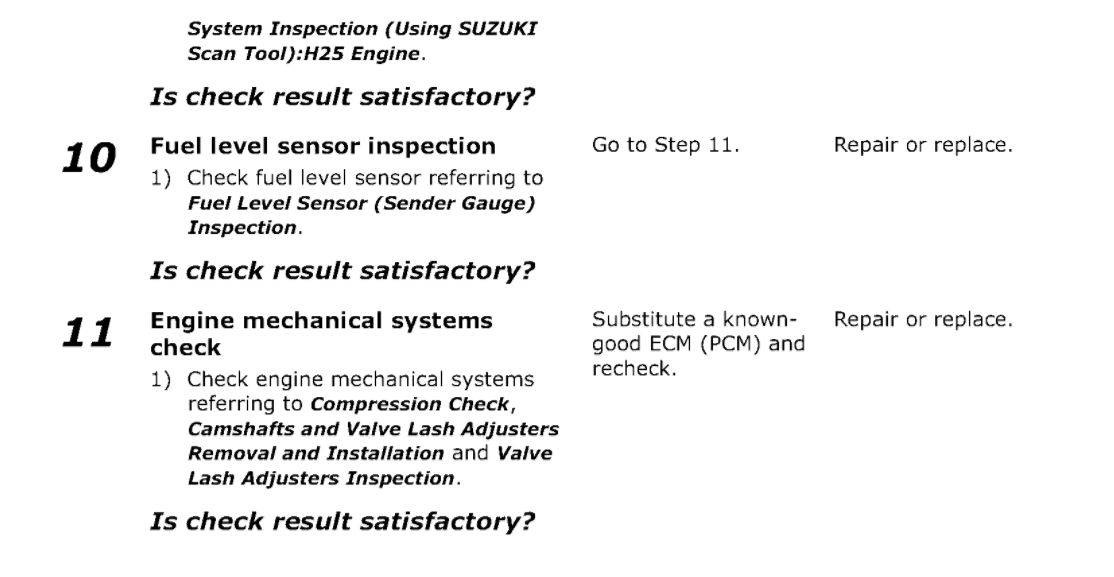

Okay, I attached a flow chart for checks needed for this code. The most common reason for this code is low fuel pressure from a bad fuel pump, but it needs to be confirmed with a fuel pressure test. if you do not have a tester, you can rent one at a parts store.
