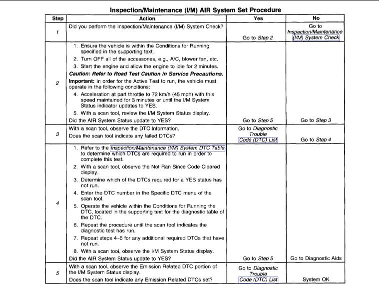

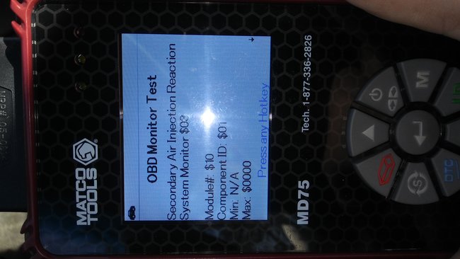

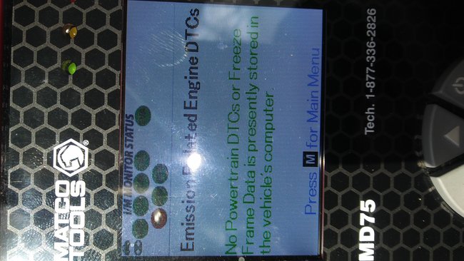

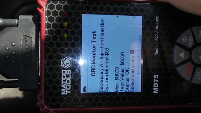

Have replaced the pump, solenoid valve, shutoff valve, check valve, and catalytic converter. Secondary air still showing not ready on scan tool. Everything else is green (ready).I also replaced the inline vacuum delay valve. Did I miss something? I cannot find the EGR valve. Does it have one? The truck has had several cold starts and air still not ready. I can hear the pump run when it starts up. What else can I do?
