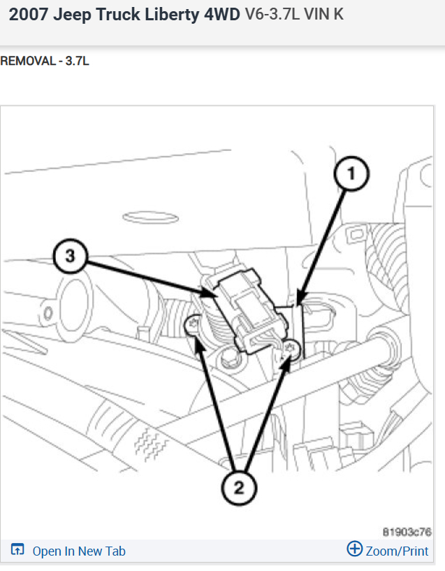

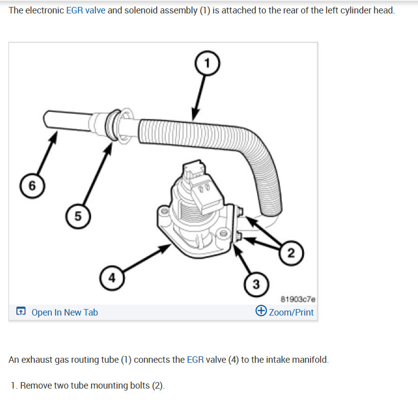

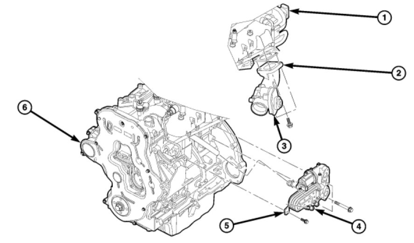

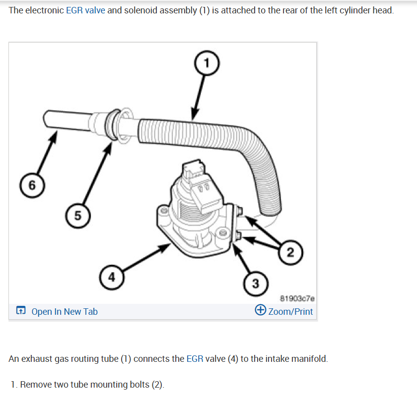

This sounds like the throttle body needs to be serviced. can I ask what the code number is? Here is a guide that you can go over that talks about engine hesitation, and I have included how to service the throttle body and where the EGR valve is.
https://www.2carpros.com/articles/engine-hesitates

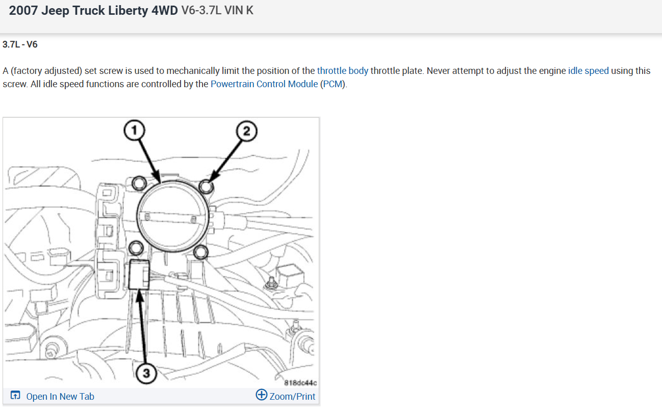

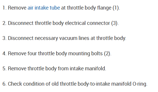

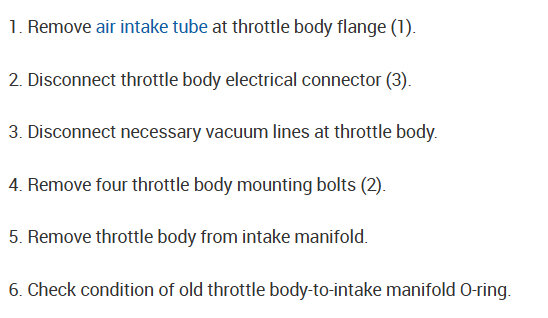

This guide can show you how to service the throttle body:
Check out the images (below). Please upload pictures or videos in your response of any problems so we can see what to help you with.
