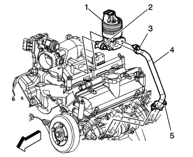

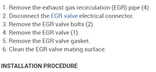

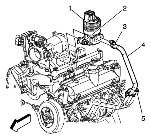

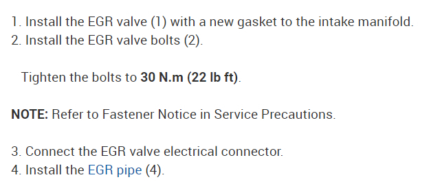

Did you use new gaskets and tighten the bolts to the proper torque on the EGR valve? I've attached picture replacement steps below. Hope this helps and thanks for using 2CarPros.
