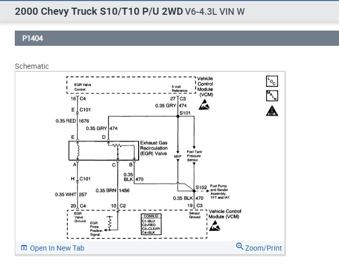

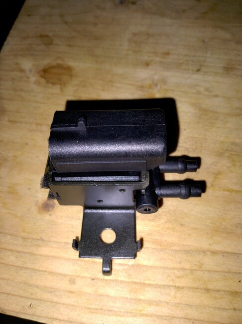

does the vehicle listed above w vin have an EGR vacuum solenoid and if so, where is the location? p1404 code came up i have replaced the EGR valve with a new one i disconnected battery still comes up. i unplugged the EGR valve erased code, turned off key plugged back in still same problem, so I was curious if there was secondary EGR vacuum solenoid. Pictured below is EGR vacuum solenoid AutoZone sold to me.
