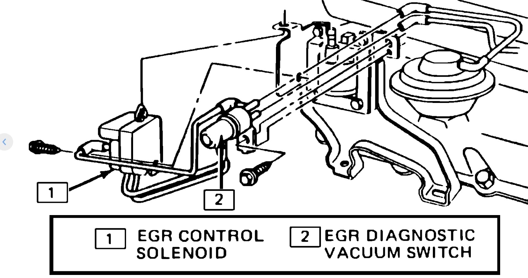

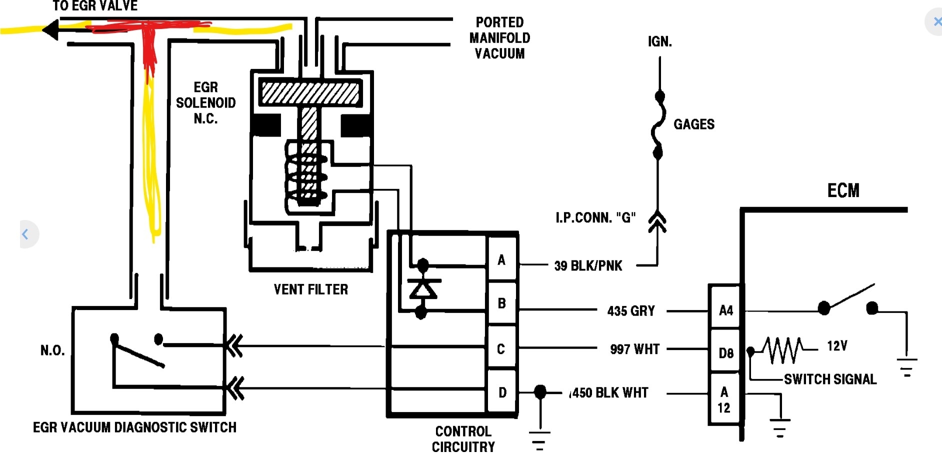

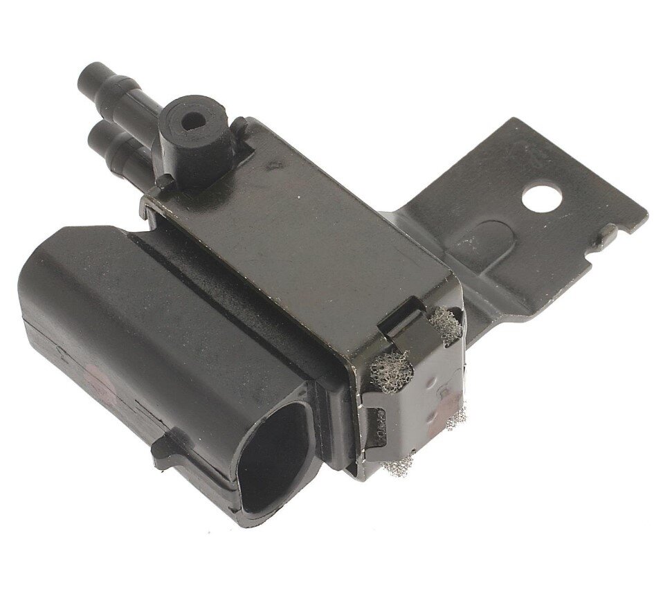

If you mean the electric solenoid that is in the vacuum line, the 2.8 version should have 3 vacuum lines on it. One comes from the manifold to the solenoid, then there should be one going to the EGR plus another on that same outlet that goes back to the controller and triggers the vacuum switch in it. The V8 version only has 2 connections on it so they are not interchangeable. However, it might be possible to make the V8 version work if you used pieces removed from the 2.8 version and added a T fitting to the line going to the EGR.

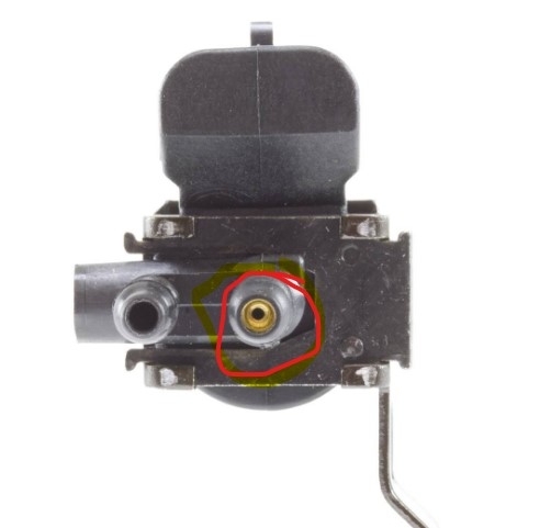

Basically, the T would replace the built in connection on the 2.8 version. The only other issue would be if they used an orifice in the vacuum inlet side. I believe the V8 did but not sure with the 2.8. It would be visible looking into the ports that are on the valve like the last image. Note how GM actually used a very similar valve but blocked the other port on the V8 version. The T would add that port back.
