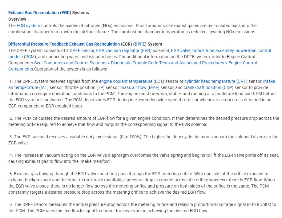

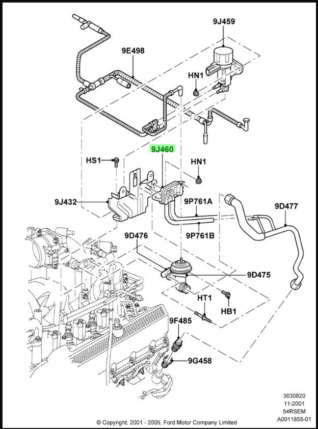

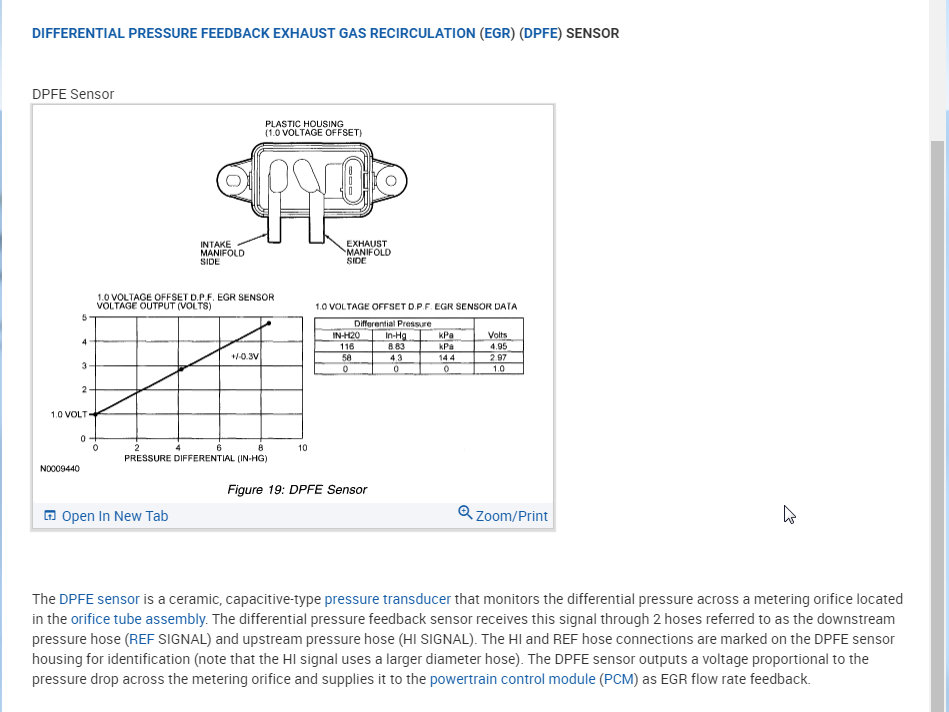

I assume you mean the differential pressure feedback exhaust gas recirc sensor. In other words the DPFE.
I attached the info for it. Let me know if you need something different. Thanks
