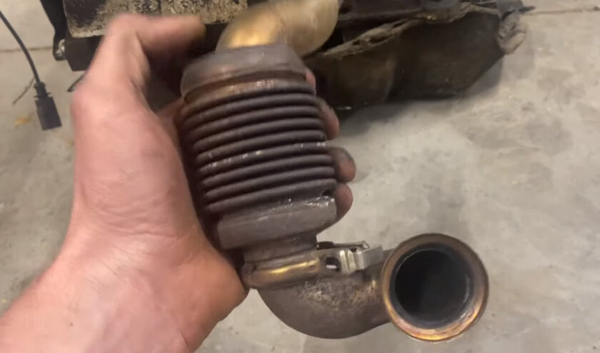

The most common issue for P0401 to set is a blocked EGR filter inside the tube from the DPF to the EGR cooler at the rear of the engine.
See image below.
