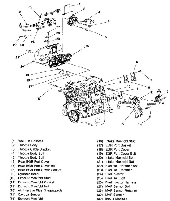

Where is the EGR valve on a 2000 chevy s10 pickup 2.2 liter? Does it have one?
Dec 20, 2018 at 3:18 PM

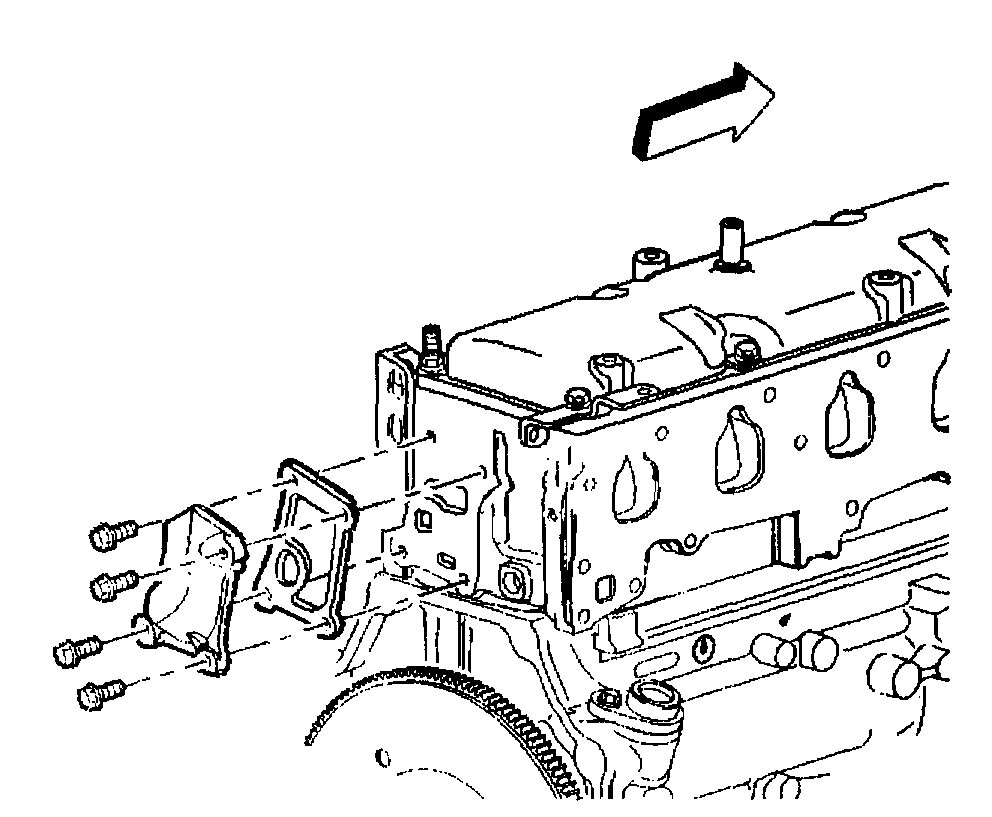

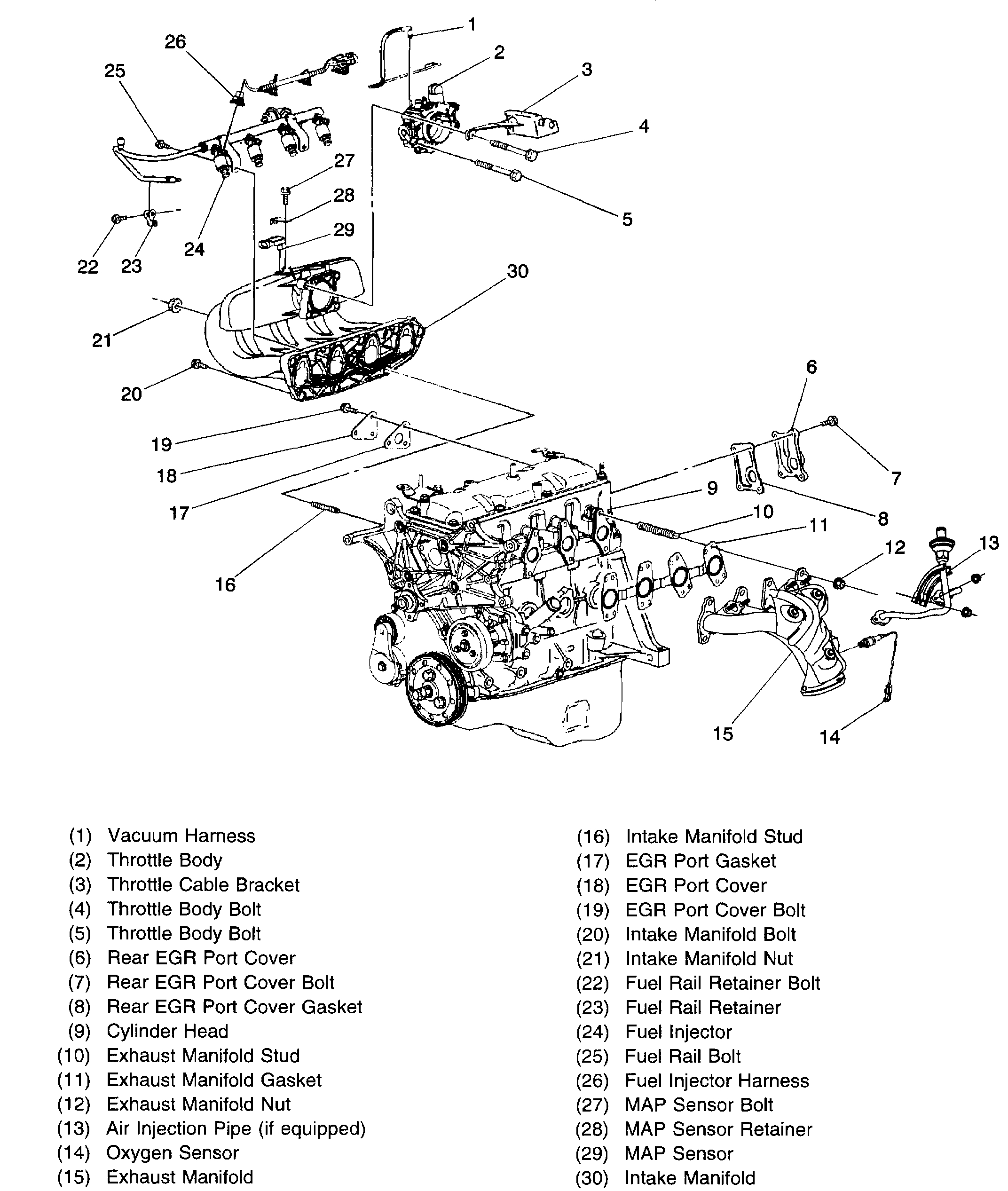

It is in the rear of the engine. You will need to remove a cover for access. I attached a picture of locations. It's not a traditional design. Check out the diagrams (Below). Please let us know if you need anything else to get the problem fixed.
Dec 20, 2018 at 7:08 PM
MAROONS90
Yes it helps. I see 17, 18 and 19 that look like the gasket for the EGR valve, is it located under the manifold on that side?
