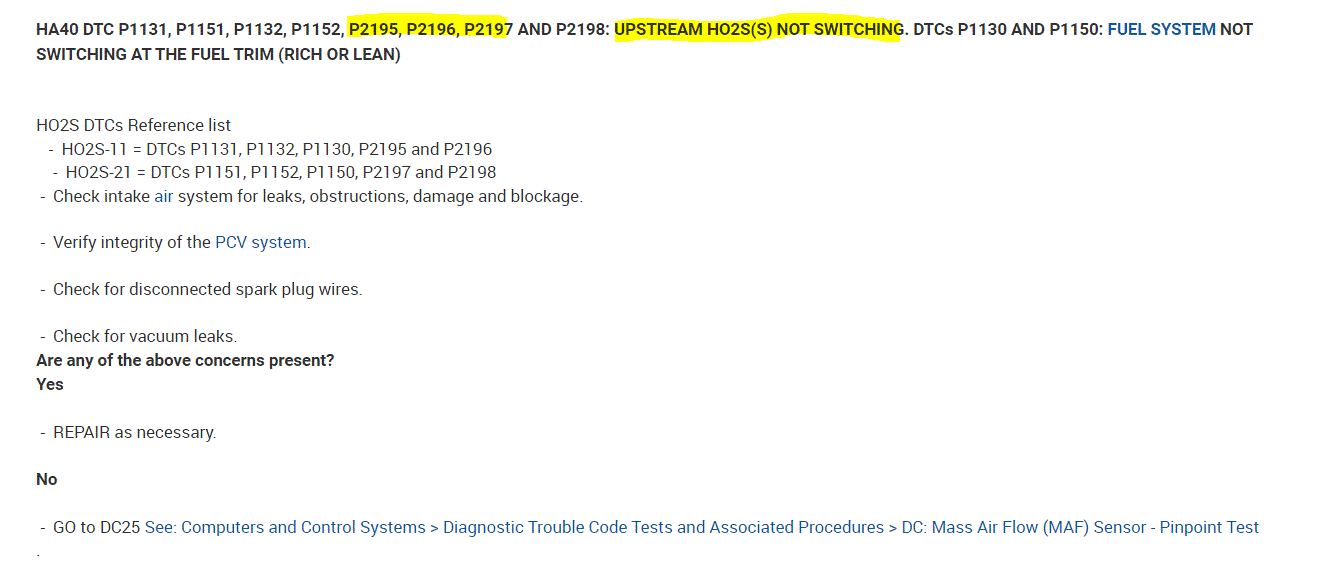

The codes are related to both upstream heated oxygen sensors. Take a look at pic 1 below.
Do you have a live data scan tool? If you do, first check the short-term fuel trims and let me know what they are. The problem could be a vacuum leak or related to high fuel pressure.
