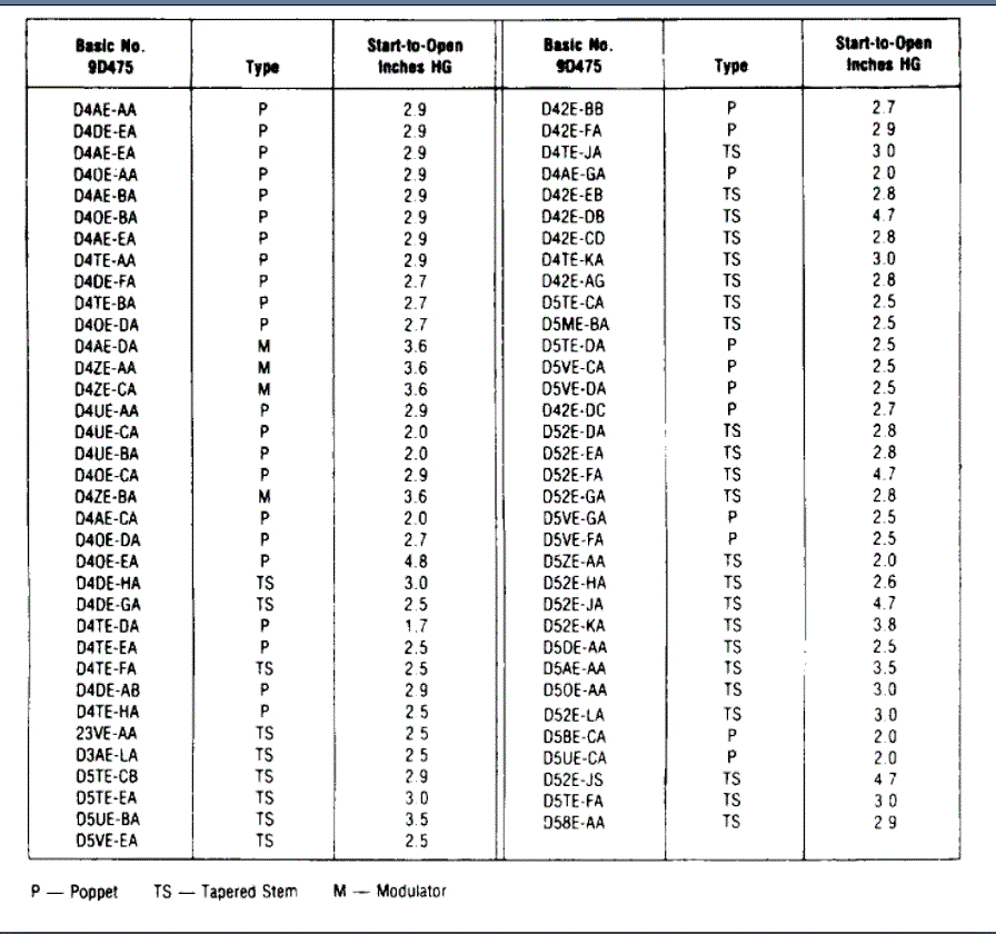

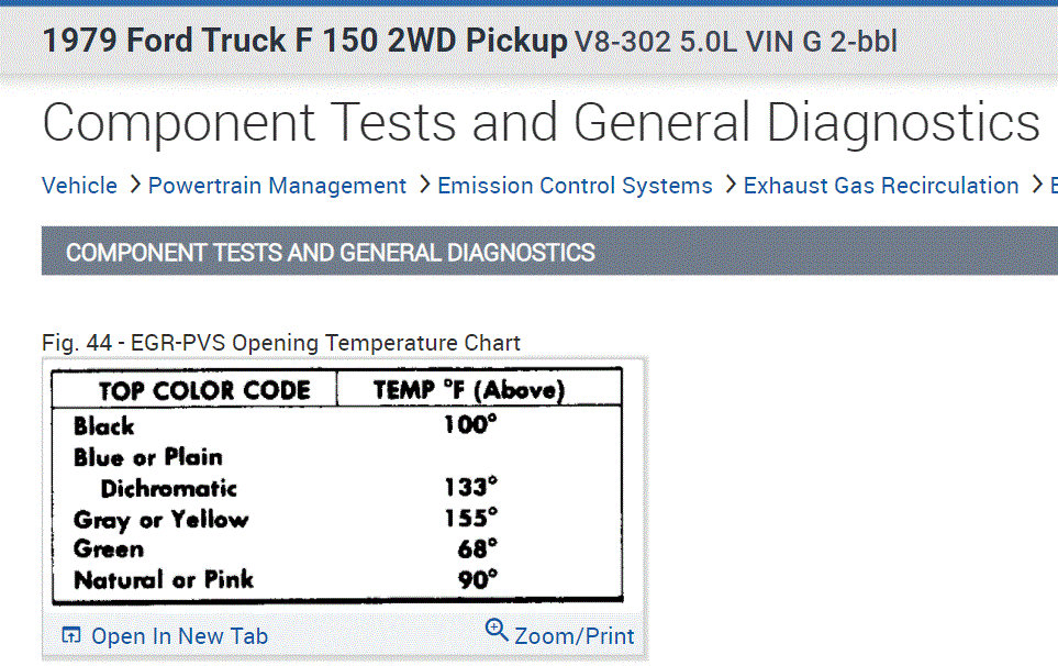

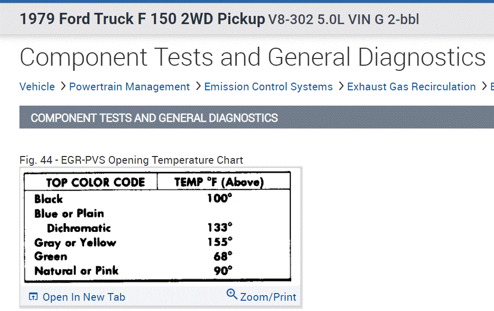

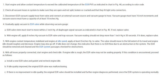

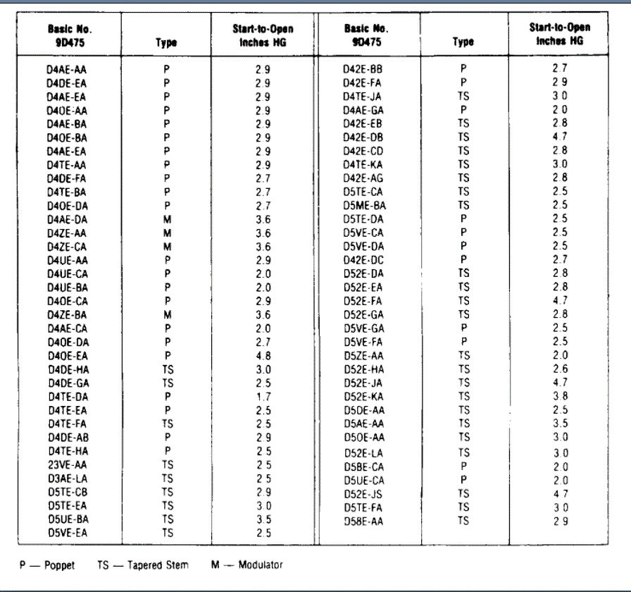

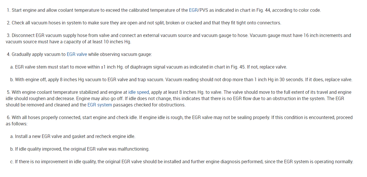

Take a look at the attachments below. They are the basic diagnostics for the EGR on this vehicle. Hopefully, they will help you.
Let me know what you find.
