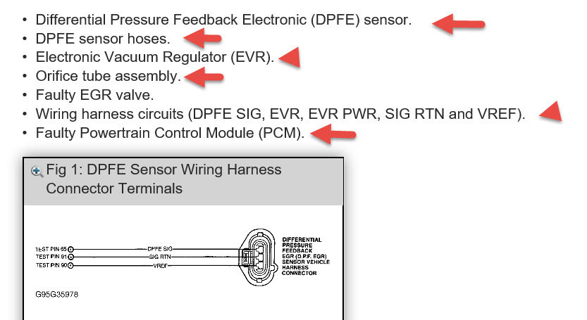

Have P0401 code EGR. I have changed the EGR valve, EGR solenoid and sensor. Still have the code.

if you do not use a scanner to erase it it will still be there forever. check items in picture like a vacuum leak or orifice tube plugged. see picture.
