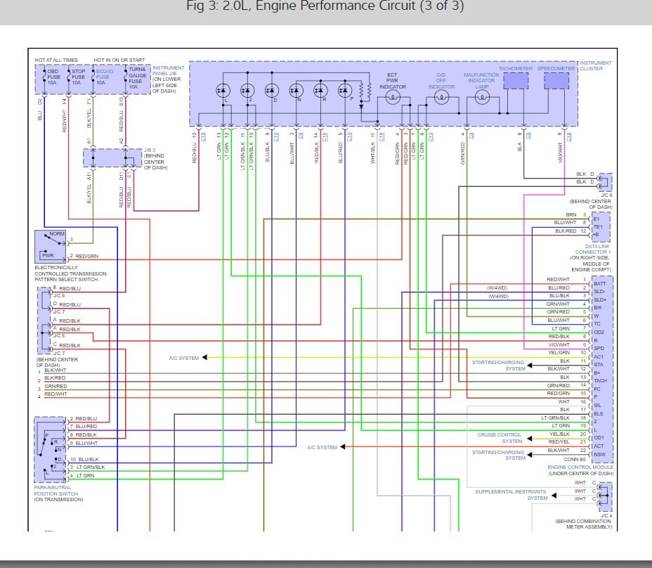

I need a wiring diagram to swap ECU 3S-FE into 1G-FE. Please help with all the information you have on that topic.
Sep 28, 2022 at 1:55 AM

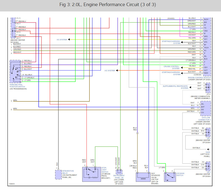

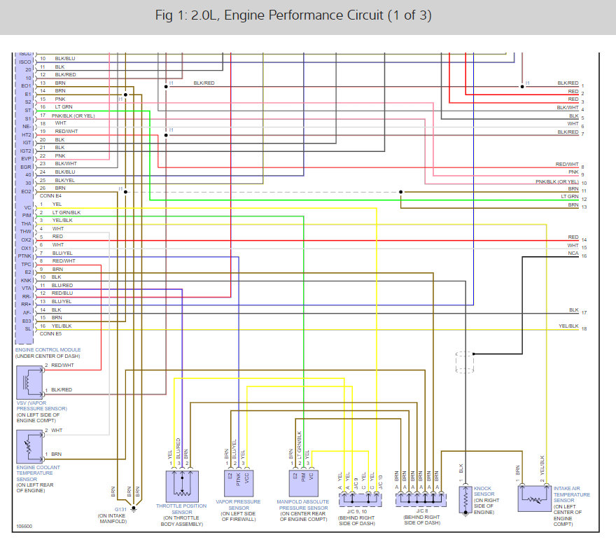

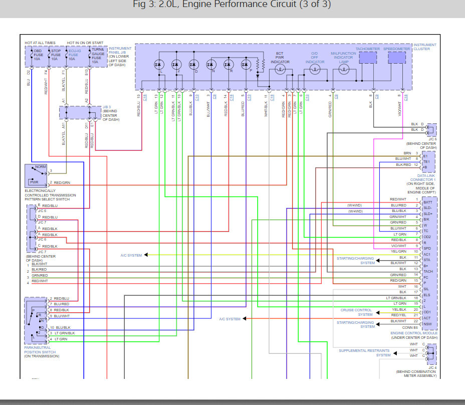

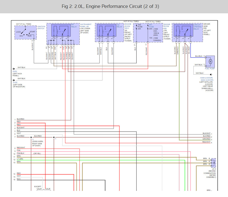

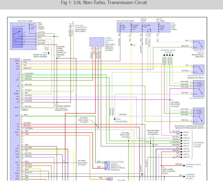

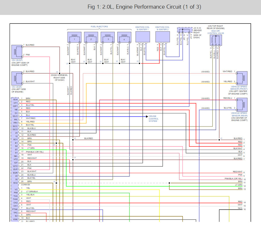

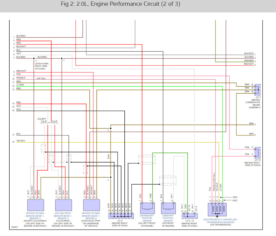

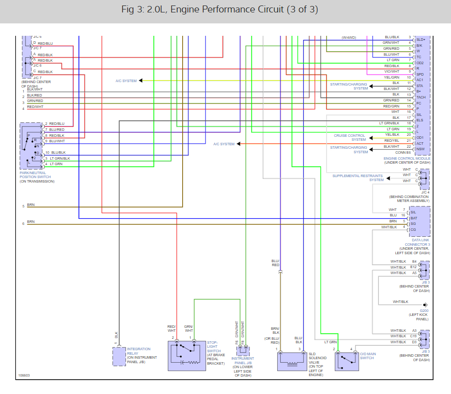

Yep, here are the engine and PCM wiring diagrams you have requested in the images below. Also, I have included a guide on how to check the wiring connections.
Check out the images (below). Please let us know if you need anything else to get the problem fixed.

The images can't help. I need to Perform a standalone swap from 3S-FE ECU in ECU into 1G-FE A/T. Meaning that i have 3S-FE Noah engine and I want to connect it to 1G-FE A/T ECU. i need how to perform a swap.

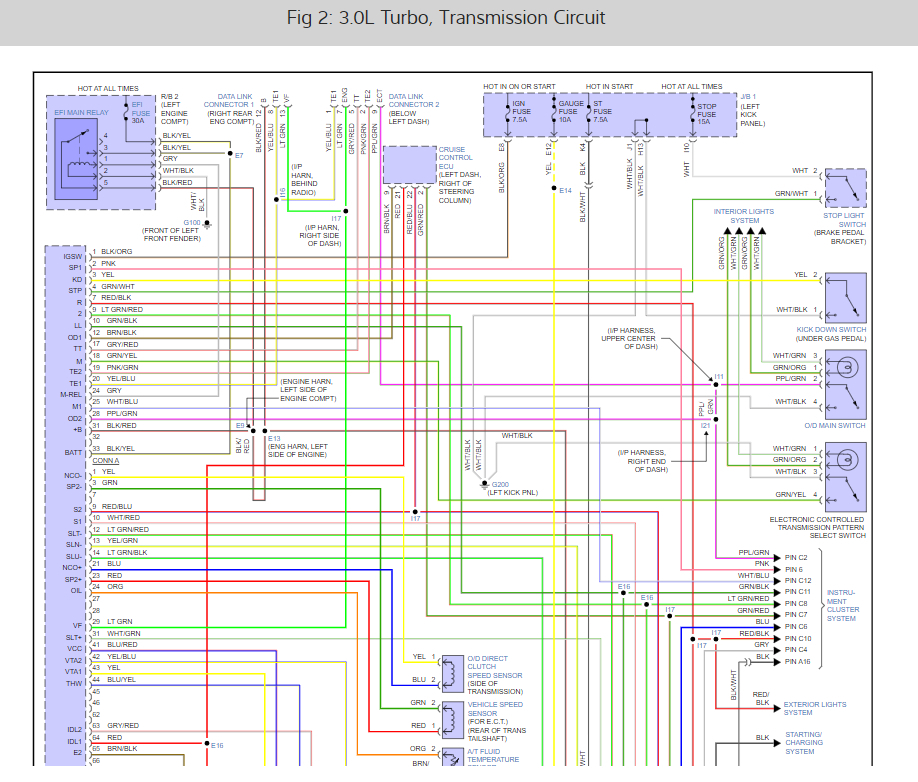

The problem is that i have an engine of 3s-fe ECU but the transmission is 1g-fe a/t. Ecu. I have 2 ECU. One for engine 3s-fe and on for transmission 1g-fe a/t. I need only transmission wiring diagram for 1g-fe a/t ECU.
Oct 5, 2022 at 6:45 AM

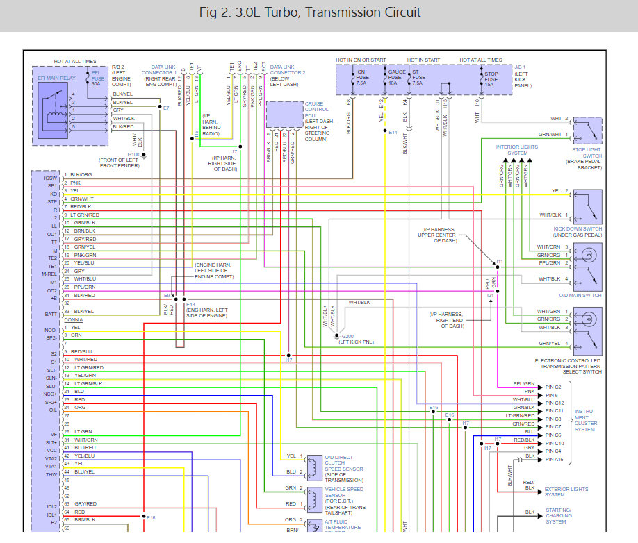

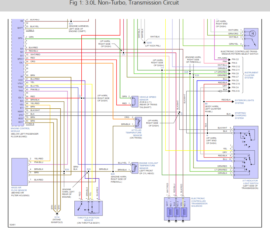

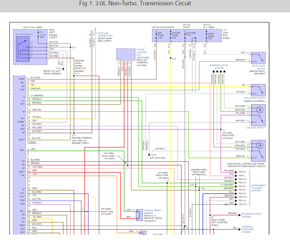

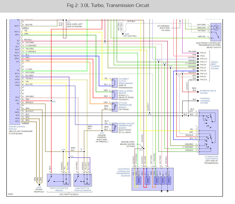

Toyota Supra - 1979–2008 here is the transmission wiring diagrams for a 1995, I hope they work for you.
