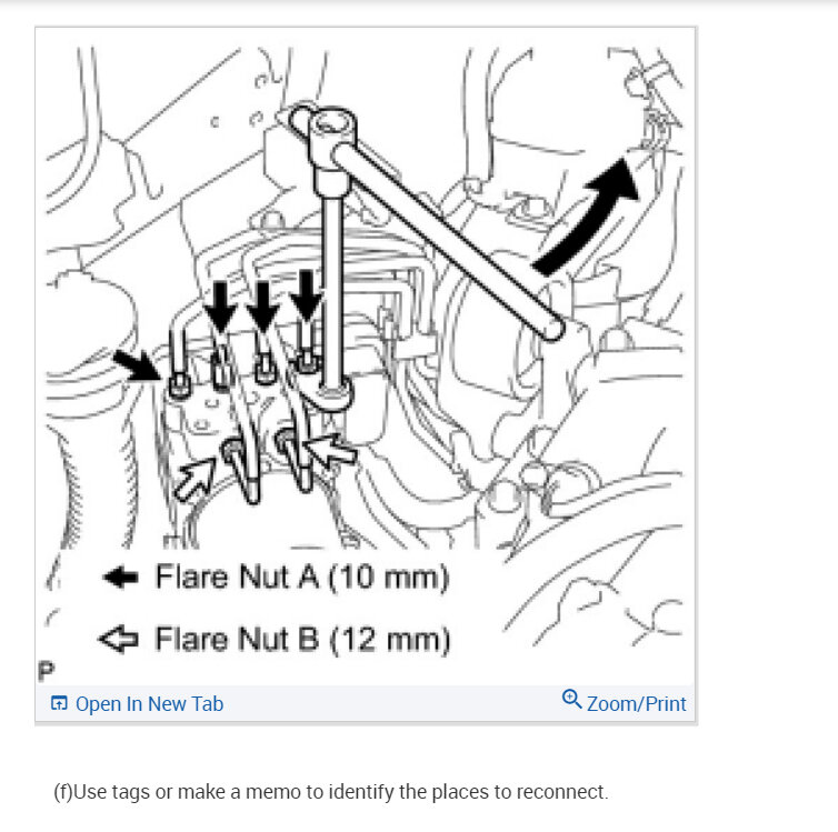

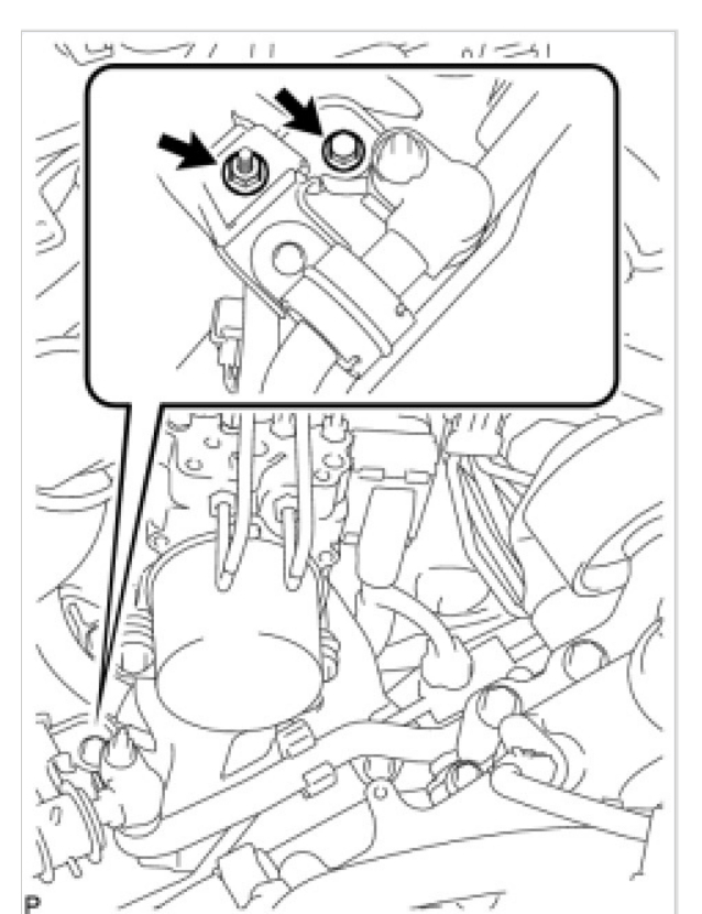

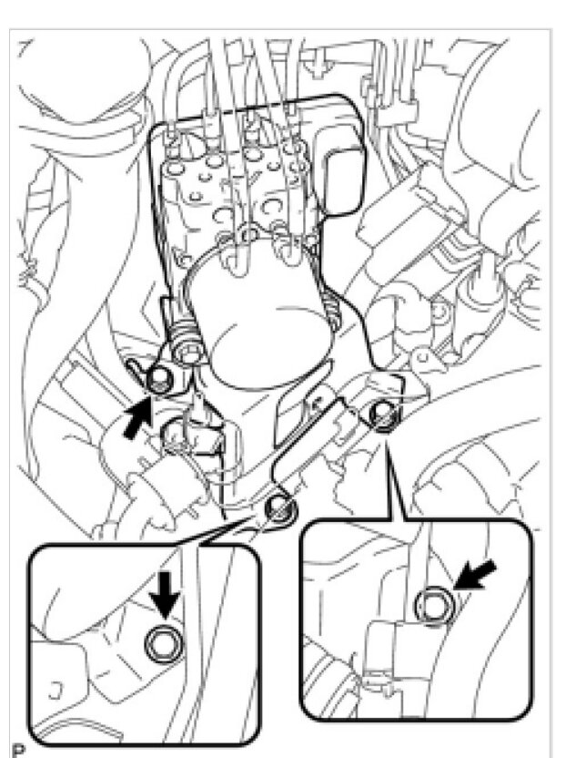

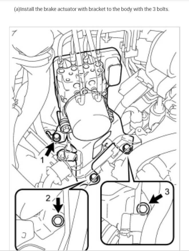

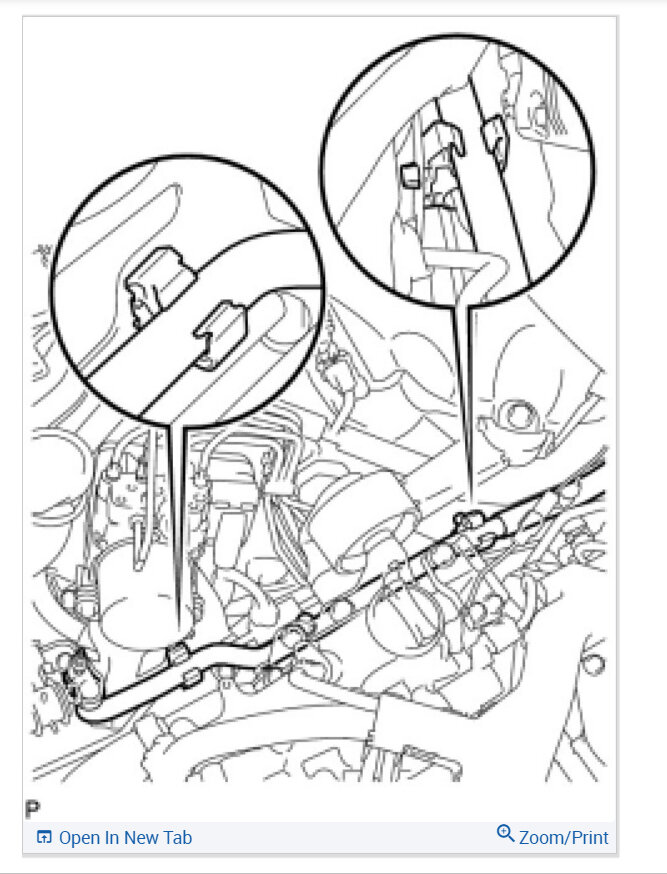

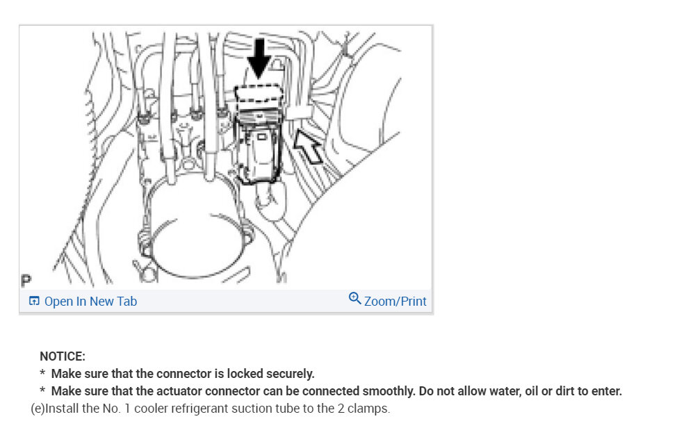

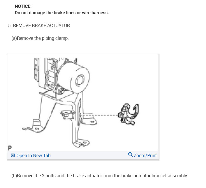

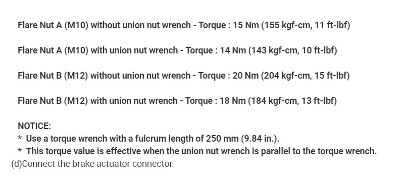

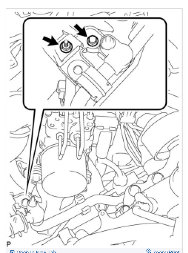

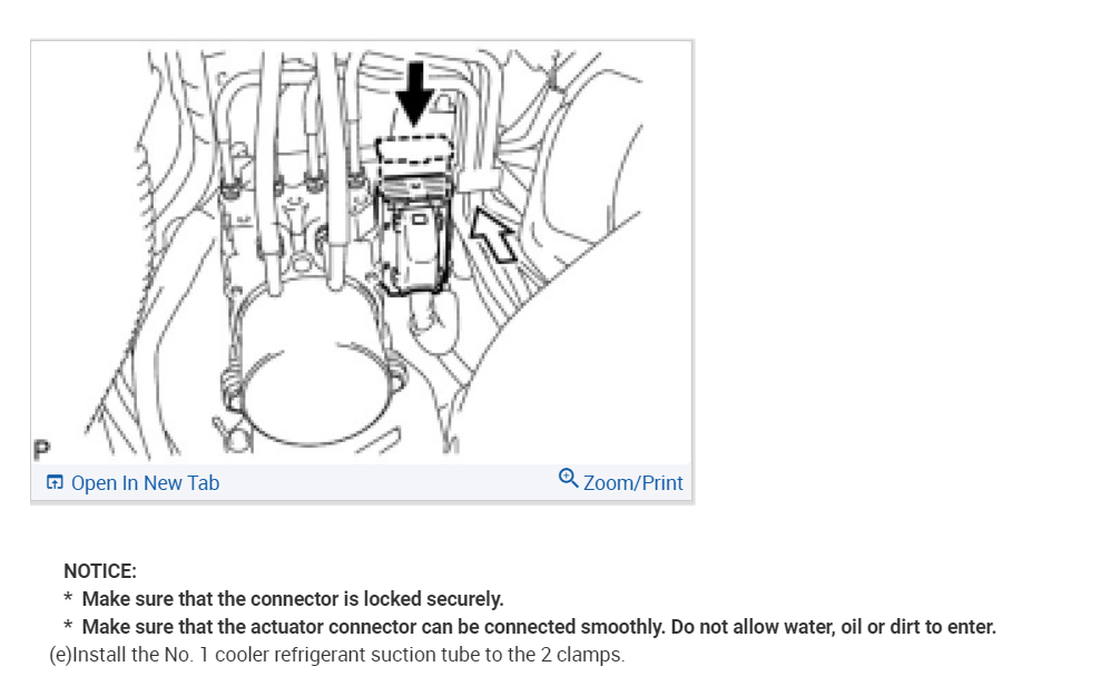

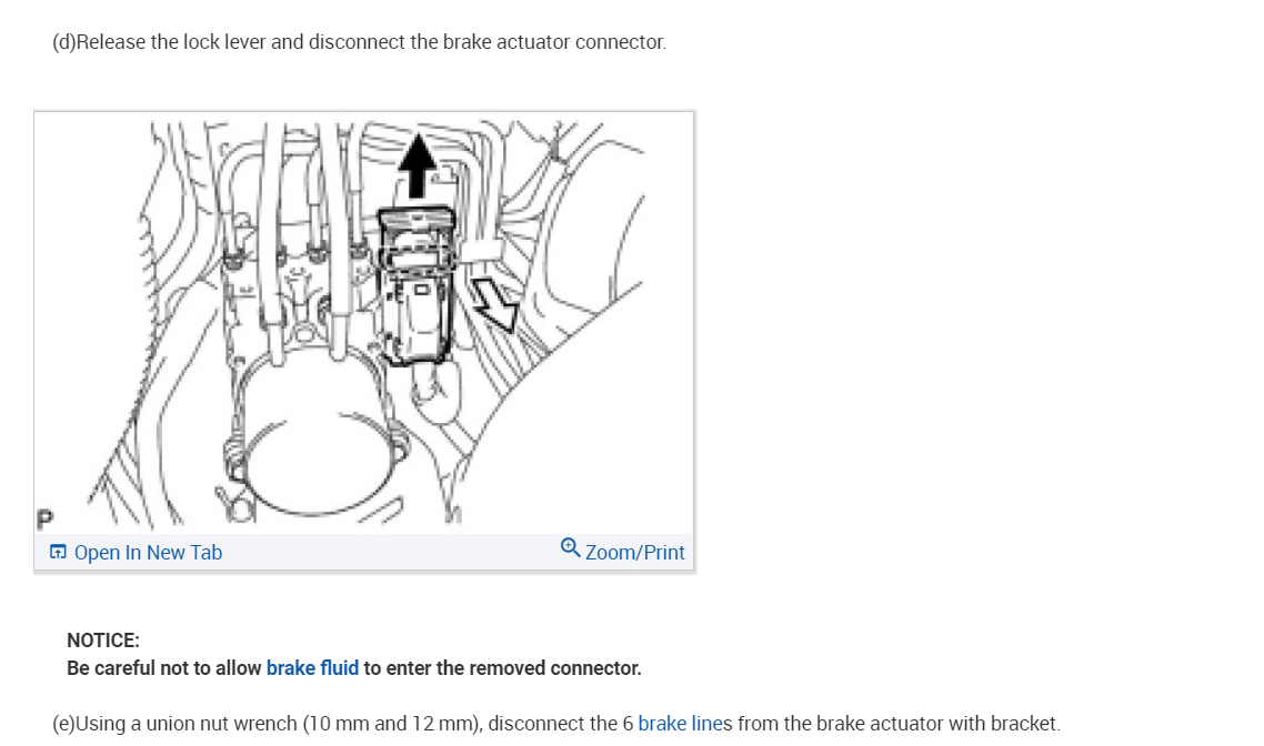

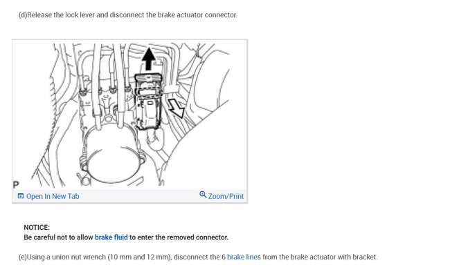

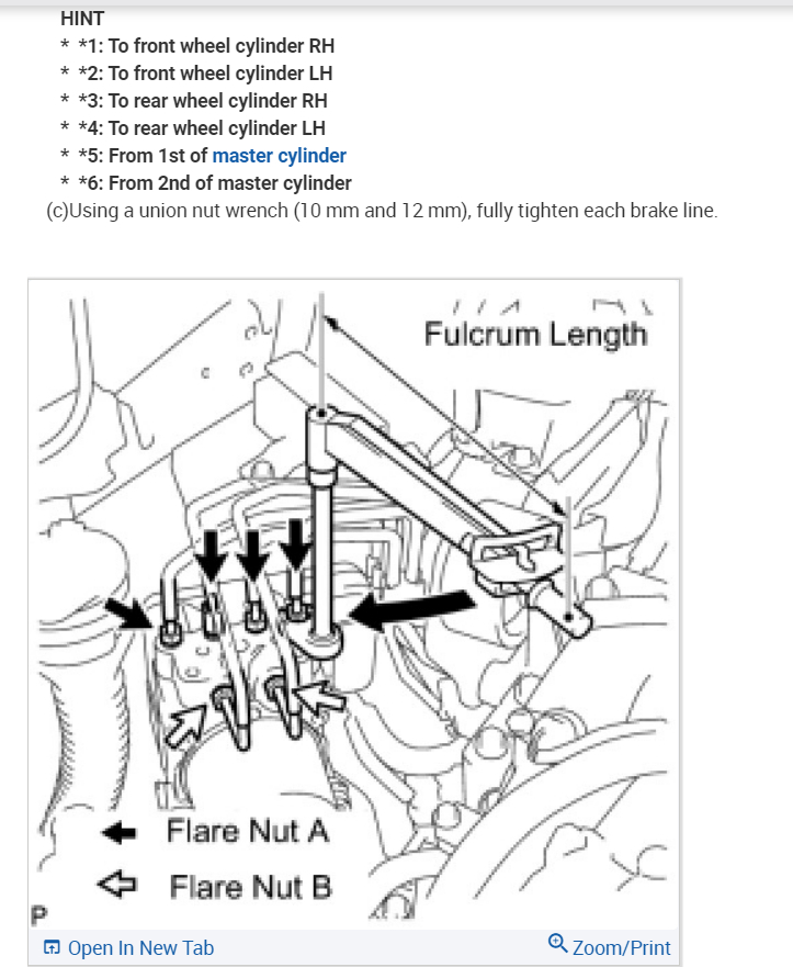

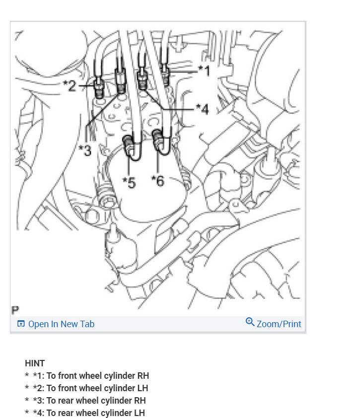

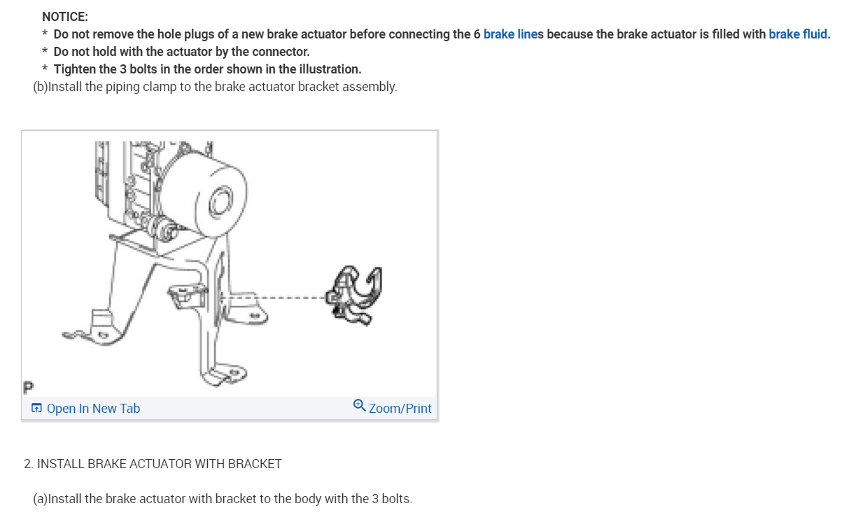

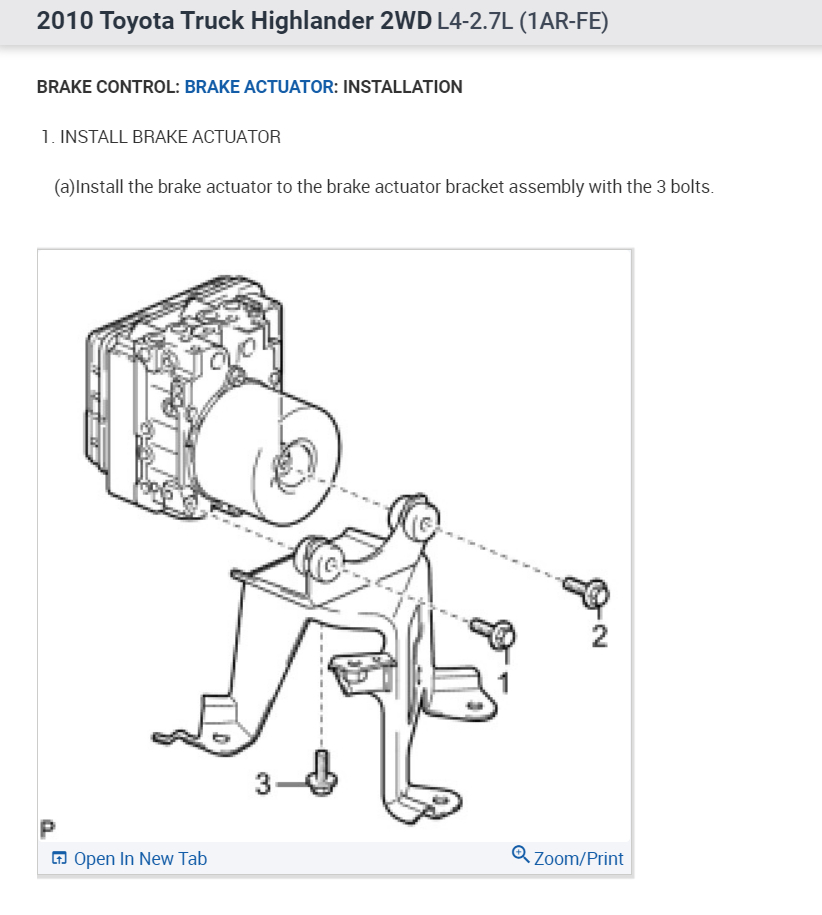

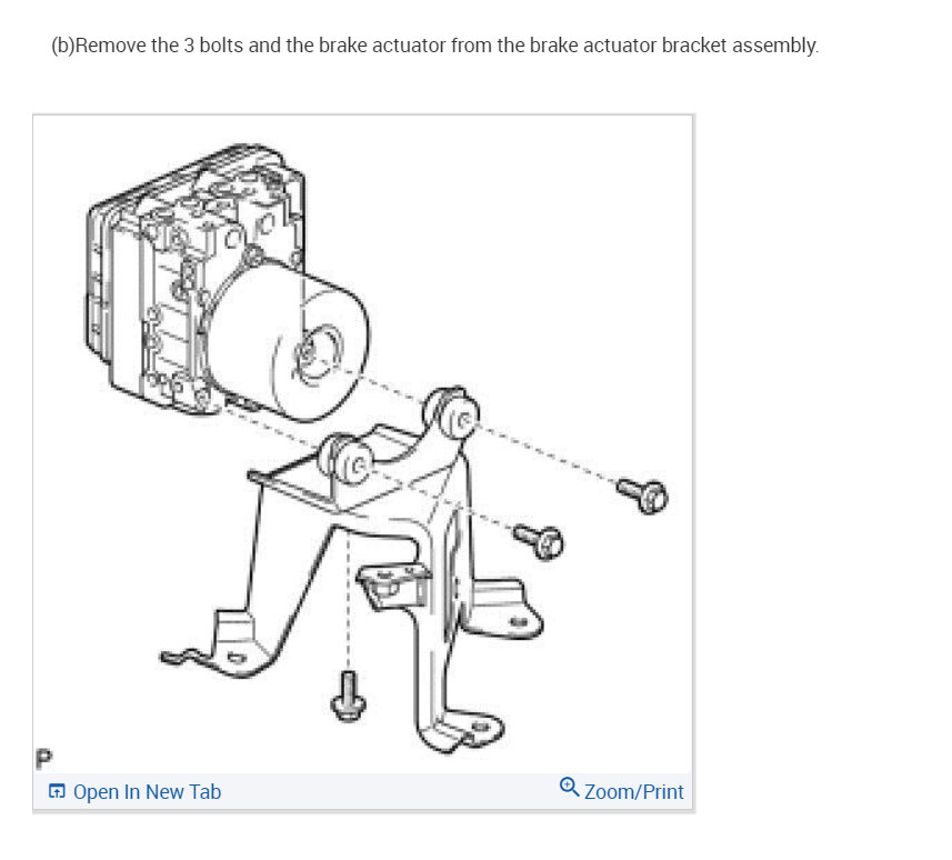

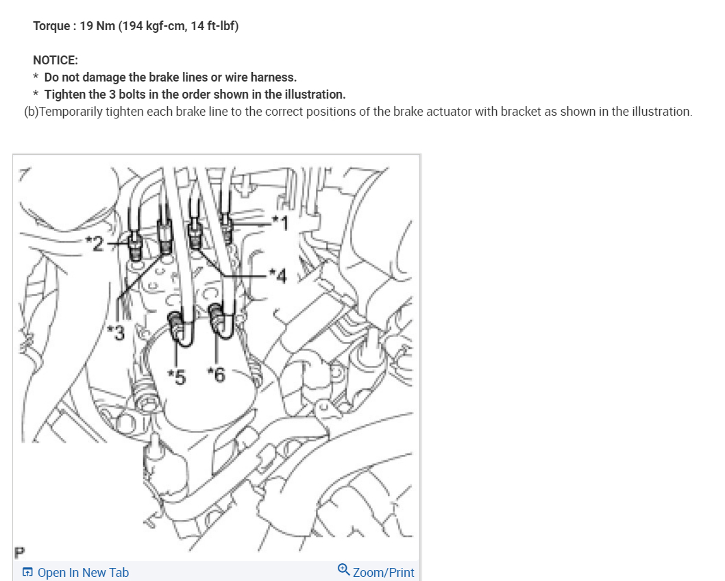

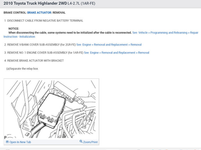

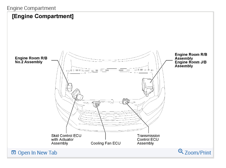

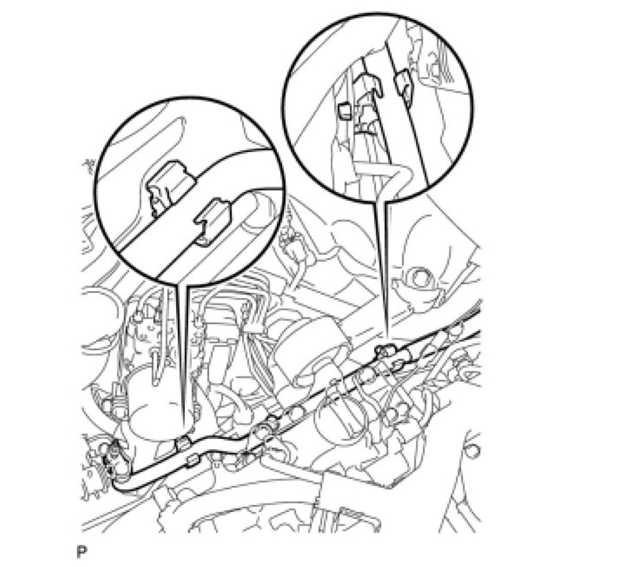

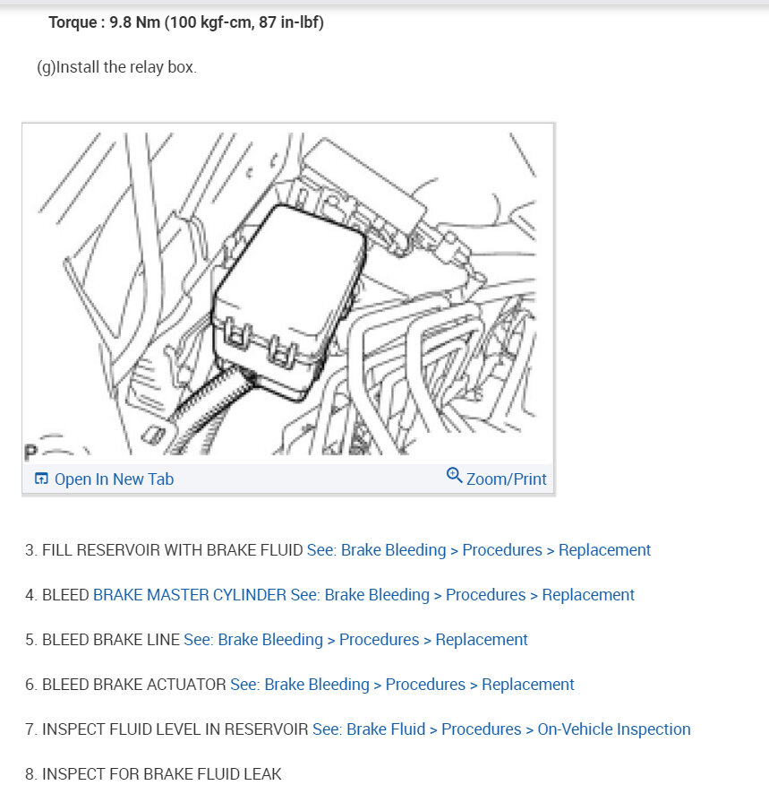

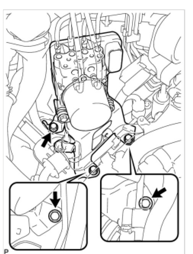

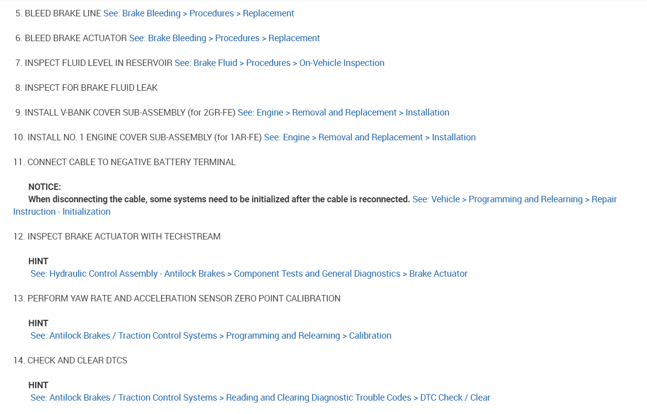

They do call it an ABS ECU as one part did you get charged for the ABS module and ECU separately? If not, you are okay, if so, there might be something wrong here is how to change the ABS module out the images below so you can see for yourself. Check out the images (below). Please let us know if you need anything else.
