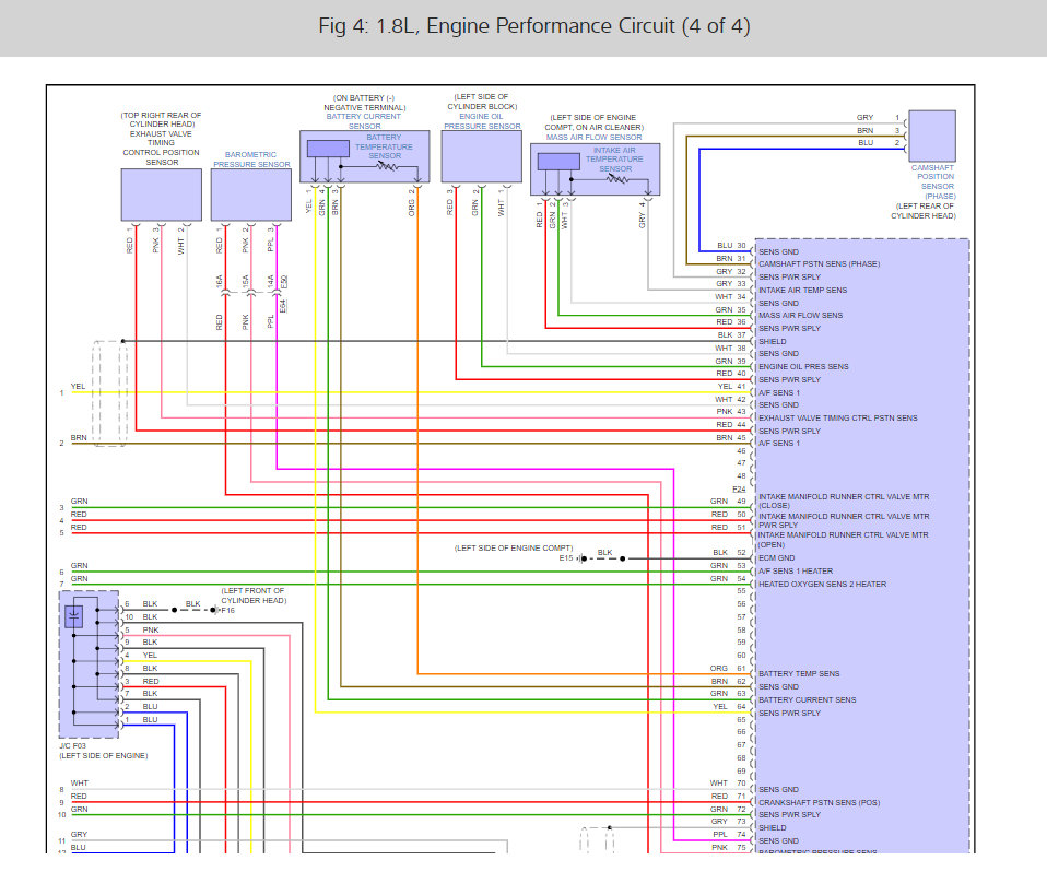

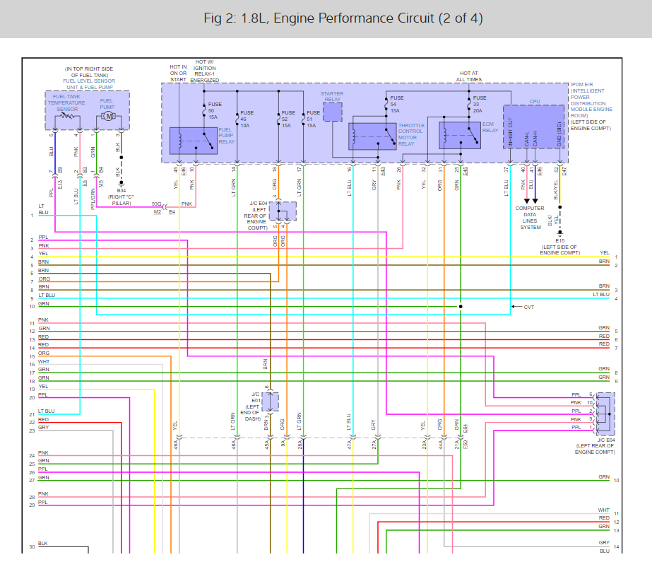

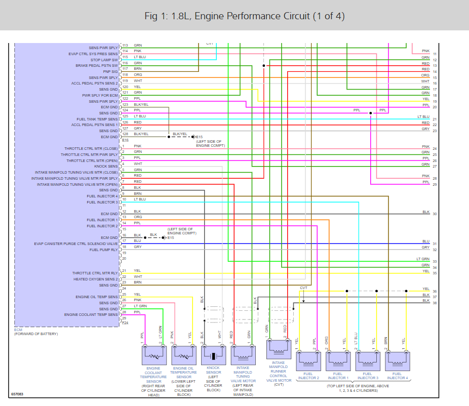

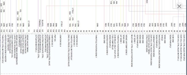

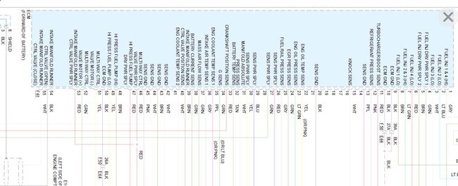

Good evening,
I attached the diagram of the engine control module for you to view.
The wires are labeled for what they control.
Jan 13, 2021 at 5:06 PM

Hey thank you so much for the reply. but, still not seeing what I'm looking for. I'm needing the provided wires so I'm able to tap into the and install my kit. I was told to wire through the ECU not sure if that's where I would find these wires or not. if it isn't if you can please guide be that direction I would be highly appreciative.
Trunk release
Unlock
Lock
Fuel Pump
Hand Brake
Parking brake
Horn Wire

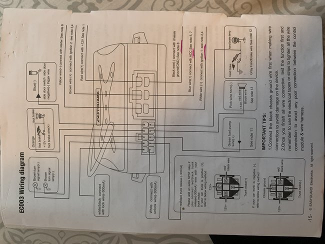

It’s a PKE remote start push to start button.
Jan 14, 2021 at 8:27 PM
Can you take a picture of the instruction sheet for me to see so I can help?
Jan 15, 2021 at 3:20 AM
ROTAVIOUS
  • 7 POSTS
I know everything as far as the wire harness, just lost on the 10 pin.

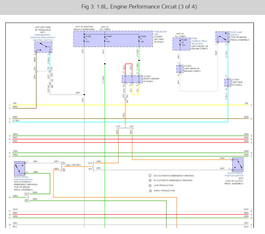

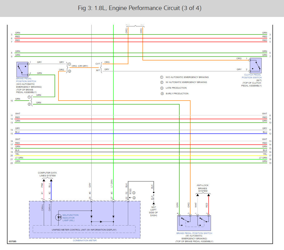

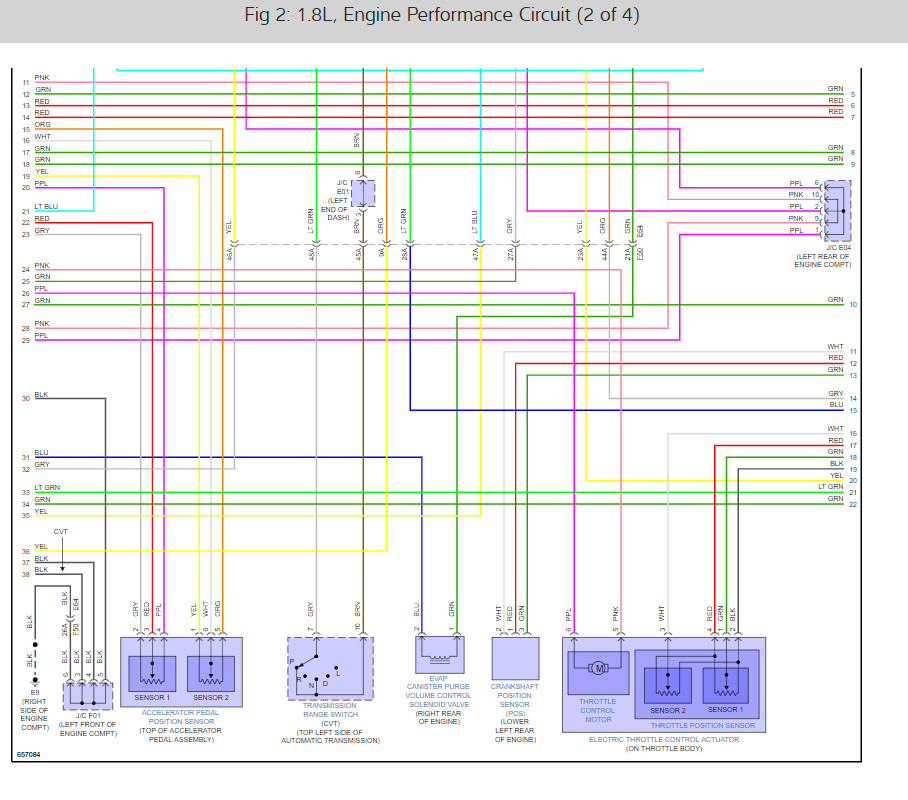

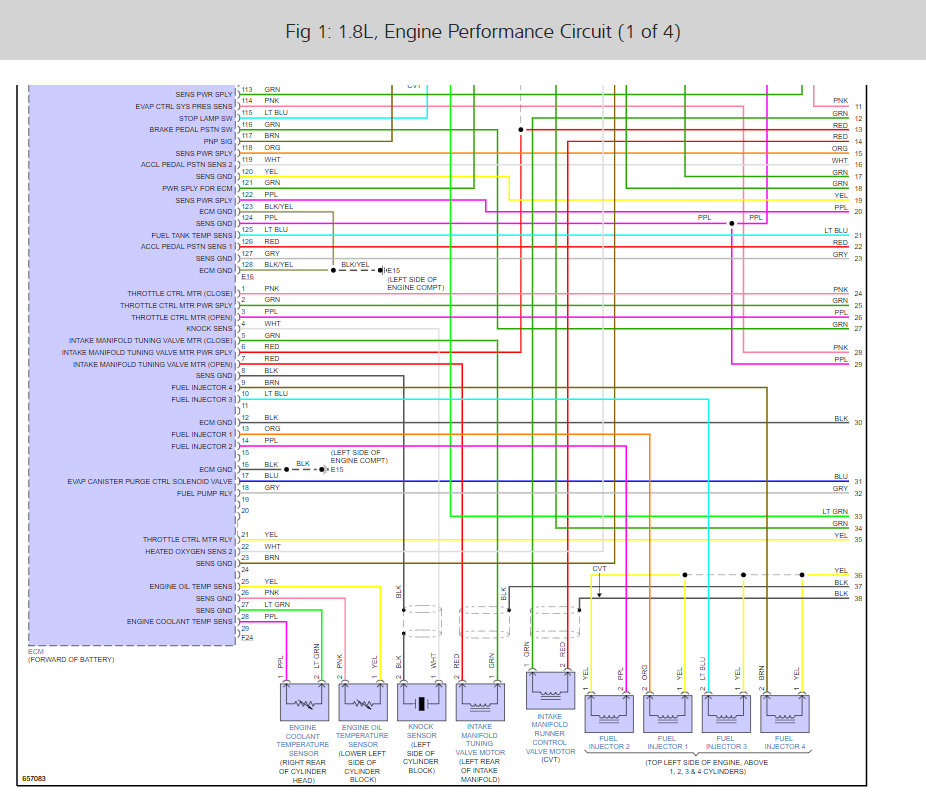

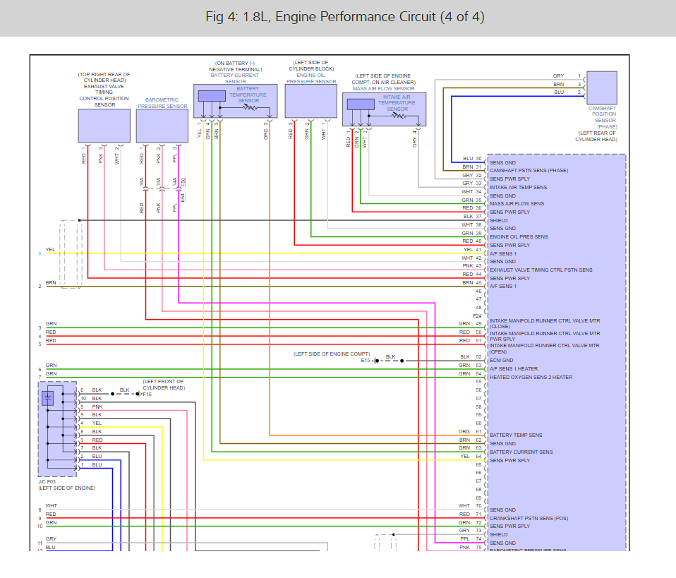

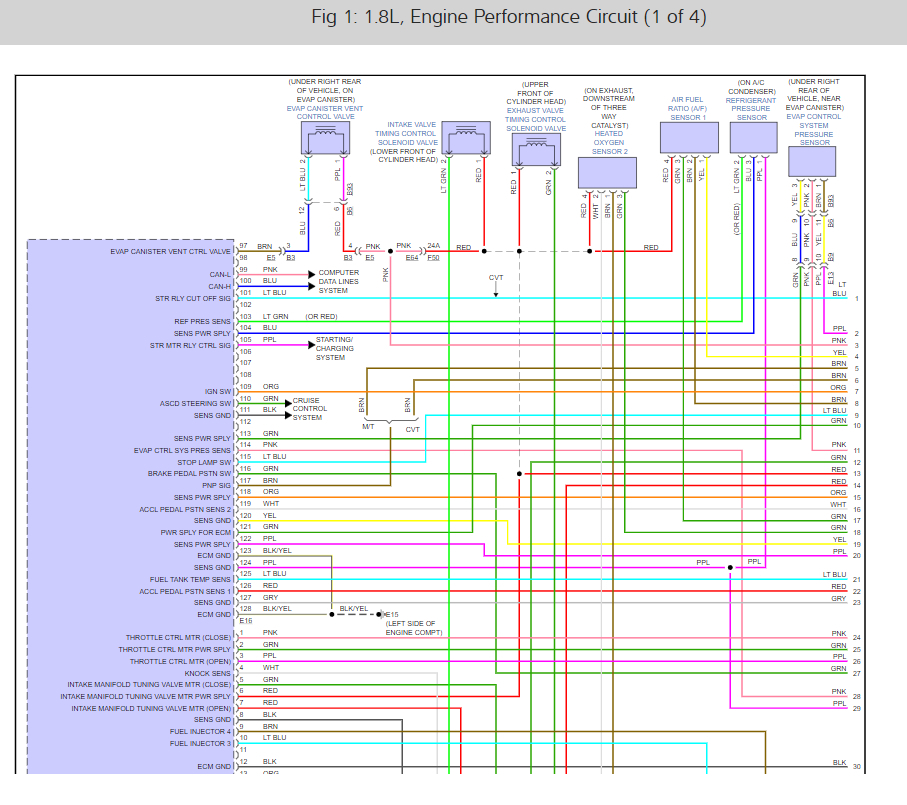

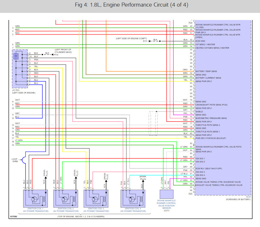

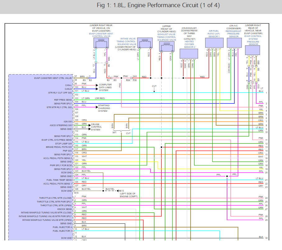

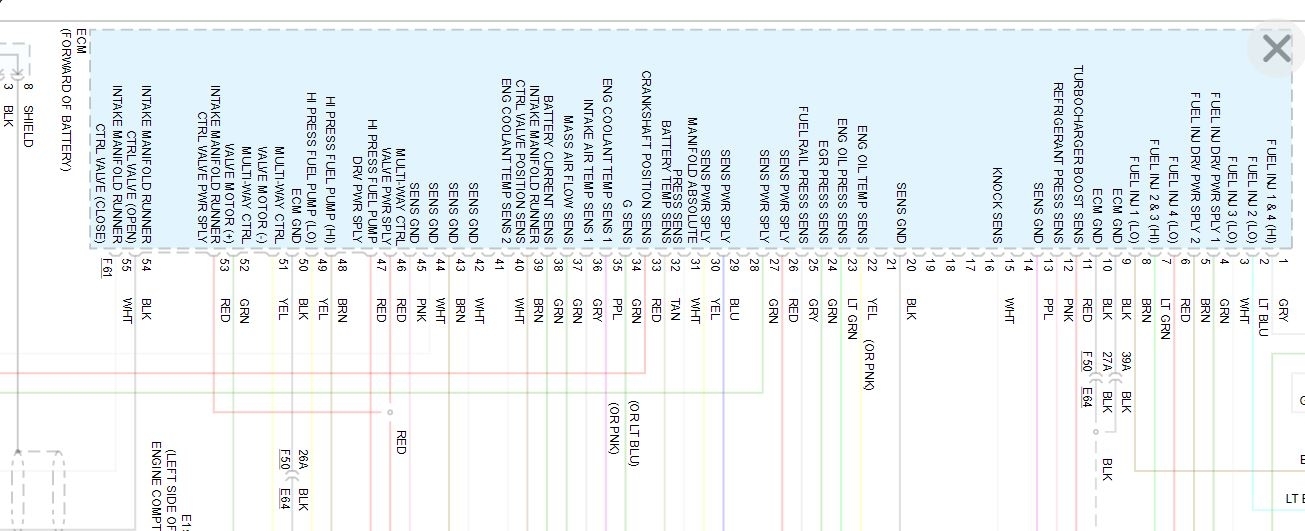

I attached some diagrams for you to review. I hope this helps with your wiring. Here are the engine wiring diagrams. This is not something we can do here online. It needs to be done in person with someone who can read and understand where to connect the wires for you.
Jan 20, 2021 at 4:54 PM
