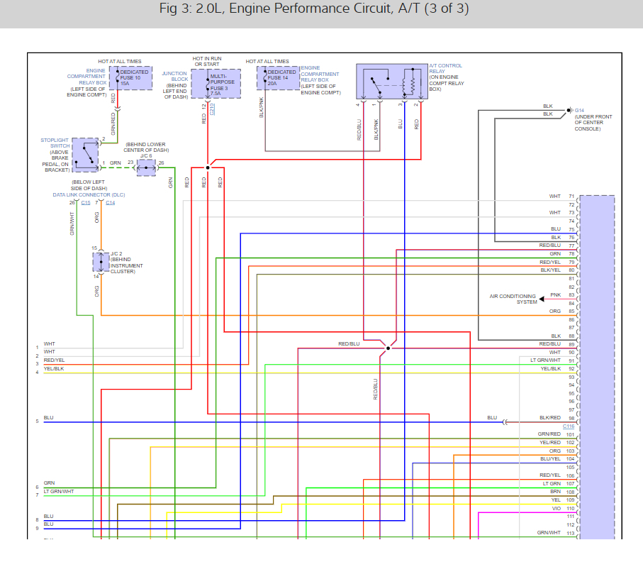

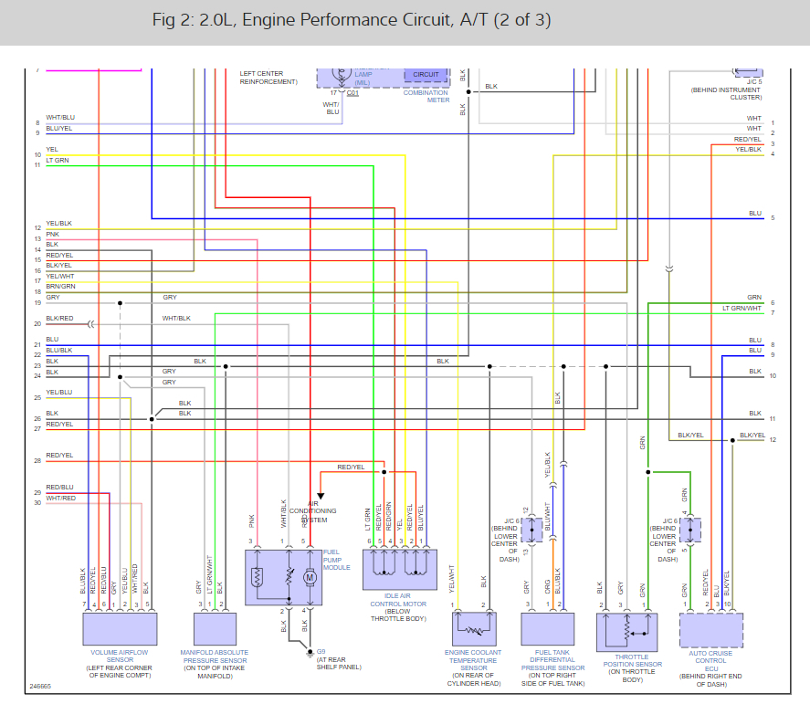

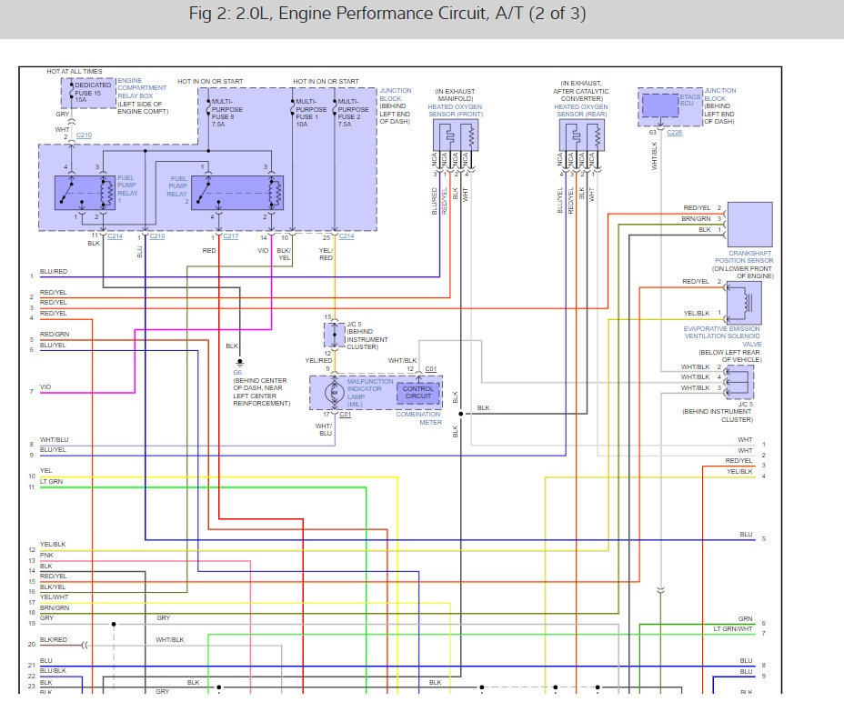

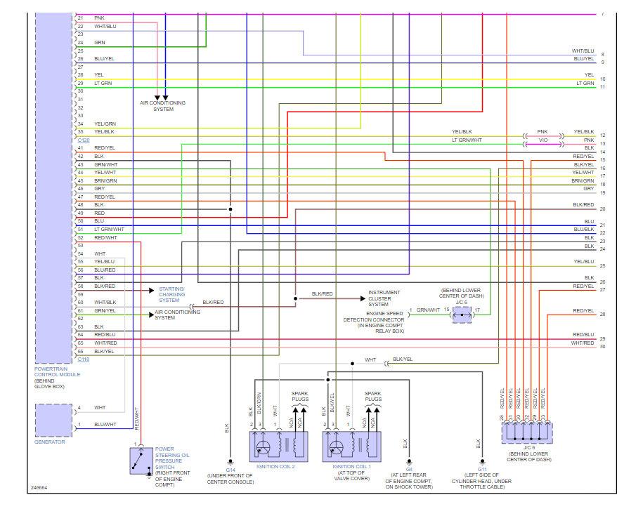

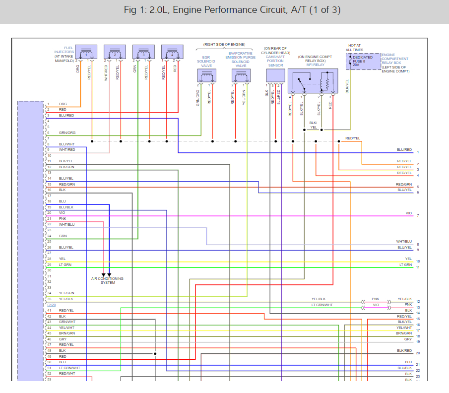

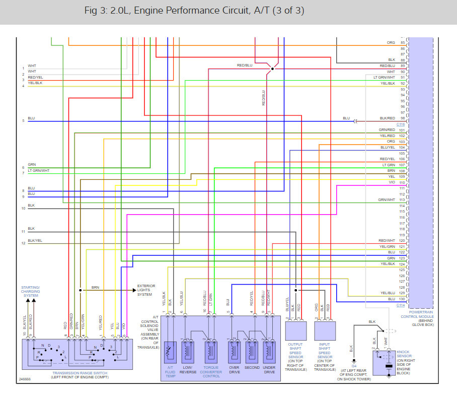

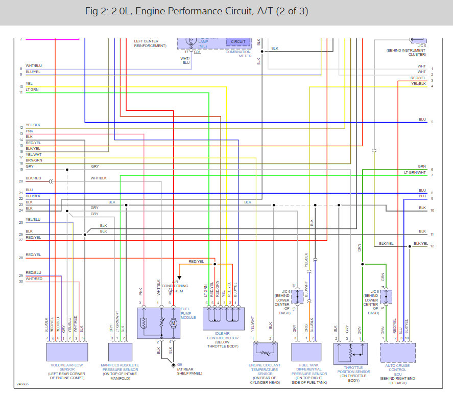

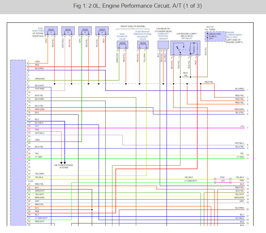

I'm looking for a pinout diagram for my ECU. It has four plugs and not three. I'm only finding pictures for ECU with three plugs.
Jun 1, 2022 at 1:44 PM
CERTIFIED EXPERT
53,854 POSTS
Here are the engine wiring diagrams for the 2.0 liter with an auto transmission with a guide to help you test the wiring.
Check out the diagrams (below). Please let us know if you need anything else to get the problem fixed.
